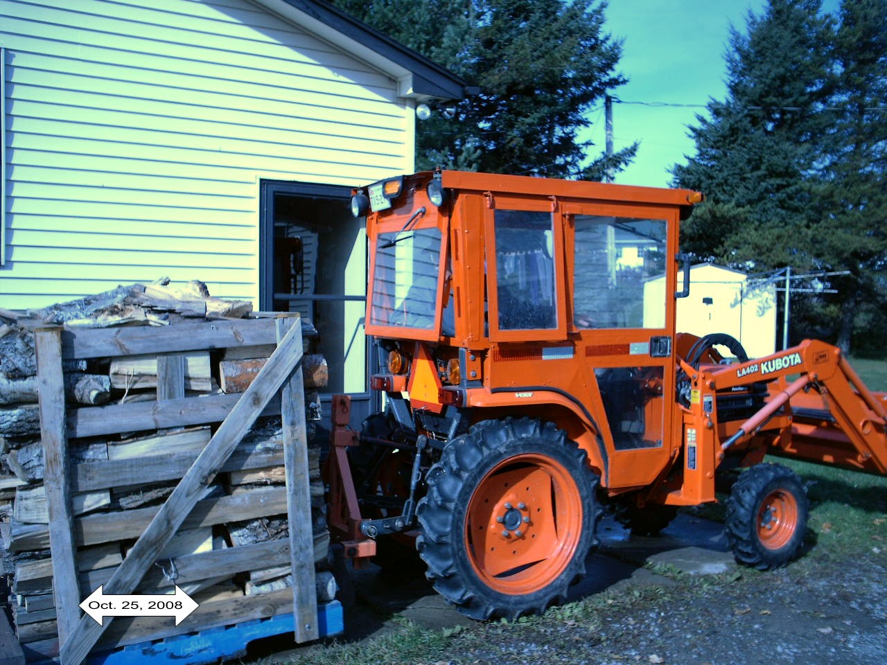

My B7800 will just barely lift a standard pallet with 3 tiers of dry mixed hard/softwood stacked 4' high (the maximum lift is shown in the photo), but it has no problem with 2 tiers on the same pallets. That's just too much weight cantilevered too far out from the lift point.
