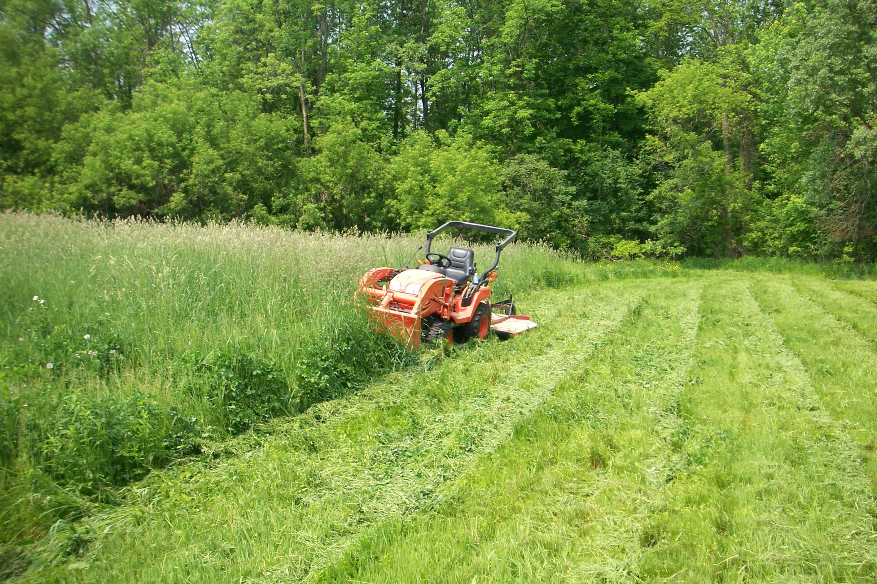

1. Cutting your field w/ a 60" rotary cutter. If, as you say, you will only be cutting 2' field grass monthly on a smooth field, get a quality light duty rotary cutter and it will work perfect. I cut my field w/ a 5' Bush-Hog RazorBack and my BX24. My field is smooth and I cut grass/weeds 2-3 times per year. It is usually 4-5 feet tall and I take full swaths at 3-4mph with no bog of the engine. Attached is a pic for the non-believers.

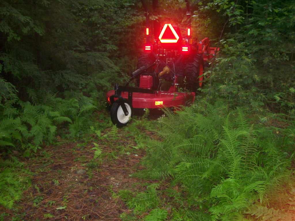

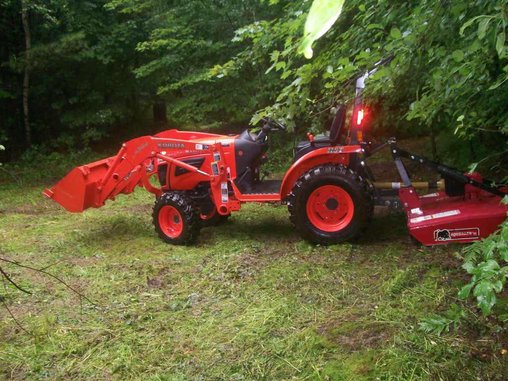

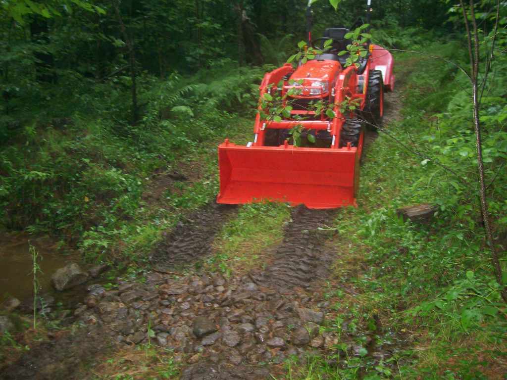

The 4' cutter just about covers my wheel tracks, and there is no noticable packed grass, or anything. I find in brush, etc. that it works well too. A 54" cutter would be good too. The dealer that I bought mine from installed the lower mounting pins on the RC a bit lower ( Bush Hog Squealer) to give me a bit more lift I guess. Still, with the loader off it is a good balance for the tractor, and I would want to leave the loader on for anything larger for sure. I have mowed a couple of small steep areas, and it has worked well there too.
I don't have very good pictures of it in use, but you can get an idea from these I took while working on my trails.
