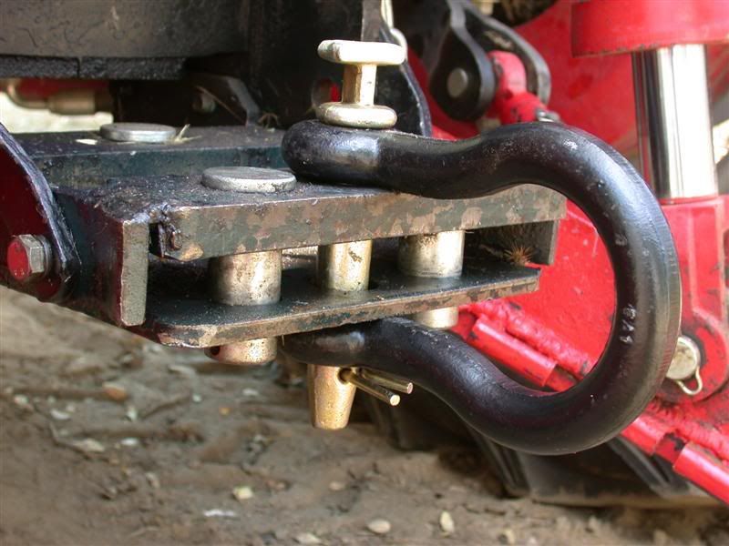

Eric, Get the biggest clevis that will fit your belly mounted drawbar and weld a 3/8" chain hook on top with the slot at about 45 degree angle. That's what I use. You can use 1/4 to 3/8" chain on it.
   / Attaching chain to draw bar #16
I bought a large clevis or anchor shackle for the belly draw bar plate.
My wife's Jinma came with 2 grab hooks welded to the belly plate. I thought that was pretty cool. You can see them just below the PTO shaft. So she can leave the belly draw bar installed if she wants to. That might give you some options for what you want to do.
   / Attaching chain to draw bar #17
The anchor shackle has a pin that screws in place while the normal clevis has a hitch pin run through the hole and in turned pinned with a lynch pin or hairpin clip. I don't see any advantage of one over the other, but have both. There are also twisted clevis's out there which rotate the attachment parts 90 degrees from one another.
The two most important advantages to me is the anchor shackle will stand more stress because the ends are held firmly in place by the threaded pin and there is little to no chance of the threaded pin coming undone versus a clipped slide in pin. The anchor shackle is lots safer, stronger and just as easy to use.
   / Attaching chain to draw bar #20
I have seen those but the pin may be too big for Eric's application. He was having trouble with the hole size in the drawbar.
