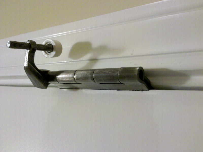

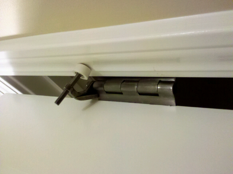

#2,406
The doors got hung. I don't think I like these door hinge stops. I've always seen stops that have 2 stoppers. These things look to me like they will try to bend then hinges if then doors is opened too forcefully. Does anyone have anyone experience with stops like these? Are they ok?
Thanks,
Obed

   / At Home In The Woods #2,407
Best door stops are not on the hinges at all, IMHO. The type that you screw into the baseboard or floor are much sturdier and last a lot longer. I only use hinge mounted stops when there is no other choice, usually due to there being no good place to put a baseboard style stop or a floor mounted stop would be in the way.
One man's opinion...

   / At Home In The Woods #2,409
Thanks,
Obed
We have had those stops and didn't like them at all. They are ok for a while but they all broke and damaged the doors. It may just be the ones I had are cheap. Don't know.. I had them on heavy exterior doors so on a light door they may work fine.
They were ok for normal use but if the wind was to catch a door they would bend and break. I replaced them with a magnetic stop/holder type. These worked great to hold the door in an open position as well.

I really do not care for any hinge stops, but sometimes they are a necessary evil. I've found that if they just have to be used, they perform better with one on the top hinge and one on the bottom. This helps distribute the weight and does less damage to the door. I would want rubber bumpers on anything that makes contact.
