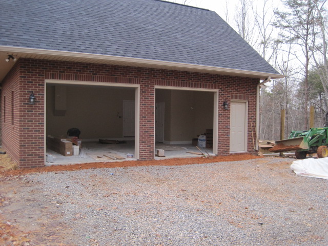

In addition, my wife asked the building commisisoner if we had to have garage doors installed for the OC and he said yes. I can't see why garage doors have to be installed. What if we didn't want garage doors at all? So what? How is that a safety issue or anything else that matters? We just found out that our 10 foot wide garage door will have to be ordered; it's not in stock locally so we may have a delay getting the OC because of it.

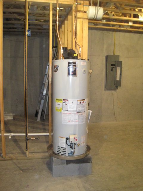

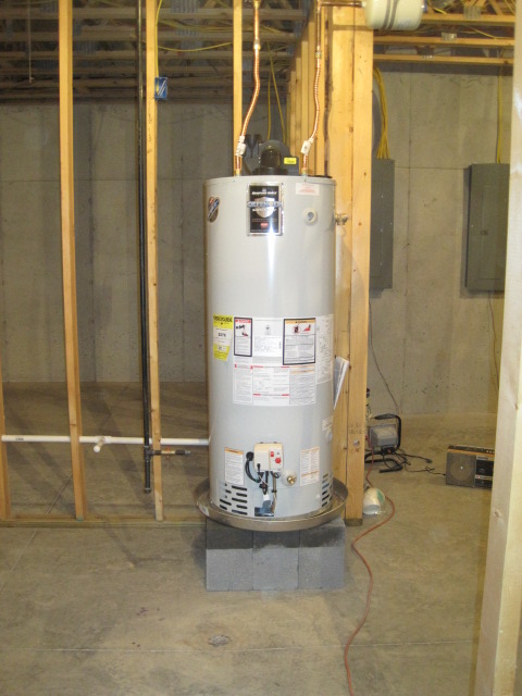

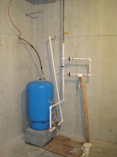

Thanks all for the great comments regarding the hot water heater and the filters. We bought a sediment filter today.
We will put a pan under the hot water heater. We have a floor drain near the hot water heater. Unfortunately, the original construction manager did not tell the concrete guys to slope the floor toward the drain :mad: even though we told him to slope it and even though it was on the plans. Fortunately, my wife caught the problem before the concrete was poured around the second floor drain near the basement bathroom/laundry and got the floor sloped there. We may run a flexible water hose from the pan over to the drain in the utility room. The downside is the hose will have to snake about 4 feet across the walking space to reach the drain.
We weren't sure what kind of water sediment filter we wanted. We haven't done any research so we got a cheap one from the big box store. We may replace the sediment filter sometime later with something better if it appears this one isn't good enough. We had the plumber put in some ball valves so we can replace or bypass the the filter if needed. The filter's plumbing lines are temporarilly propped up with a board. We will add some framing to support the filter.
We moved the water heater about six inches to the left after it was installed by the plumber. We wanted the water heater to be closer to the gas line shown to the left of the water heater. It turns out that the proximity of the floor drain to the water heater is not as bad as I thought. You can see the floor drain about a foot in front of the water heater. I can just run a plastic drain hose from the water heater pan to the floor drain without the hose getting too much in the walkspace.

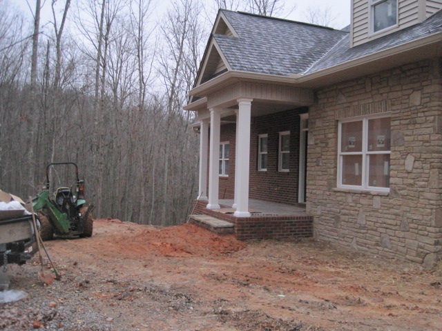

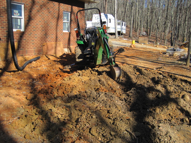

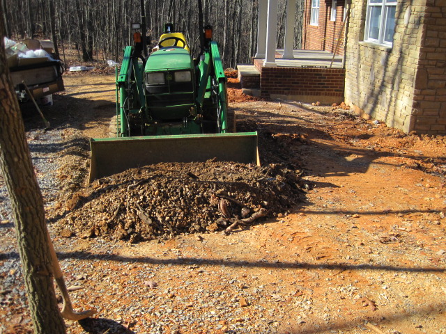

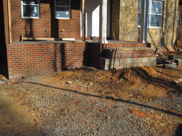

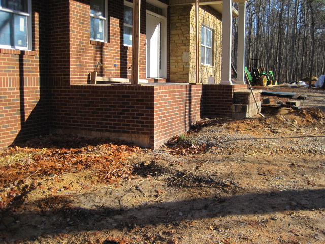

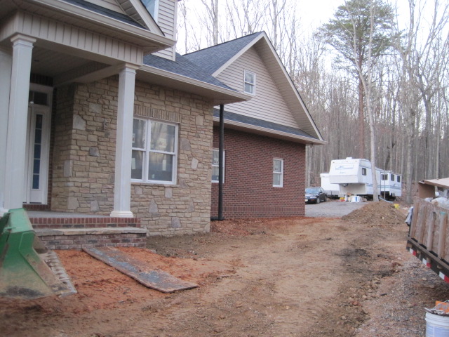

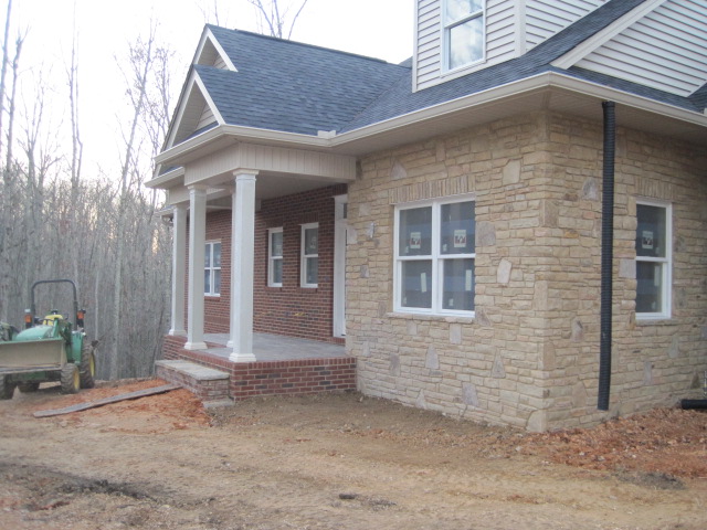

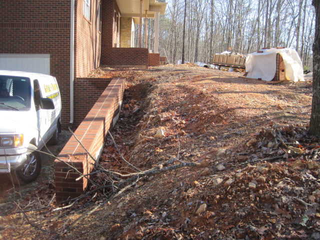

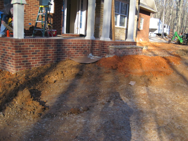

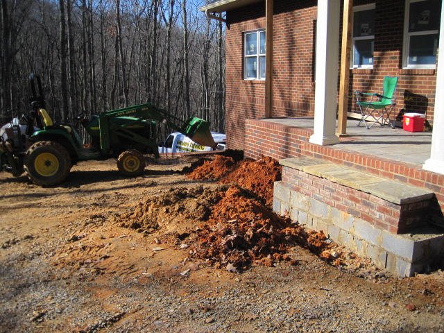

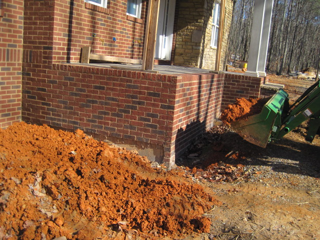

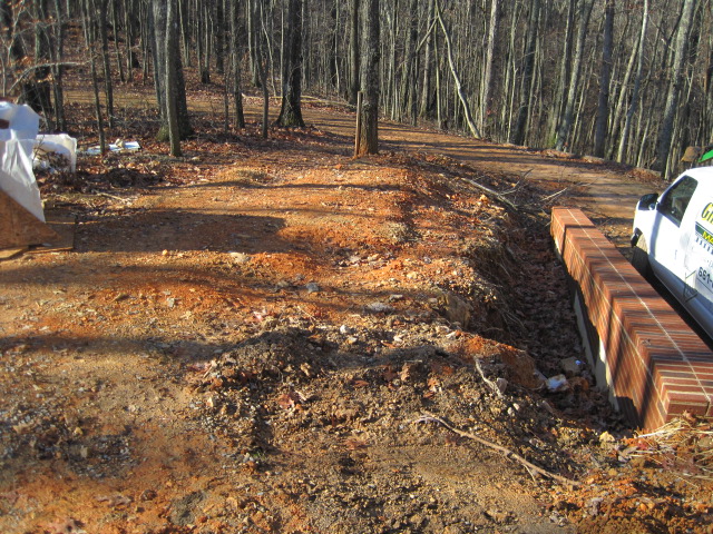

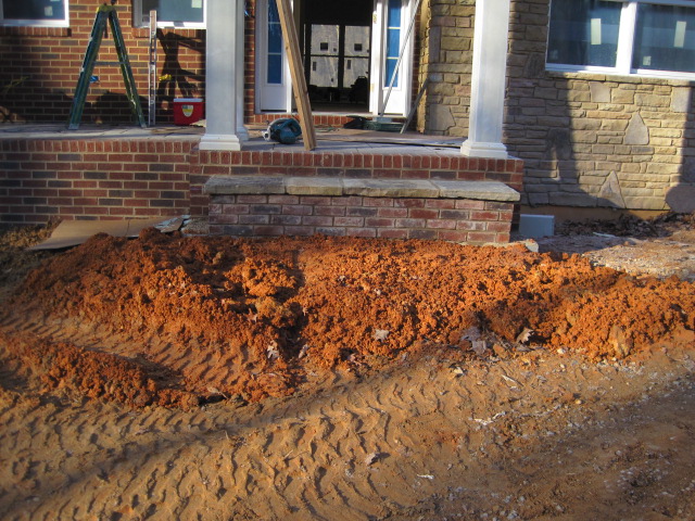

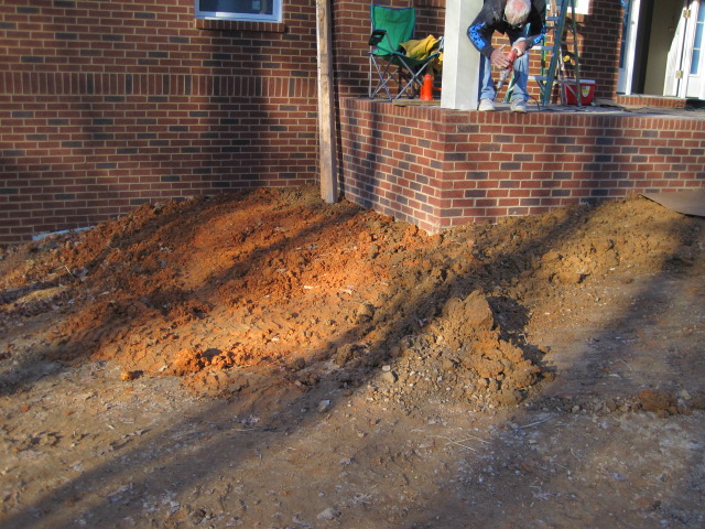

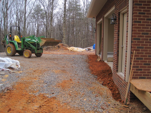

I've been doing some backfilling and minimal grading to try to be ready for the Occupancy Permit inspection. The gradework is by no means where I want it. However, I'm just trying to get the grade to slope some away from the house so the county will let us move in.
I probably won't have the retaining wall backfilled before the OP inspection. I hope they will let us slide on that. I need to have the tree to the left of the retaining wall removed so that I can lower the grade that runs along the retaining wall.
I dumped a few loads of dirt in front of the porch steps and packed it down with the tractor tires. Obviously this isn't the final grading but I hope it will get me past the inspection. I also dumped enough dirt at the high end of the front porch to try to get the grade within 30" of the porch so that porch railing is not required.
I had to use the backhoe to break up some hard ground that the FEL wouldn't cut through.

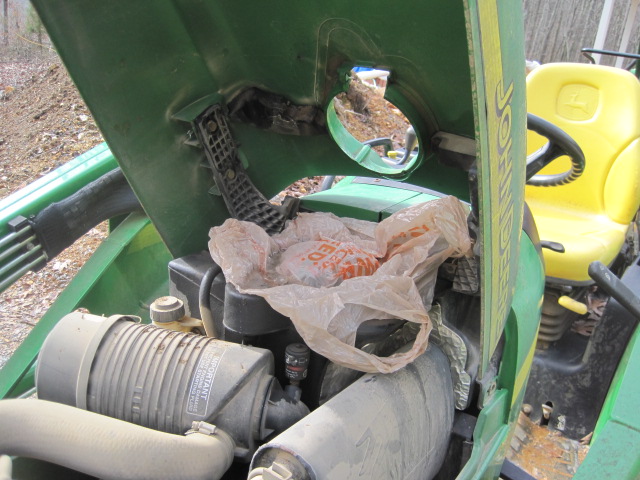

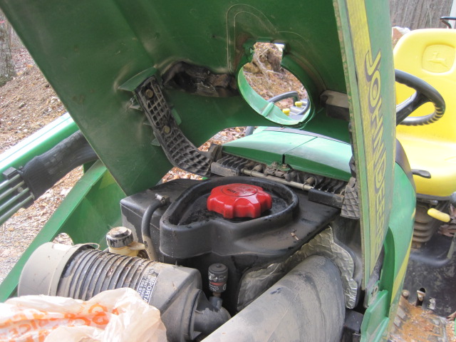

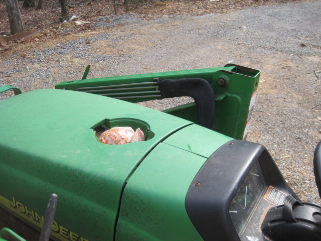

Before I did the backfilling around the front of the house, I tried to fill up the tractor with diesel. It was below freezing that morning and I couldn't unscrew the fuel cap from the tractor. Water had collected around the cap and frozen. I chipped off the ice and was able to fuel up the tractor. There went 45 minutes I hadn't foreseen. Unfortunately, when I lifted the plastic cover that covers the fuel cap, it broke off because of the frozen water. I have covered the fuel cap with a plastic bag to keep water and debris from collecting around the fuel cap.
There is a drain hose for draining liquids from around the fuel cap. It must have stopped up.

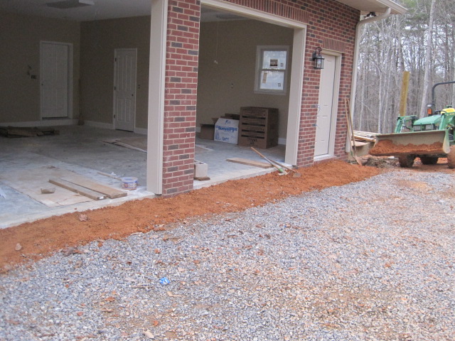

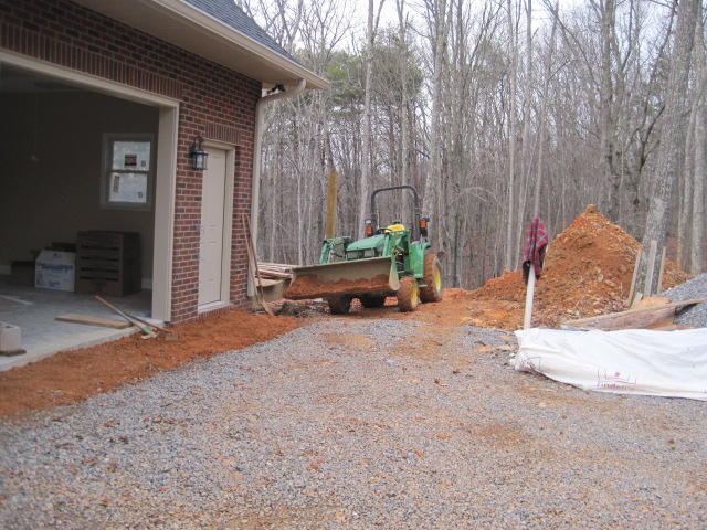

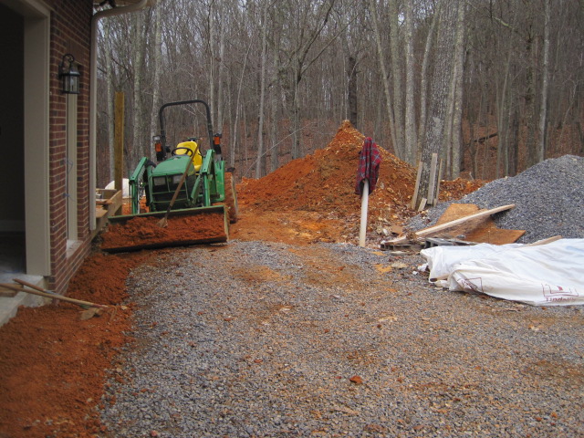

This past weekend I backfilled at the garage doors. As you can tell, we have plenty of dirt available for backfilling and grading.

Missing Garage door? Heck no, that's a wall. Frame it in temporarily and cover with cheapo masonite siding. Or block it over with plywood if they'll let you. You can do a a few tricks to get past a missing detail or two. Push it too far, and the inspector might push back... But if all that is standing in the way is the one garage door, then find a way around it
. That's what we did for the basement garage so we didn't have to finish it at this point.
You gotta love these new modern plastic tractors. NOT.
That sucks. The plasic parts aren't any cheaper in price either.:(
Obed,
Where we live in NW Georgia we have a lot of sediment in our water. For several years we used a sediment filter with pretty large cartridges. I finally got tired of changing them and we had a self back flushing sediment filter in. It is maintenance free and it does a great job. It basically uses a water softener tank and head but instead of the resin beads it has several layers of decreasing size aggregate in it. It back flushes about 80 to 100 gallons every 4th day. If you go that route I suggest you do not flush it through the septic.
