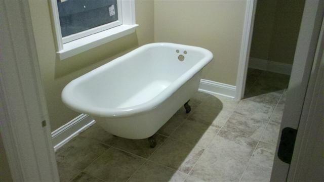

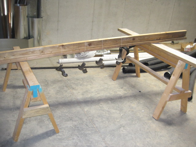

My wife re-painted the feet for the claw-foot tub to match the color of the door knobs.
   / At Home In The Woods #2,368
You did good on that tub deal. Your wife did good on the feet. nice.
   / At Home In The Woods #2,369
I would probably never notice such a thing, but a woman who paints her toenails to match her outfit would surely see the unmatched feet first thing.;)
