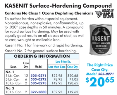

Hard surface rod on wear areas as Egon suggests is a good way. I have case hardened things using a product called Kasenit.
If this isn't the way to go on this project keep it in mind for when you need surface hardness to reduce wear but you still need the properties of flexibility etc of the original material. Trying to temper the whole piece may embrittle it. Surface rod and case hardening are a couple good ways to leave the base material relatively unchanged but get a good hard surface.
Pat
