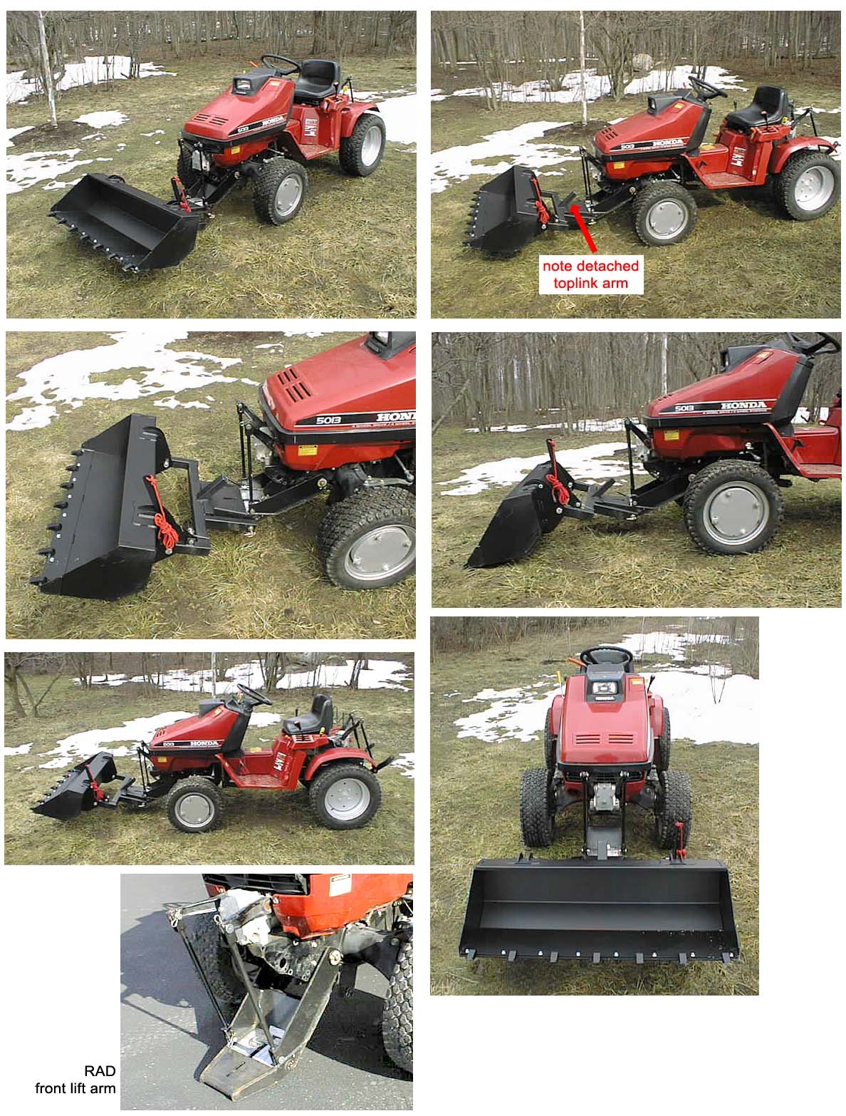

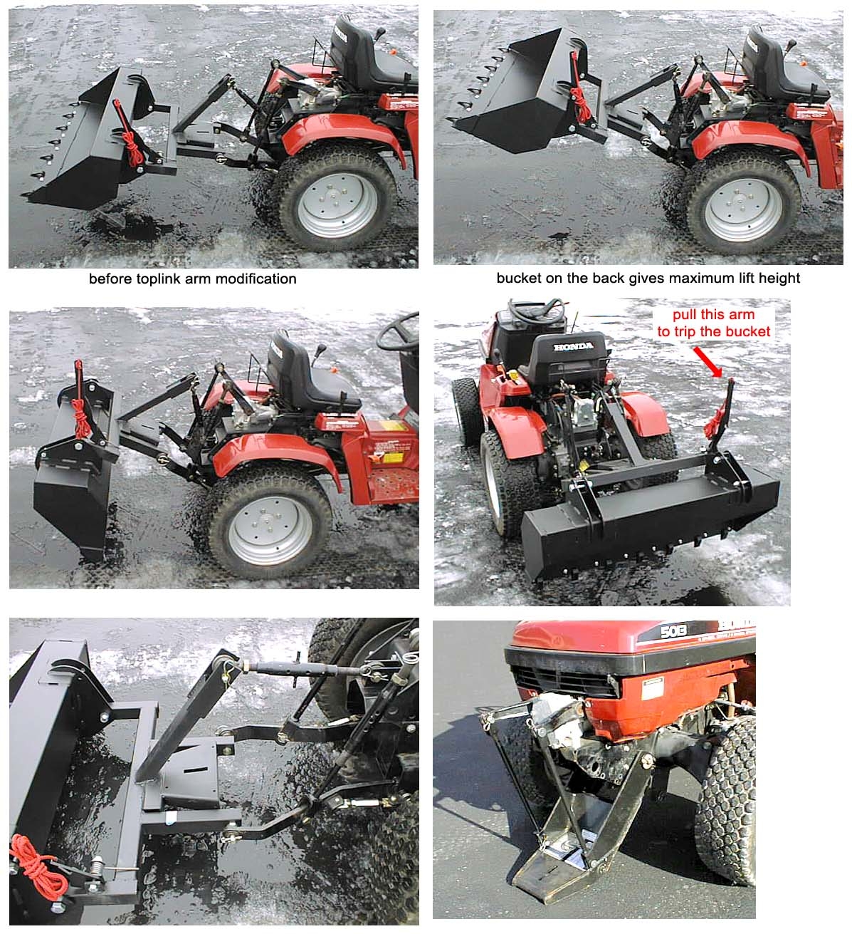

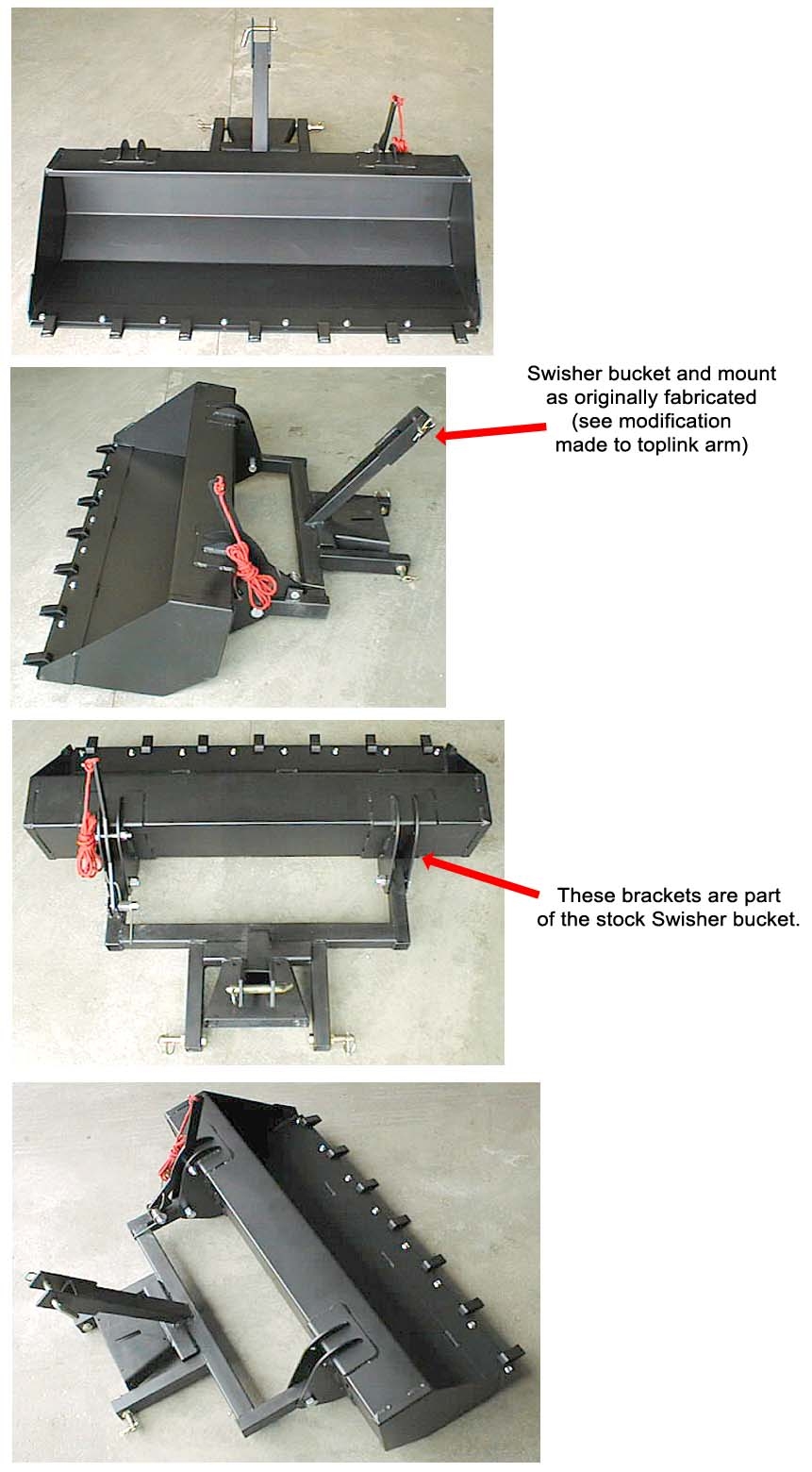

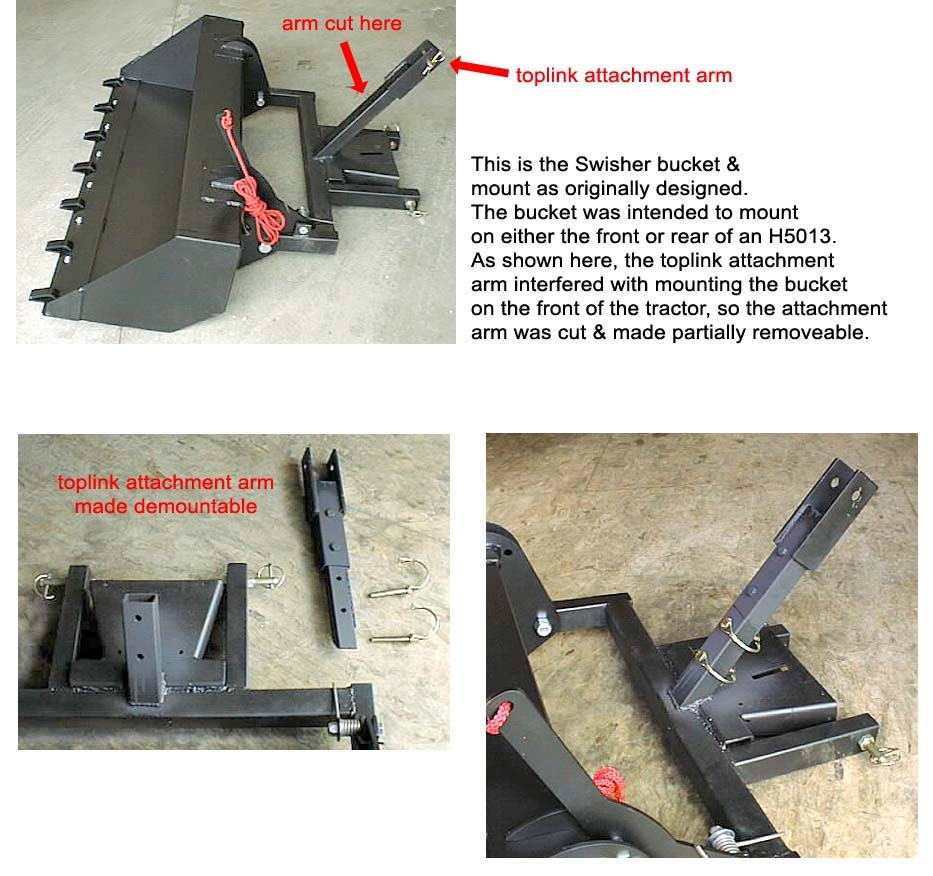

Here is the step-by-step adding a FEL or REL Swisher to your machine . . . .
FEL type
REL type
Attached is the SWISHER product guide for this and the other attachments too.
