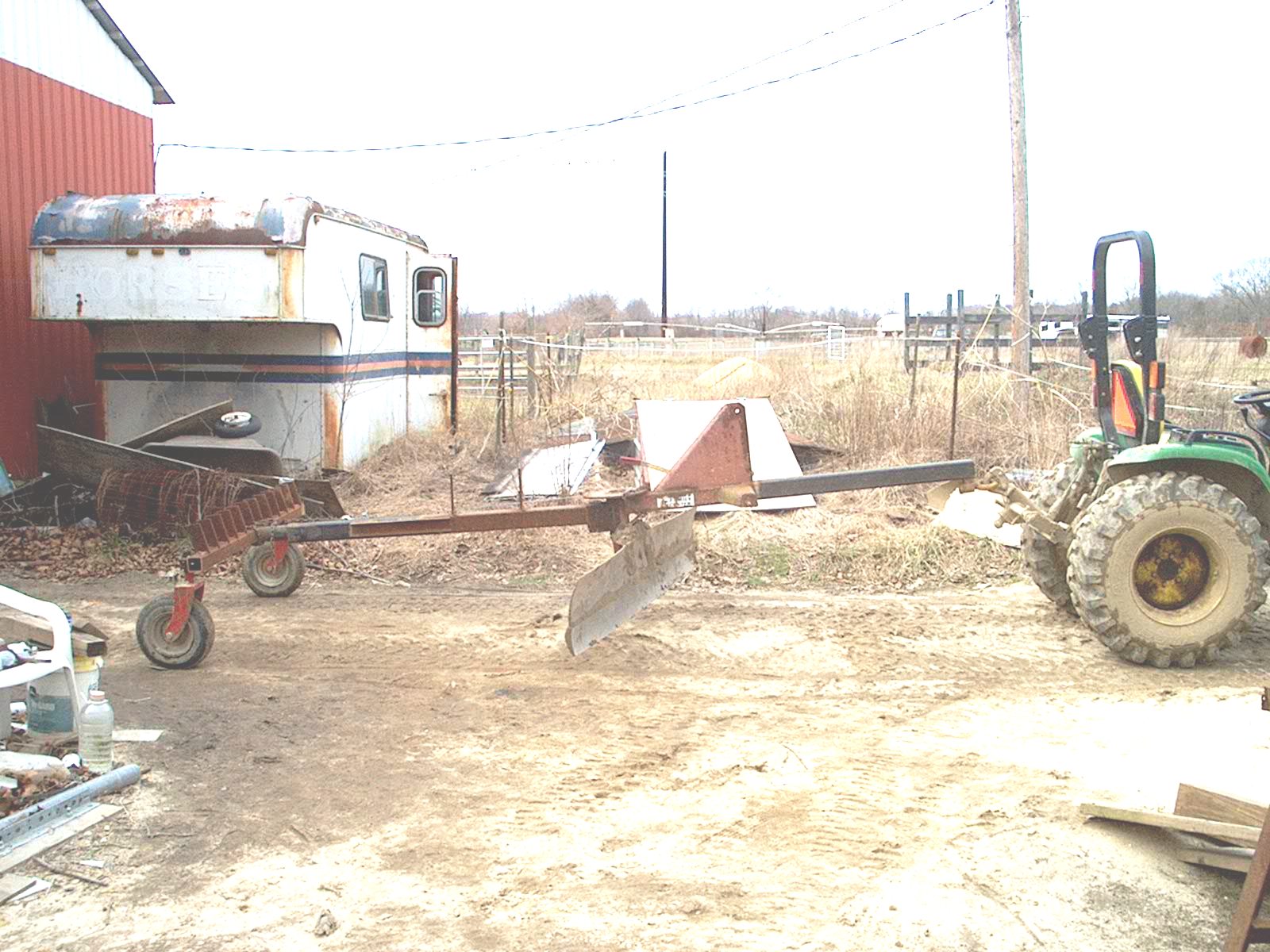

   / Anybody with simple road scrape ideas? #3
here is mine

   / Anybody with simple road scrape ideas? #4
Best I ever used was was some heavy duty grating from an industrial plant tear down. You can angle it either direction by shortening and or lengthing the chain. The grating will act similiar to your basebal diamond drag, but the many cross pieces carry a lot of material.
