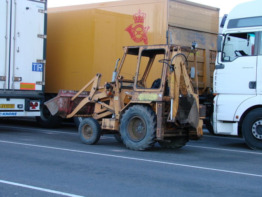

Being new to the forum, I try posting my concerns here:
I have an approx 1972+ model Hinomoto Combac compact digger tractor (made by Tyosha), see image #1 and #2 (the roof is homemade and added later). The starter is byond repair. As I understand from reading and searching all over, Toyosha delivered the engine drive line a number of years both for compact Massey Fergusson and Allis Chalmers. Any of those might then have the same starter?
Does any of you reading this happen to recognize / know the tractor?? Nobody has actually told me so, so far!! And that goes for several countries. But 40 years is a loong time

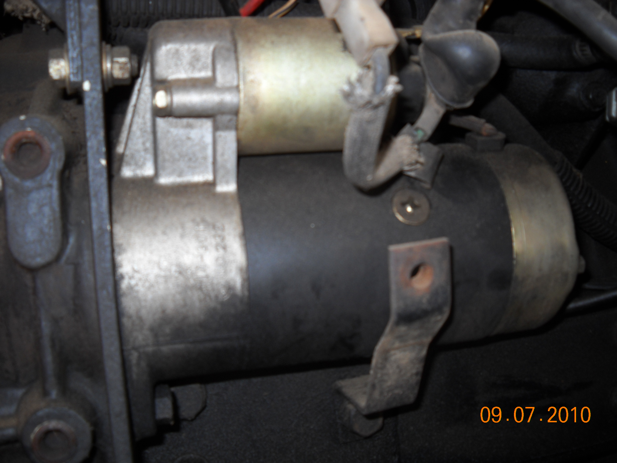

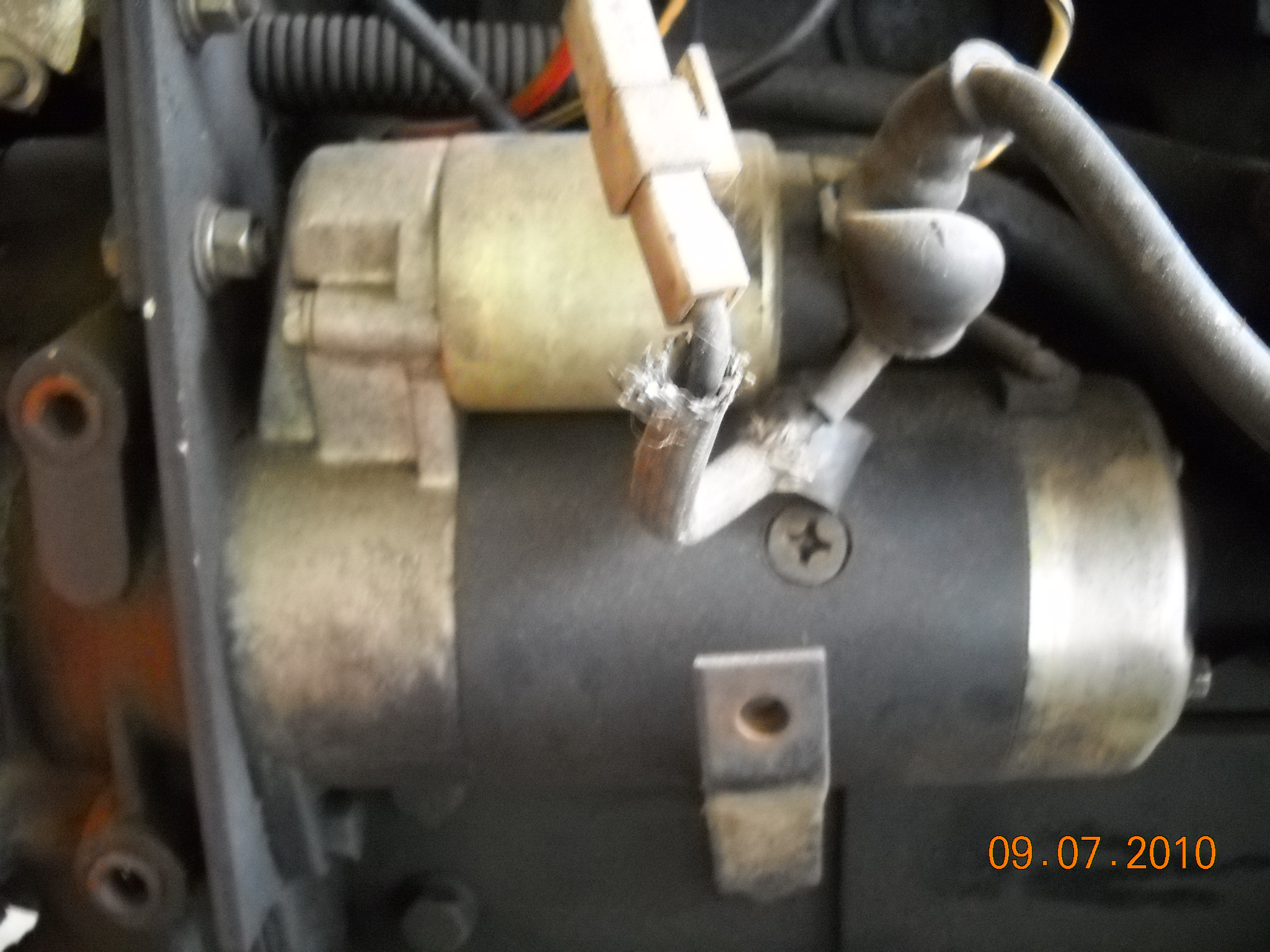

   / Anybody know the 1972 Hinomoto Combac? #4
Well, it looks like it is the same starter, what do you think? i got some pictures but the picture of yours is on the side that is facing in on my tractor. From the pictures though, they look the same. :)

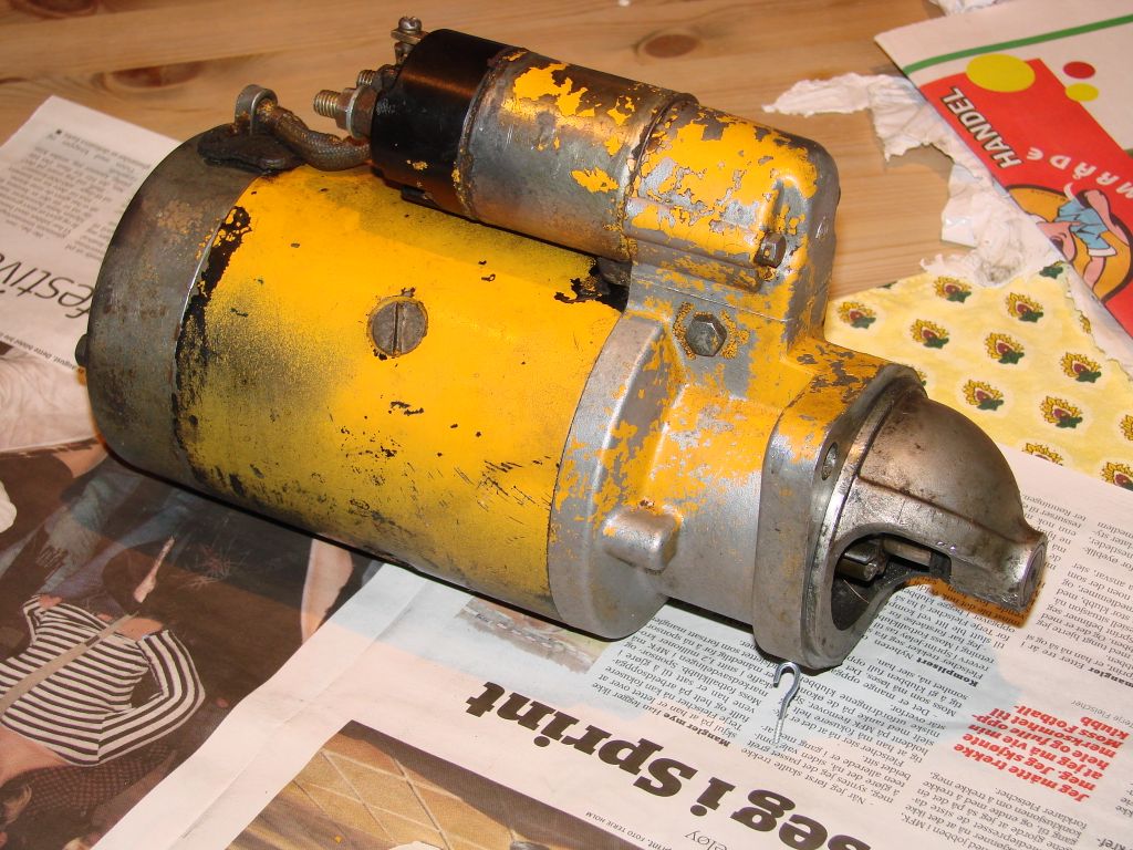

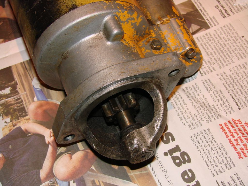

It is close, very close. But.. I'm definitely not certain it is the same. I enclose the rest of my pictures on the starter for you to see.
Do you agree in my worries? Especially the "bolting part" for the starter looks different on yours. And the end lid.

   / Anybody know the 1972 Hinomoto Combac? #7
where abouts are you? I will continue my search, my starter has a different end than that one. :confused2: I would bring it into an auto parts store (ie. Napa) and see if they can find it. They usually have that kinda stuff in their books.

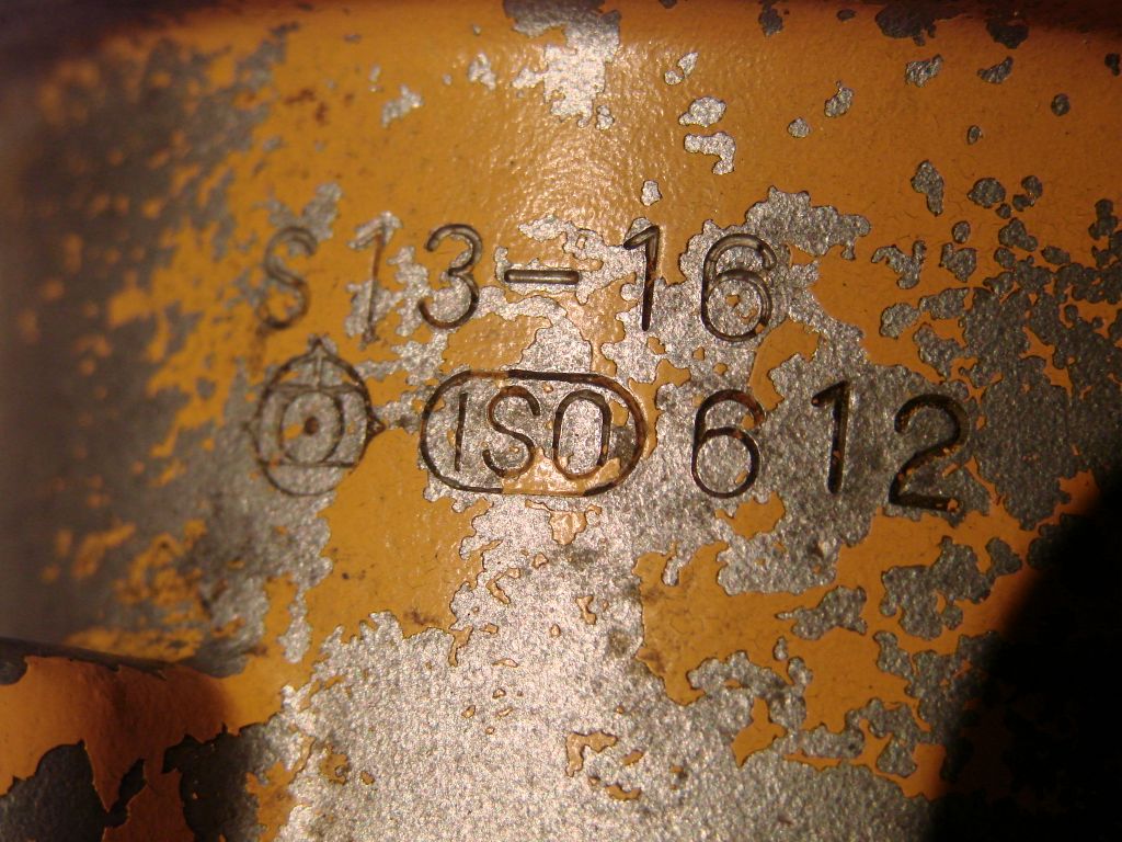

I now saw your next mails - what nice info!!
I have one more picture - this one. Saw your OEM part number, this one has
S13-16 on it. I wasnt sure if this was significant as nobody has found this number anywhere from Hitachi (dealers, suppliers etc). But seeing the number on yours, it must be the number to focus on?

   / Anybody know the 1972 Hinomoto Combac? #10
wow, the 5030 Allis Chalmers was VERY close. here is the link...
Starter Applications
OEM: HITACHI
OEM Part Nbr: S13-31
and you have a S13-16
I looked up the 5040 but it has an entirely different starter. :(
I am wondering if the S13-31 is the same thing....
