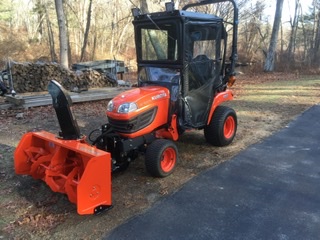

Curious if anyone has any info on them.
I like the idea that they can be installed & removed fairly easily.
And that they are hard cabs, with decent options (Wipers, glass winders, heater option)
I like the new factory Kubota BX2380 cab (Curtis really) but it's permanent. Only the doors come off.
Don't wanna deal with a cab while mowing under trees in summer.
So if you have one:
Do the winders fog up without a heater in winter?
Does it seem well built?
How does it hold up from several assemblings/disassemblings?
Did you get some of the options? (Wipers, heater, glass side opening doors)
   / Anybody buy/install or review an atvcabs cab for a BX? (2370/2380) #2
Yota,
I have a BX2370 (same basic machine as yours) and i have an Original Tractor Cab cab on mine in the winter and its awesome!! I had one of their cabs on my Wheelhorse tractor before this. It痴 easy to put on and take off! I have the glass windshield with a wiper and lights. I am a big weather wimp and I find I do NOT need heat in the cab. I wear a light jacket and Im fine, you get heat from the transmission and engine.
I think it was about $1000 delivered to my door!
PM me for pictures or drop by next November and Ill give you the tour! Im halfway B/T Boston and Plymouth
Cheers,
BN

Are they made so you can use the BH with them on?Ron
They have 2 models. One for the 1880/2380/2680 and one for the 23S. Guess it's different because of the different ROPS
Byrd,Do you find the windows fog up, without a defroster/heat in cab?The ATVCabs cab does look nice. And considerably cheaper (nearly $1k) than the factory cab.

I have this on my BX1880 as well, same as above. I have the manual wiper, glass windshield. No fogging issues, and although I got a free electric heater with mine, I haven't felt the need to install it. First time install takes a bit, however you can take it on/off pretty quick in sections. Its really nice to be out of the wind and blowing snow.
