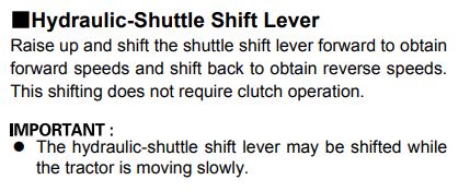

Not real sure I have it, but if you have to depress the clutch if its in gear to stop, then its close to the same as sync. So you can be rolling forward and shift to reverse without issue? I'm thinking there could be an issue. Maybe the plus is you can be rolling forward and shift to neutral without the clutch, but to change direction you need to ease out on the clutch
I believe my M7060 is the same tranny-wise as a M7040. When I am doing loader work (so usually in 1st or 2nd gear) I do not use the clutch when shifting from forward to reverse. The tranny is designed to work that way. Here's a snip from my owner's manual:
Note that it states that the tractor must be moving slowly when reversing directions without using the clutch. I guess the term "slowly" is open to interpretation; I never tried it at speed - and don't intend to!
