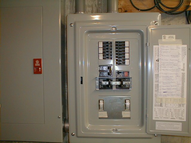

I've got a cheapo Coleman 5KW generator (Briggs I/C engine). It's connected to my panel via a GenTran Transpanel switch (picture attached). I exercise it monthly and keep 10-15 gals of fuel on hand with Stabil and rotate the fuel with my truck regularly. I also keep a siphon hose ready if needed. Annual oil change, air filter cleaning and new spark plug. Always drain the carburator dry after each use. It always starts on the first pull!
Our last power outage was for 3 days during a fierce snow storm. Generator powered well pump, boiler circulator pump, refrig, microwave or toaster or coffee pot (we already have a gas range), some lighting and optionally TV or computer (both are carefully protected).
I'd recommend getting actual wattage measurement of the items listed. Motor startups can required 2 or 3 times running load (need that much generator surge capacity). Well pump depending upon size/depth/capacity can be one of your biggest energy users. But don't underestimate any electrical heating elements. You mentioned "water heater". Do you mean a gas/oil fired boiler? If so, circulator pump(s) take about 50-75 watts.
If you expect others to move, startup and connect the generator, you should look at some automation. Electric start, automatic transfer etc. At the time I bought the Coleman, I couldn't afford the automation, however prices for 12KW generators are becoming more affordable. Hope this helps.
