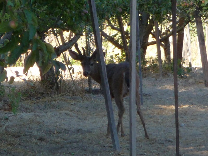

I have maybe 60% open sky while driving tree to tree. But if some satellites are near the horizon I would likely lose some while moving.
Here are a couple of pictures from last year. The first one shows how I need to drive close to a new tree before I see it - behind the little buck's antlers in this case. Kinda like an Easter Egg hunt.
The second picture shows why I want an efficient route. That little tractor struggles for traction pulling a full tank of water (2600 lbs, on 8" tires) uphill on disked ground. (I could pull with the larger tractor but this one maneuvers under the mature trees better).
Any suggestions on a specific GPS application for Android?
