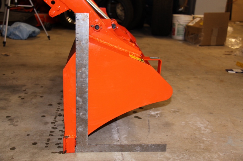

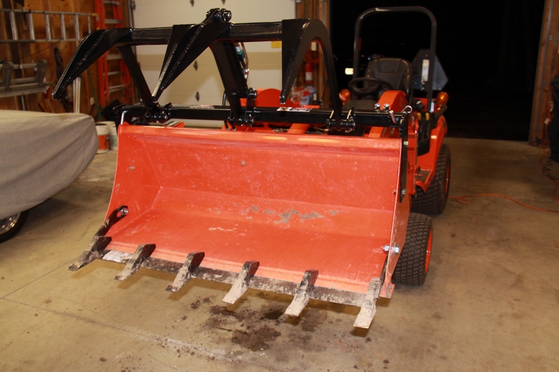

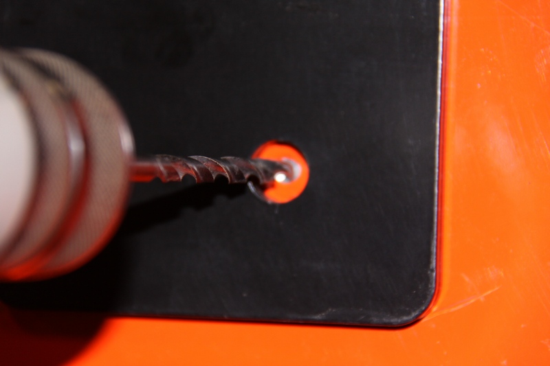

I know this one has been done, but here is one more. I'm super happy with the heavy duty construction of this unit, and Jeff is great to work with.

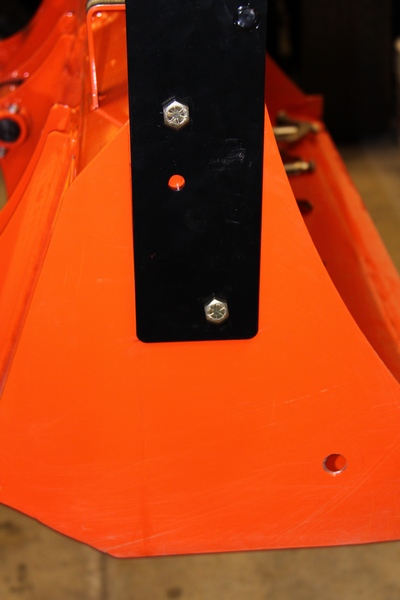

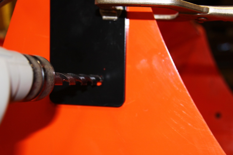

Mark the location for the bucket brackets. Use a framing square and the measurements in the instructions. If these brackets are crooked, you will have a hard time later with the quick disconnect pins.

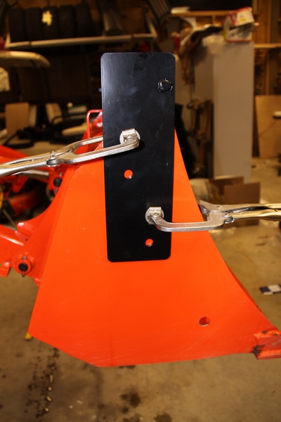

Clamp the brackets securely.

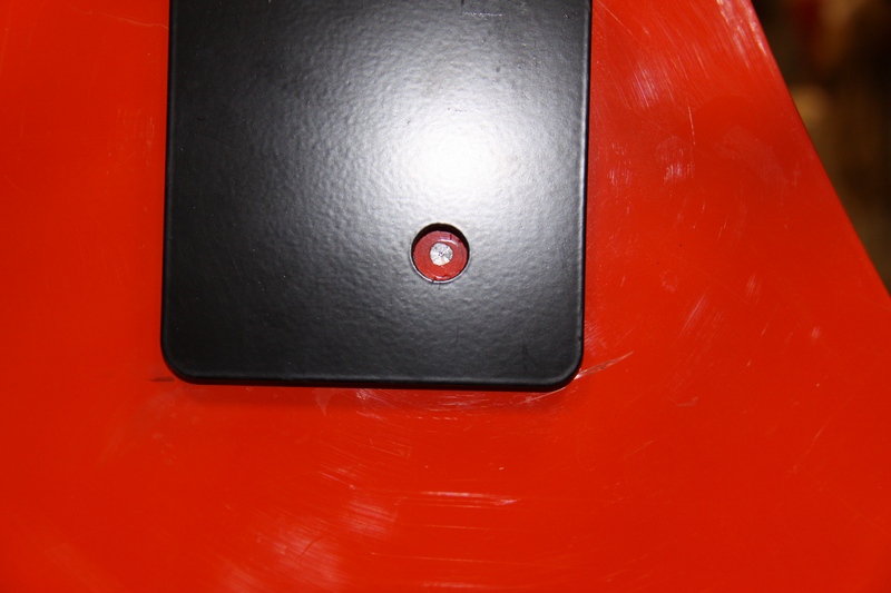

Use a 1/2" drill bit to mark the holes.
Then a smaller bit as a pilot, then finish with the 1/2"
There are three holes, but you will only use two. Use the bottom one, and either of the top that will not interfere with the top of the bucket. On a newer LA243 FEL, it's the very top hole.

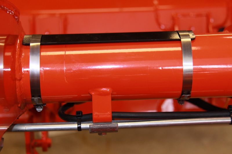

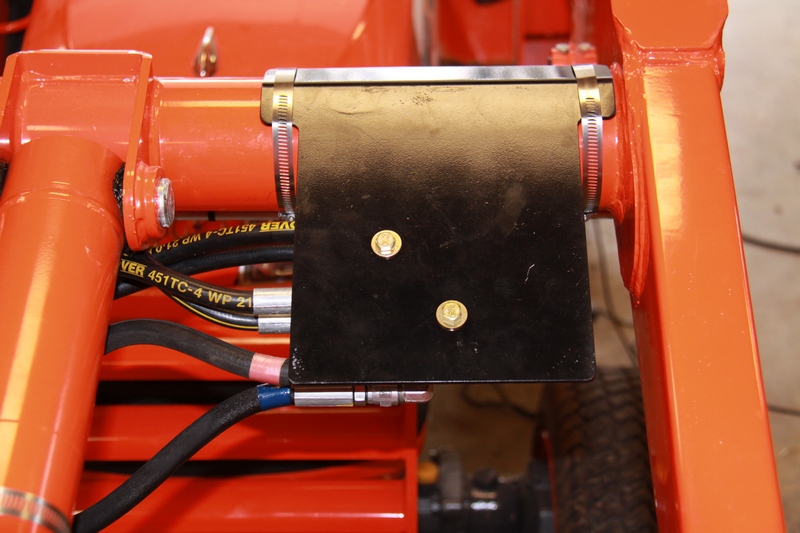

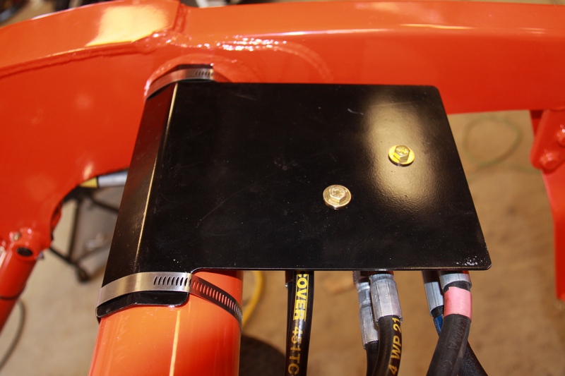

Next I attached the diverter valves. When you order one of these make sure you tell Jeff the size of the cross brace on your FEL. Older BXs are larger than the newer ones and you need the correct size clamps.
/ American Solutions Grapple BX2660 install

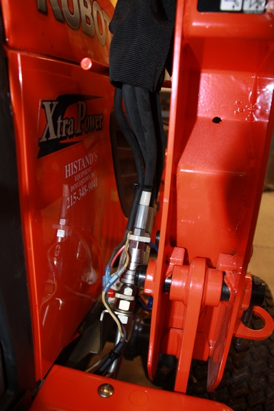

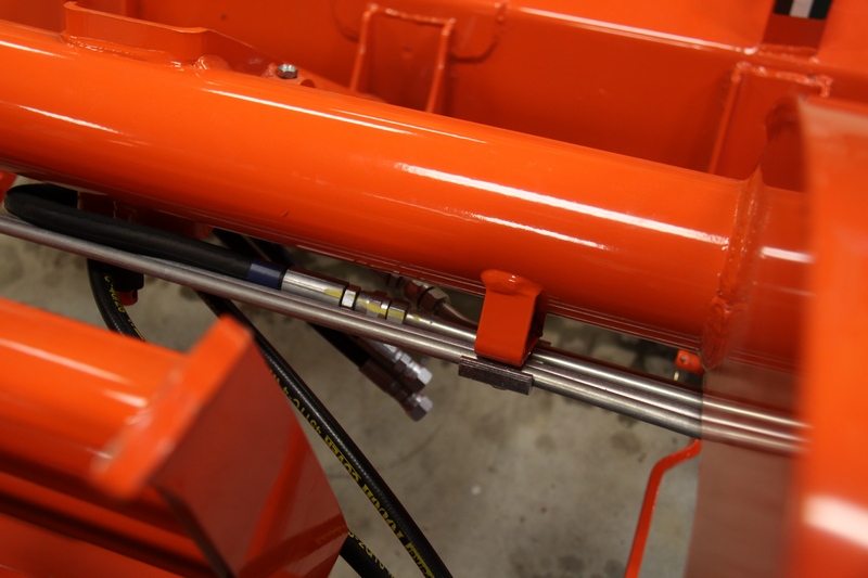

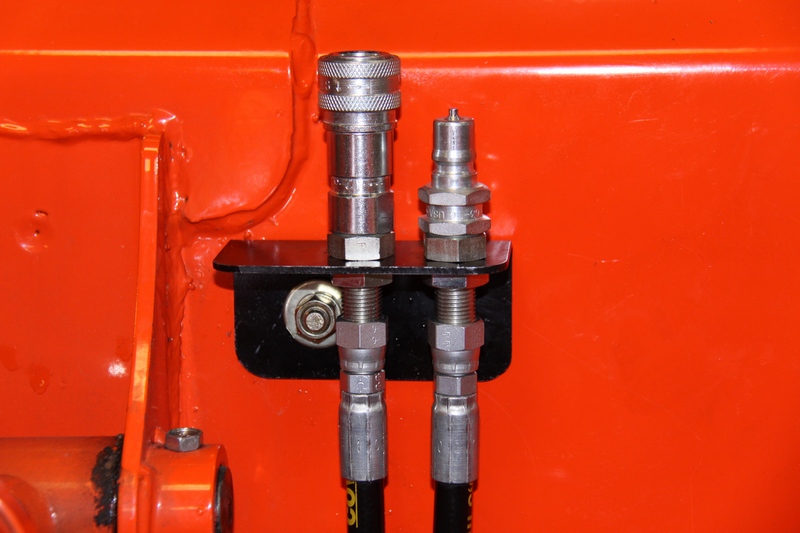

Next come the lines. You detach the flex lines right where they connect to the hard lines. The stock flex lines go into the diverter valves, the short ones from the valve go to the hard lines.
Long ones go to the bulkhead fitting. Mount this bracket on the back of the bucket in a spot that gives the lines the most range of motion and protection.

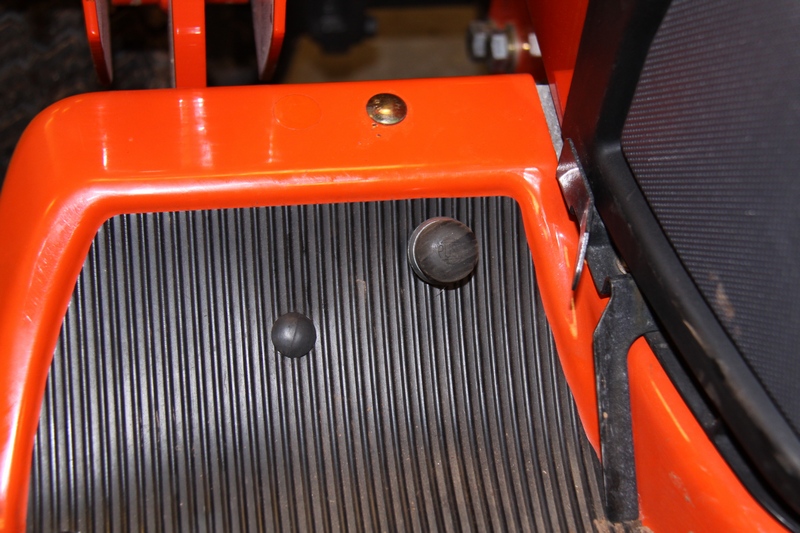

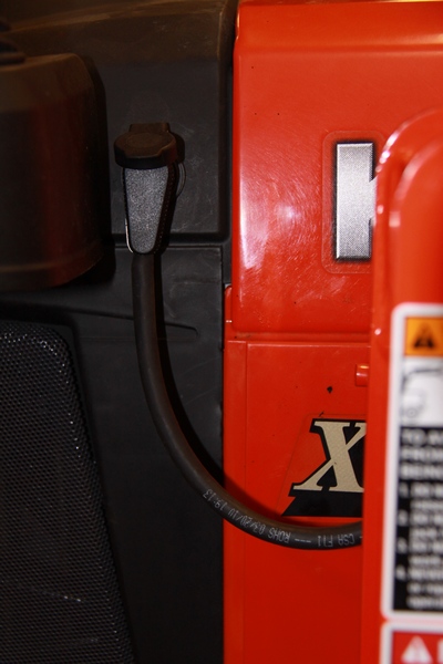

The switch can go anywhere, I chose the left floor board.
The harness come with blade connections which you would position near the hose disconnects.

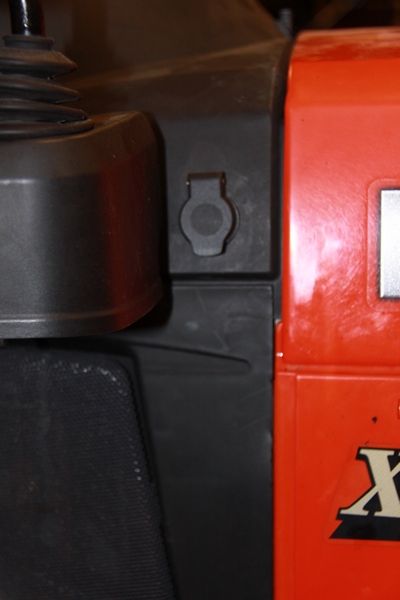

Some guys swap that out with a twist plug. I'm a fan of the powerlet connectors.
With the plug out.

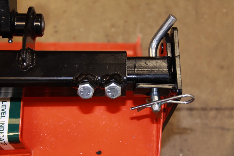

Mount the grapple to the bucket brackets, tighten the adjuster nuts, install the quick disconnect pins. (How parallel are your bucket brackets??? You will find out here!)
Attach the quick disconnect lines and you are in business!
Me want cookies! Er, I mean, let me go do some serious work cleaning out brush.
It really was not hard to install. It could be done in a couple of hours, 3-4 if you are taking your time.

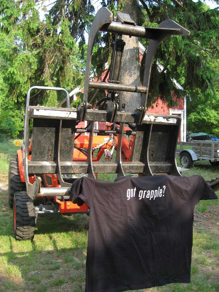

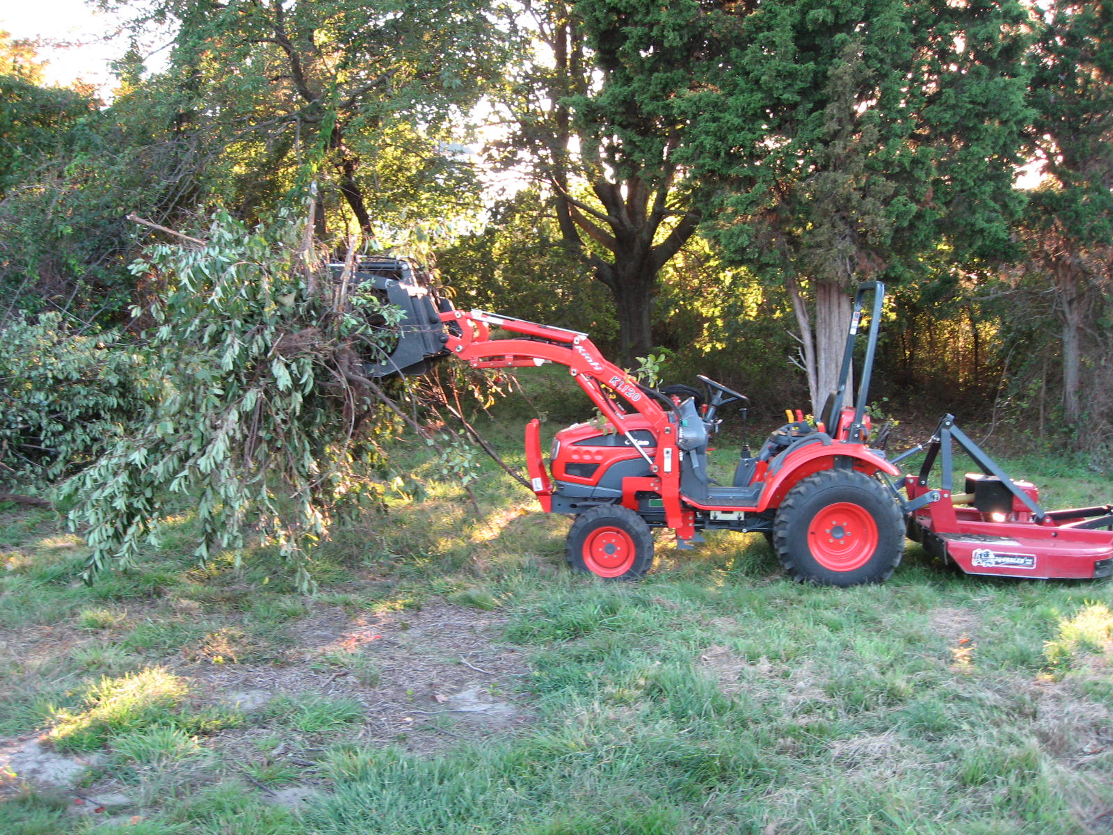

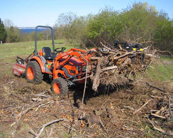

Very nice job. You are now ready for toe to toe combat with Mother Nature. Grapple plus bush hog is a great combination for medium sized brush. You'll need something like that on the rear for ballast anyways.
