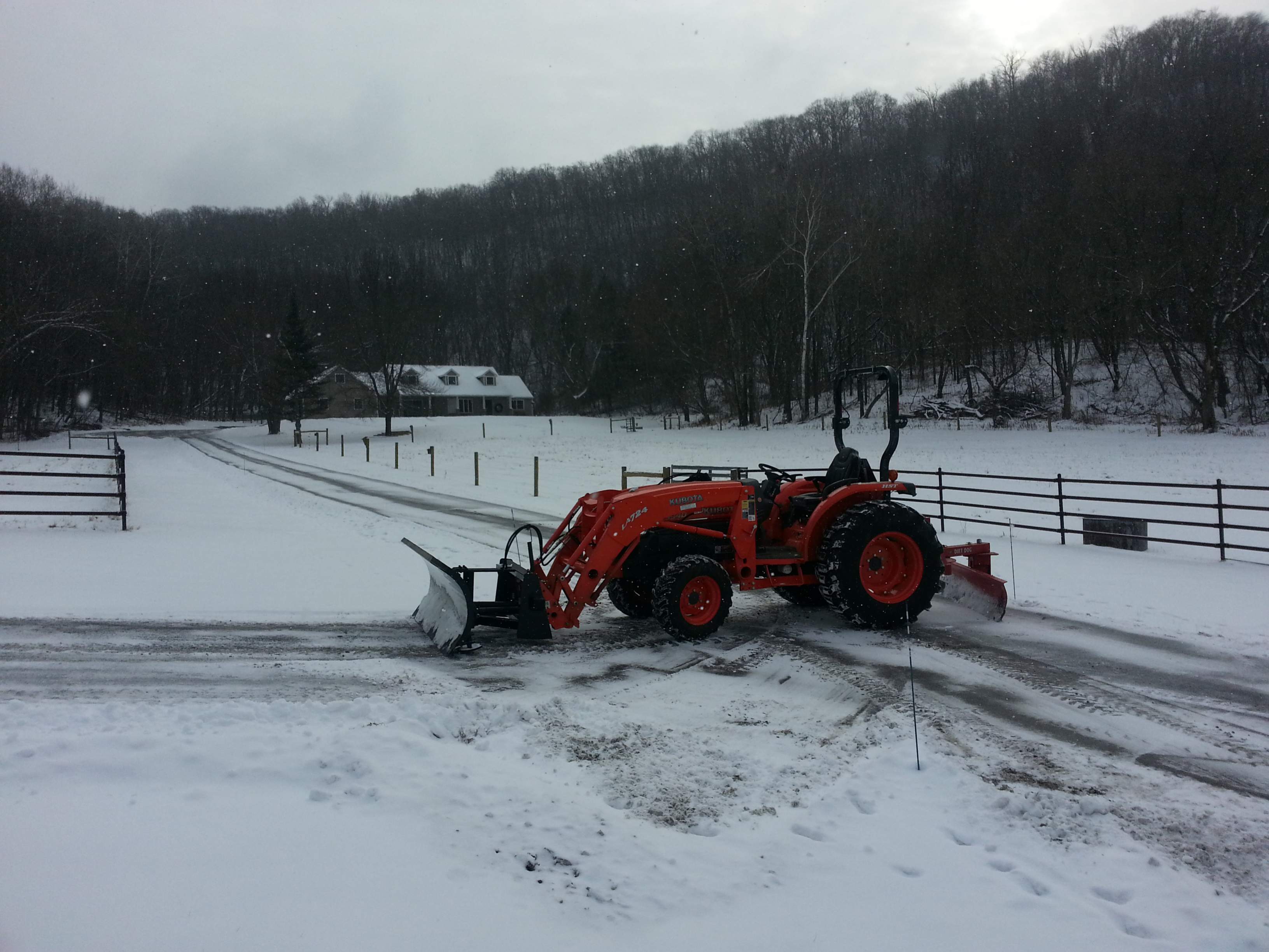

Here is my set up.
I have a 1/3 mile driveway that climbs 120 ft with one sharp corner (at the steepest part). We also have a 6 car parking area up by the house and a 125' driveway up to the barn (where the picture was taken). The tractor is a Kubota L3940. I have a 7 foot front blade and 7ft rear blade. I purchased the front blade this year. If the snow is 4 inches or less I rotate the back blade to the right by 15* and angle it 30* which gives a 15* angle to the right. This puts the rear blade a foot past the outside edge of the rear tire and helps kick the snow further into the ditch. Works slick. I go down from the barn in H but have to use M on the way up until the grade lessens. In deeper snows the 15* angle isn't enough roll the snow off and I get windrows and have to make a third pass. The last time, I didn't kick the blade out to the right and had no windrows but I didn't get the snow as far off the driveway.
The front blade/rear blade combo has cut 10-15 minutes off my plow time mainly because I only need to make 2 passes (one down/one up). It also saves a tremendous amount of time with the parking area. I can back up to the garage and pull the snow away but since the front blade is pushing I don't get windrows (I am only pulling a tractor's length of snow). After I push the snow off the edge of the lot, the HST makes backing and pushing the pulled snow a snap.
So far we haven't gotten any large storms so I'll have to reserve judgment on clearing snow falls over 5 inches. Considering I used only a rear blade last year, I imagine it will be an improvement, regardless.

Nice set-up, Mailbox, just curious on the front blade,
do you "float" the loader or is it set at a certain height when you blade.
Another member here was concerned about the weight of the "loader and blade"
combined when plowing, in that it would "dig" too much on graveled roads.
My front blade has angle and has a float on it, just the weight of the plow and harness
connect with the road, I know this isn't an issue on pavement.
