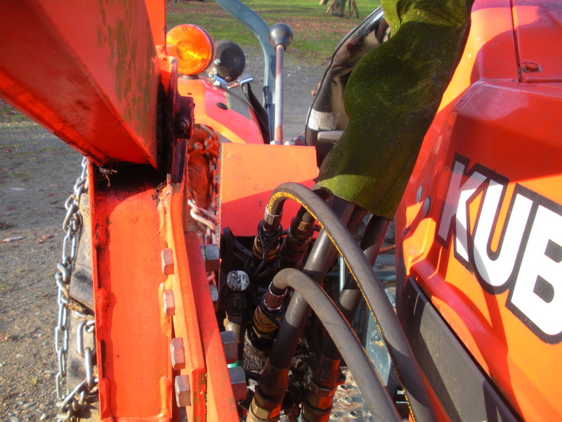

That sounds interesting. Can you provide pictures? I am not good at visualizing. Thanks, Steve.

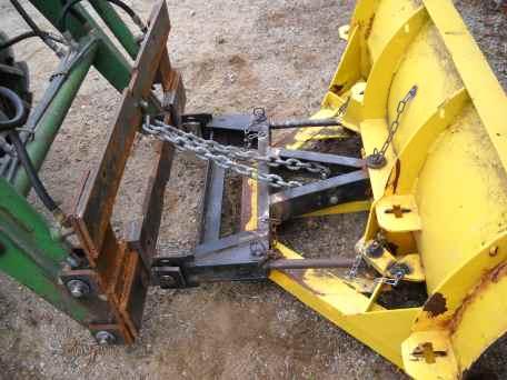

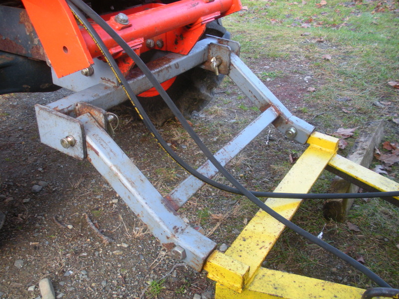

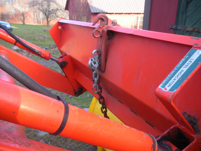

I picked up a plow blade for $200 that already had been refitted with a crude frame for something or other. I just extended that frame and made an equally crude mount on the tractor. I threw this together in a hurry one year just before a big snowstorm. Figured I'd have to redesign/rebuild it, but it's worked so well I've just kept it. Have run it about 5 years now, so I guess it's ok. Originally I manually handled the plow angle, but that was a very big pain. I discovered I could just unplug the bucket curl/dump hoses and use them to control the angle cylinders; both single-acting cylinders are mechanically coupled and act as one double-acting cylinder. I welded a hook on the back of the bucket to provide the lift point for a chain. I have about $250 in the whole setup. Here's a few pics.

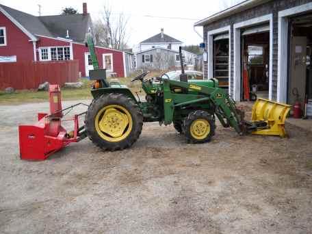

Guess I am covered all the way around, everything can be removed in min and another attached. front&rear plow.jpg Snow Blower.jpg Also have the FEL if needed.
