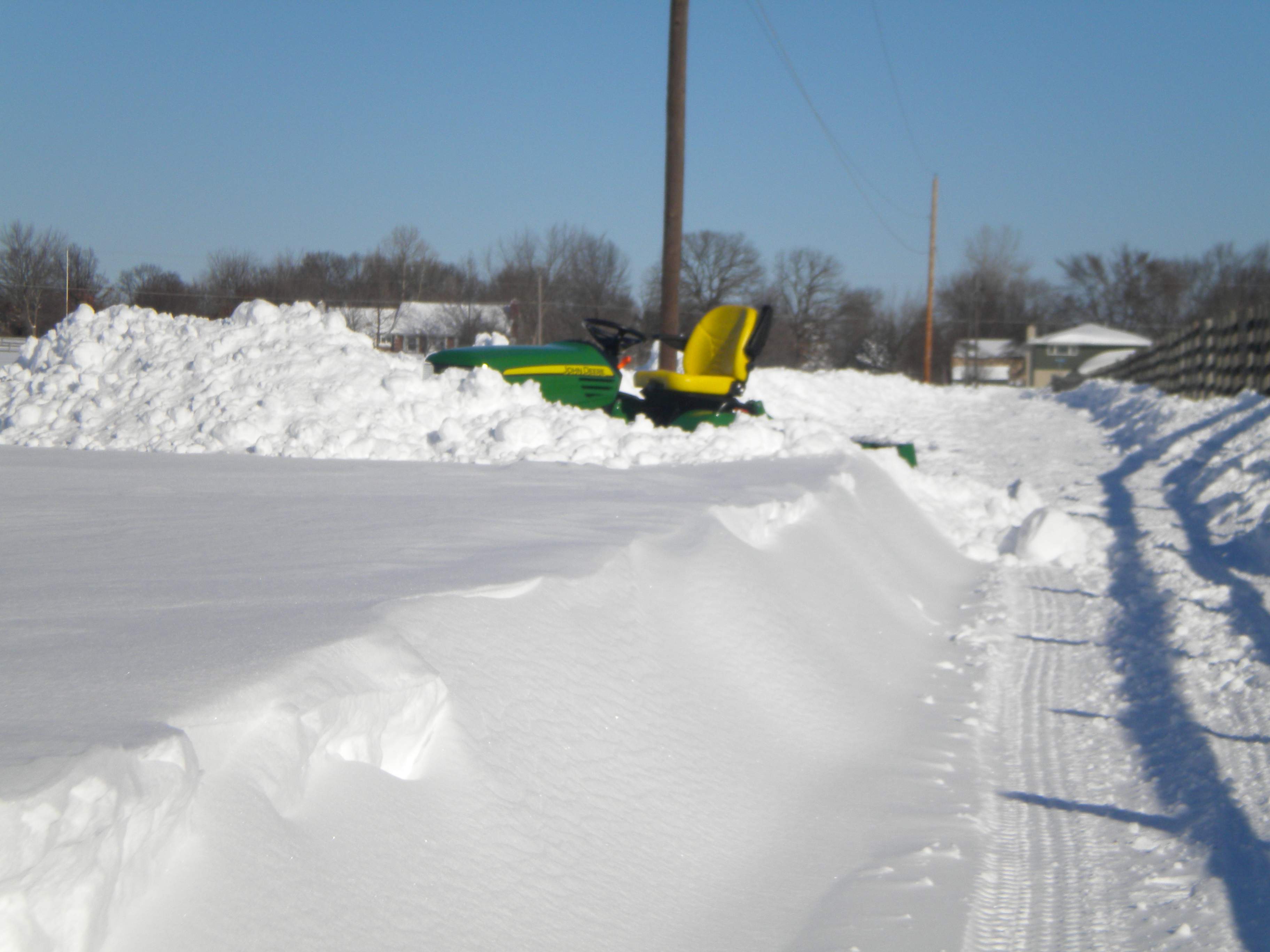

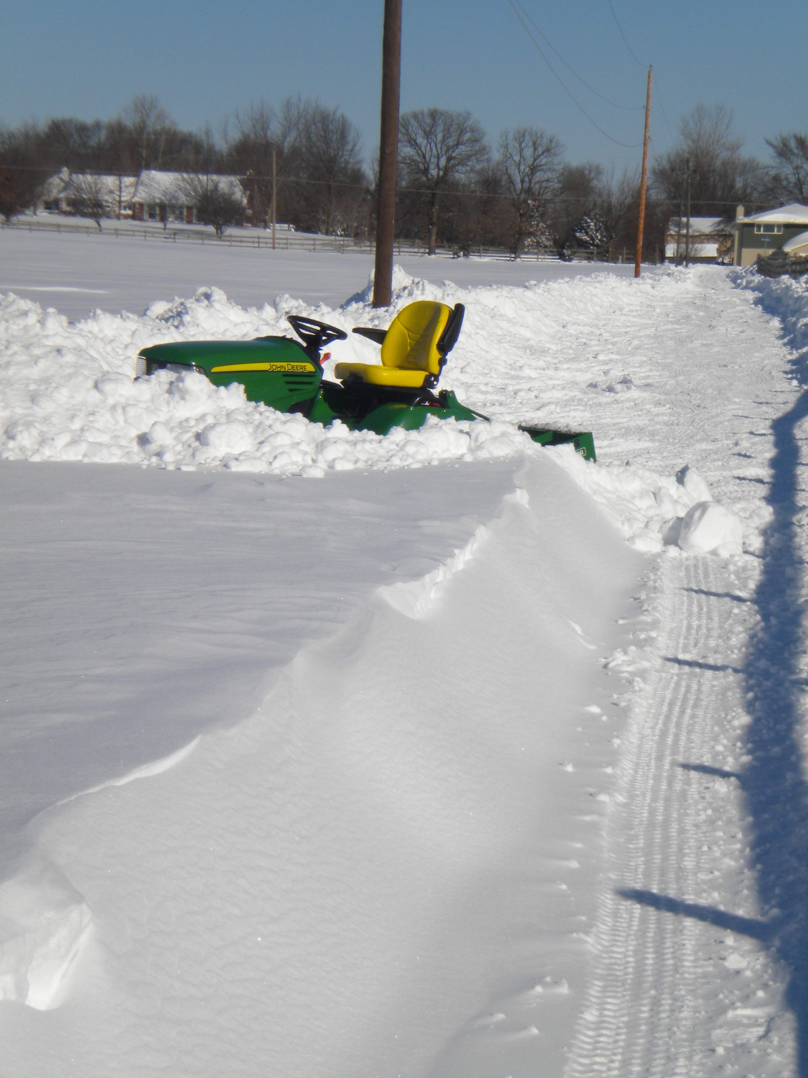

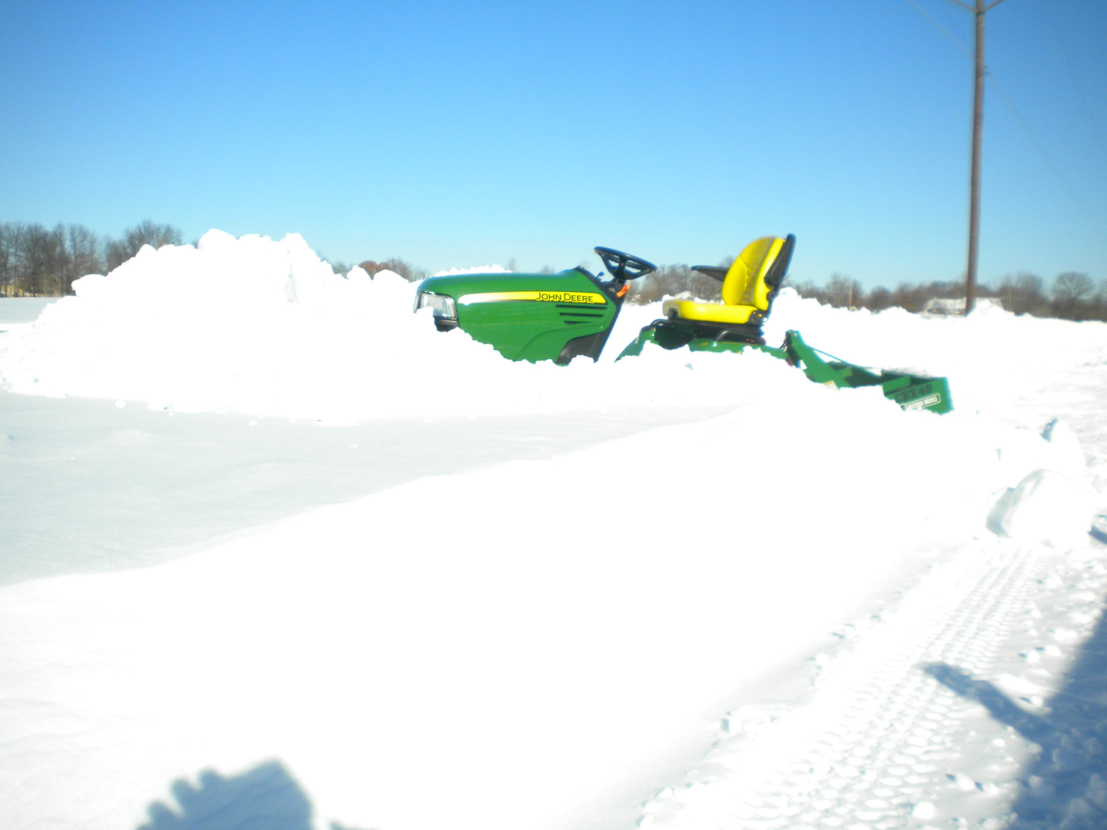

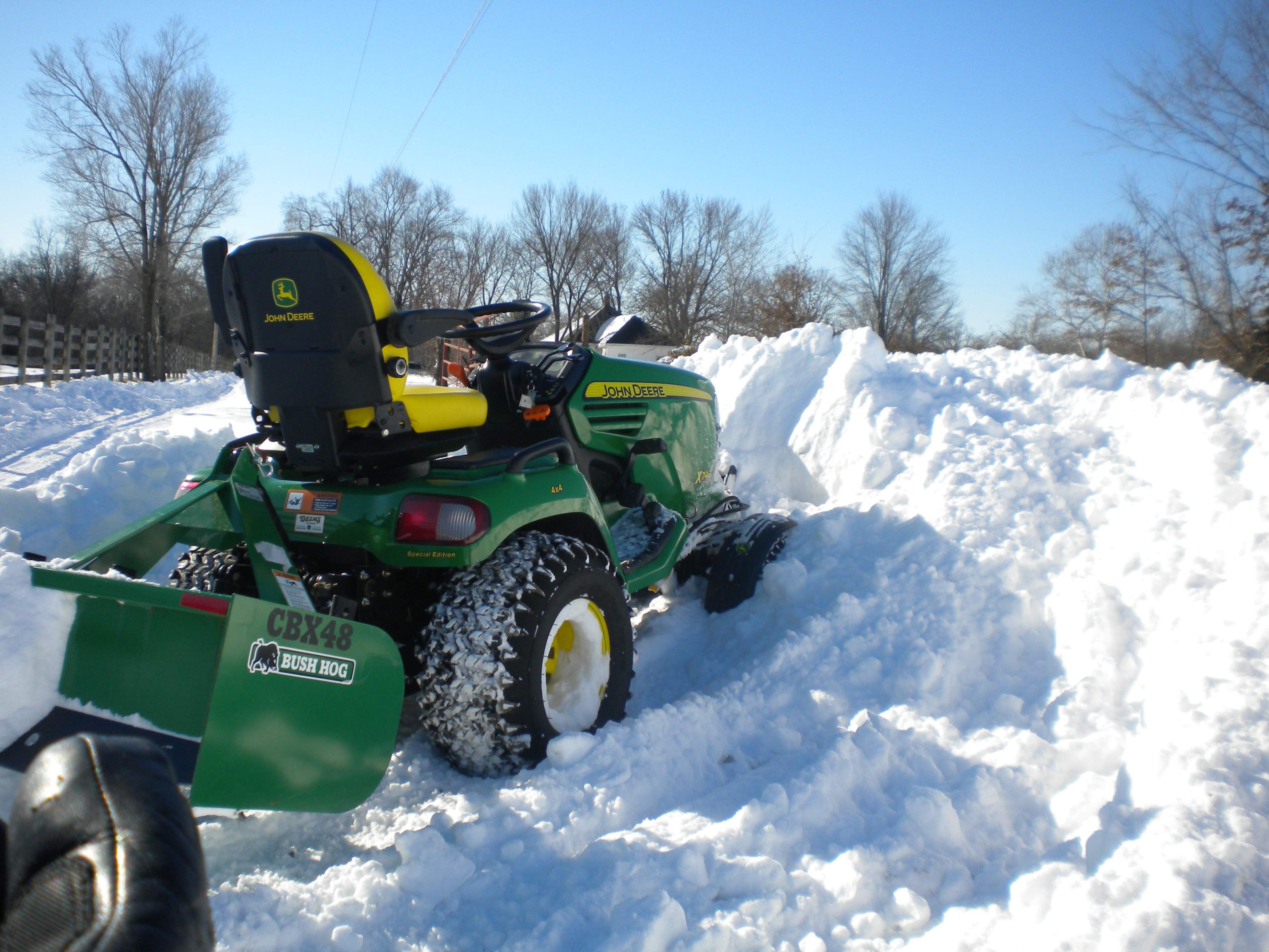

I see this thread is a year old, but since TBN decided to resurrect it, here's some pics from Feb 2011. I can make the lane drivable with two passes, up & back. When I get time I'll go out and push everything back if it's building up so I can still pull off the up & back thing in a pinch. The box blade was just left on out of laziness, but when I'm pushing stuff back it's kinda handy to push banks going either direction.
Our lane is about 1/3 of a mile. For the amount of snow we get in SW Missouri and the long gravel drive, the front blade is a dream. The JD X748 is heavy enough & the 4WD works great. I've used a 2WD 455 with weights & chains that didn't eat up snow like this baby does!
The tractor was momentarily stuck, but only because it sat for a while while decided to take a photo op.

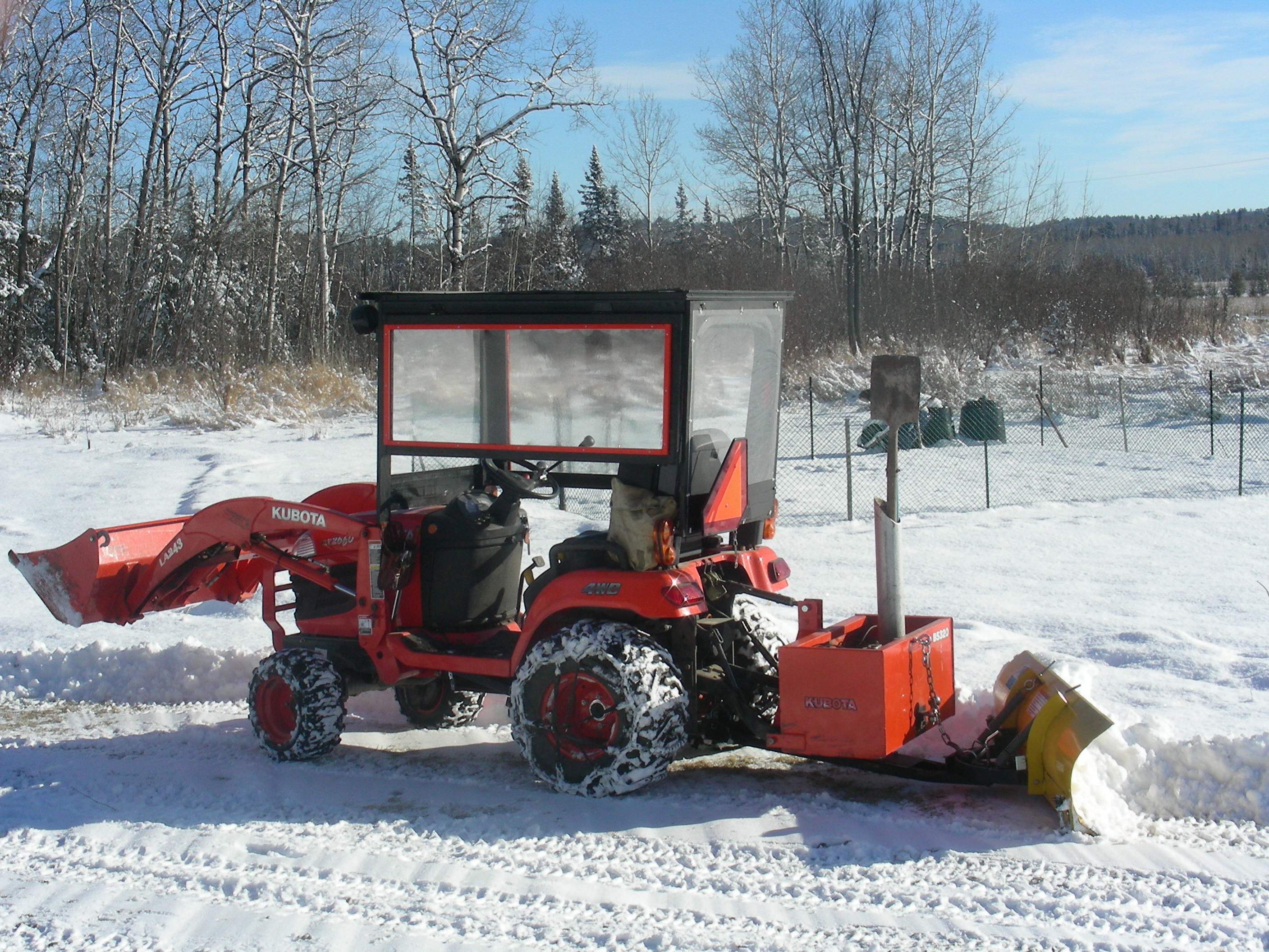

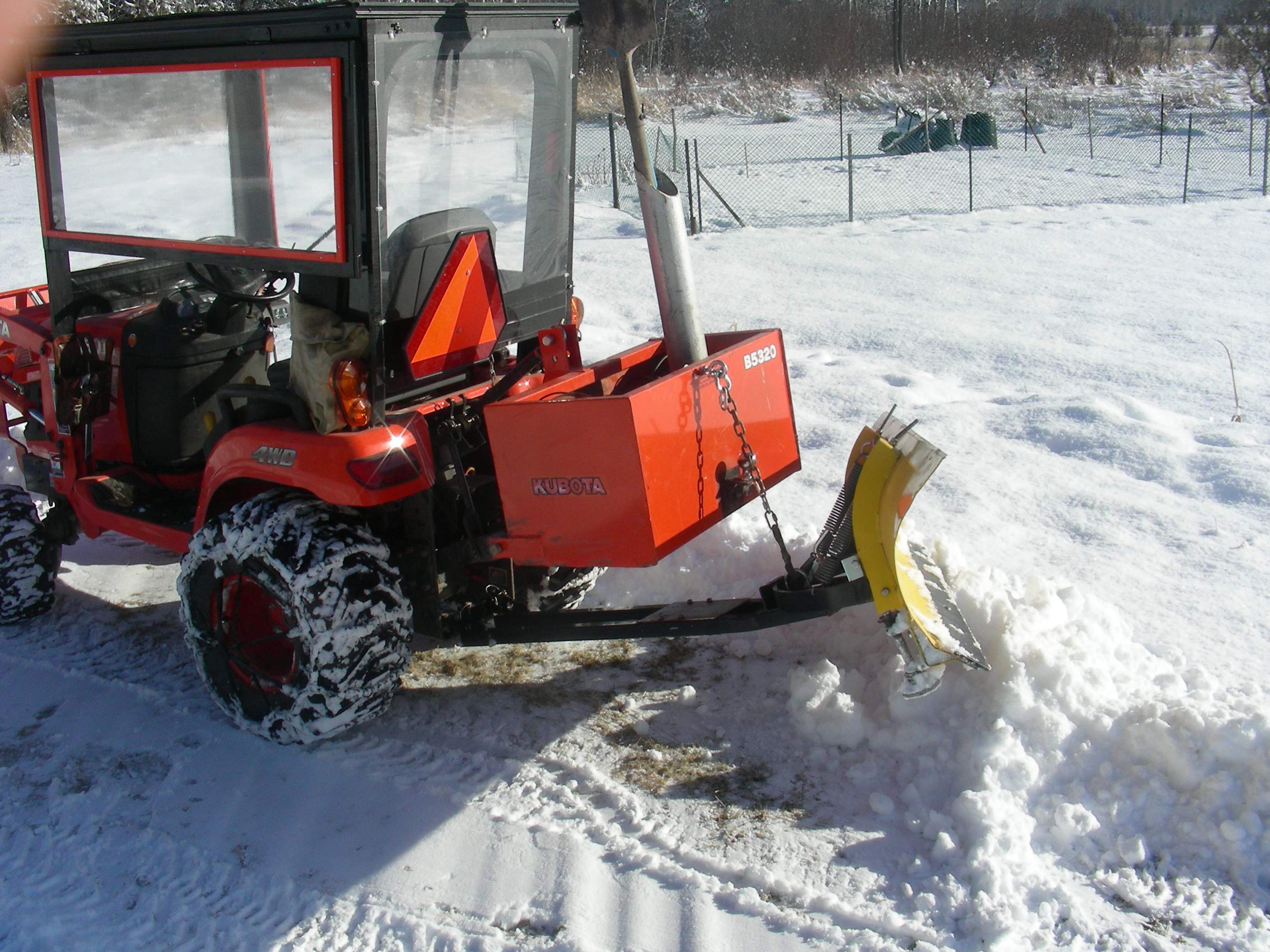

I just put one at each end :)
ATV plow at rear and FEL at front, best of both worlds, just welded a little adapter at rear and use the weight box .......not for weight but just as the means to lift blade up an down by having a chain attached to where the ATv winch would normally attach.
