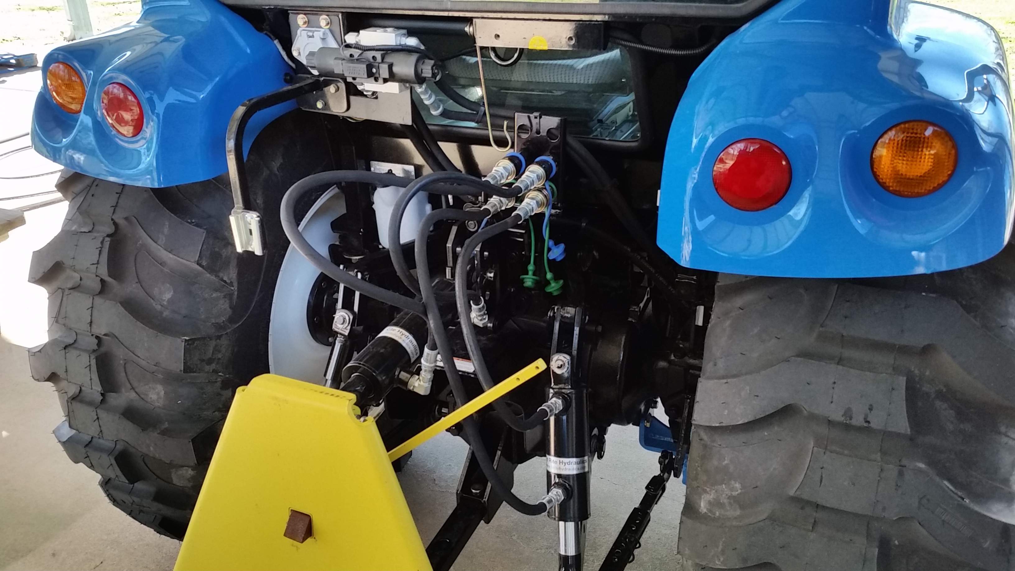

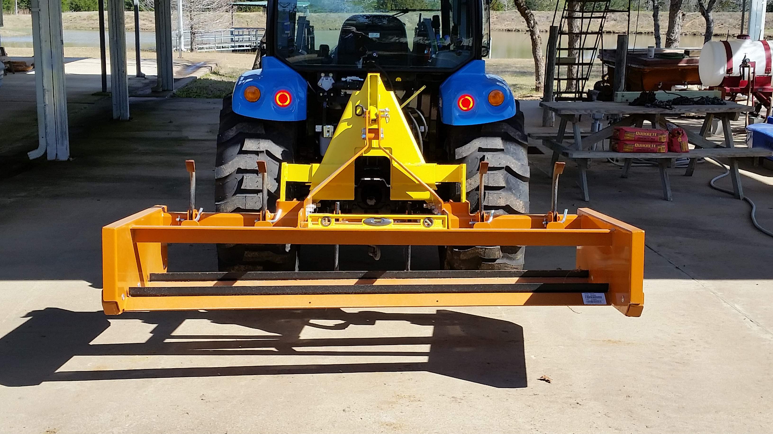

Installed new Fit-Rite hydraulic top and side links to new LS XR-4046HC. Installation was easy and the hose lengths suggested by Brian were just right for full range of motion, in both axis. Removed the adjustable side link from right side and installed it in place of the fixed side link on the left side. Next, extended the hydralic side link to 1/2 stroke then adjusted the left side link to level the lower arms. This will give about equal tilt both right and left.
Hint: If you use a QA on your 3-point, the top link cylinder needs to be about 2" shorter at full retract. We have the Delta Hook CAT 1 QA but, other QA's will have same issue.

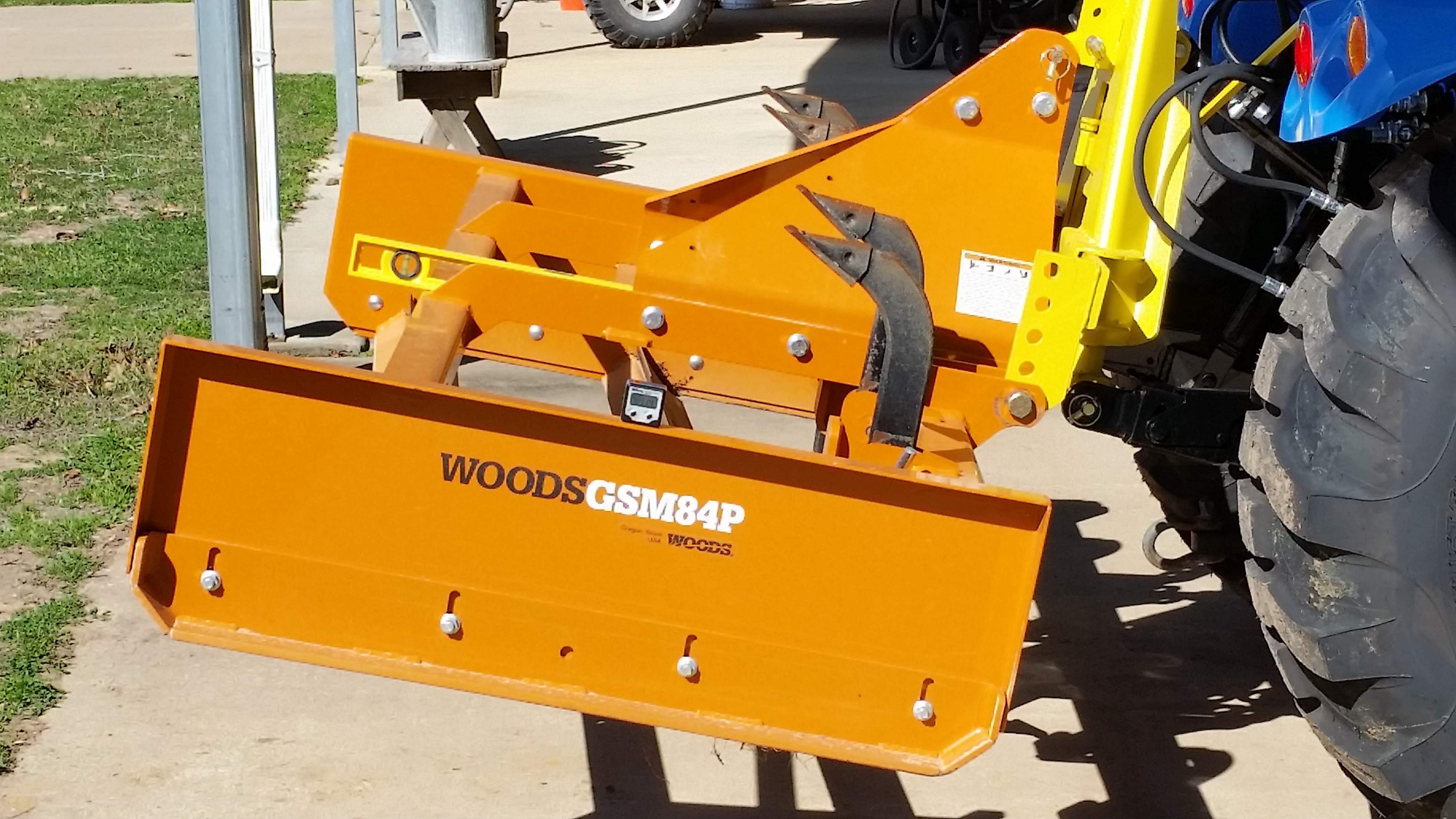

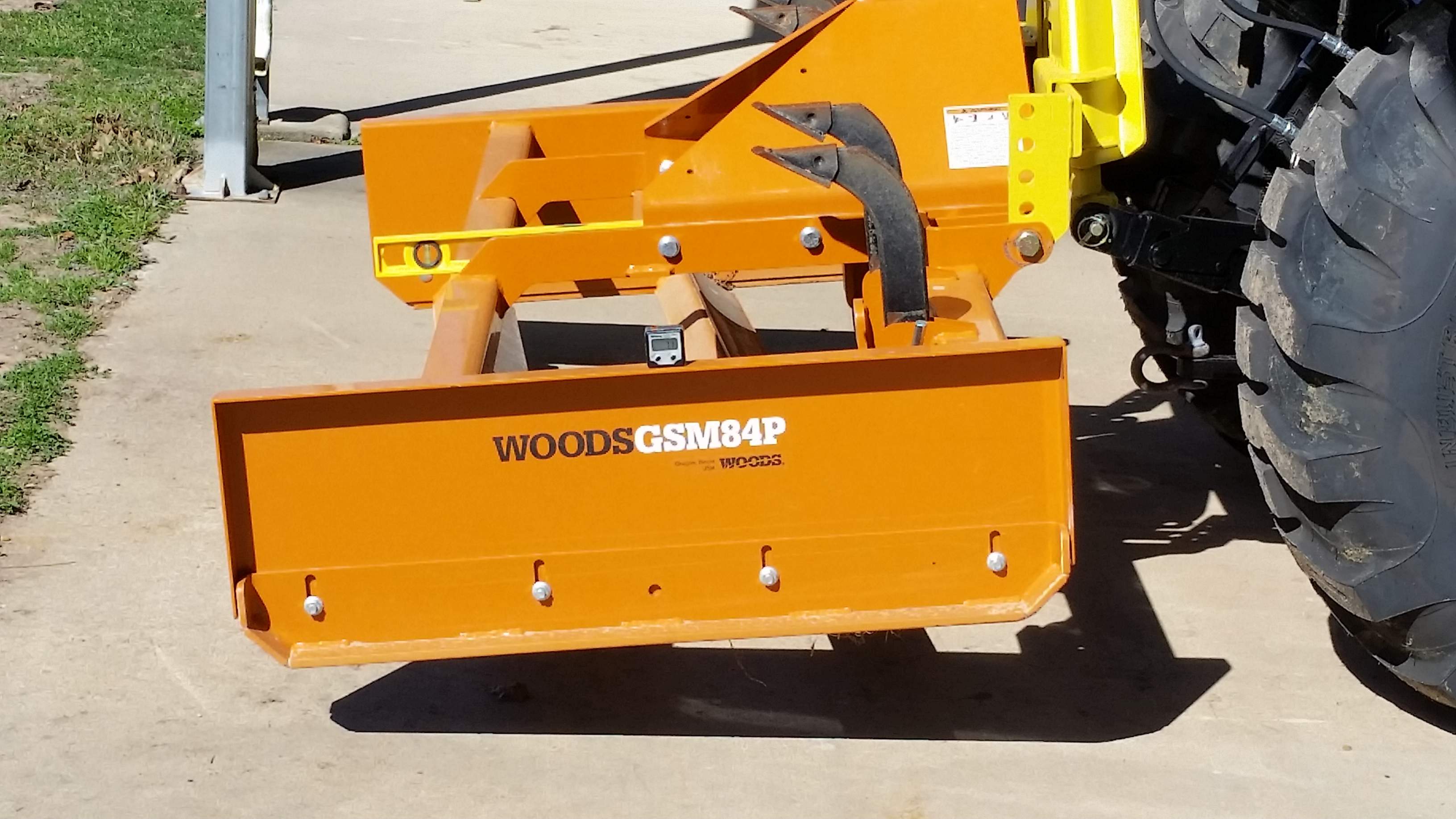

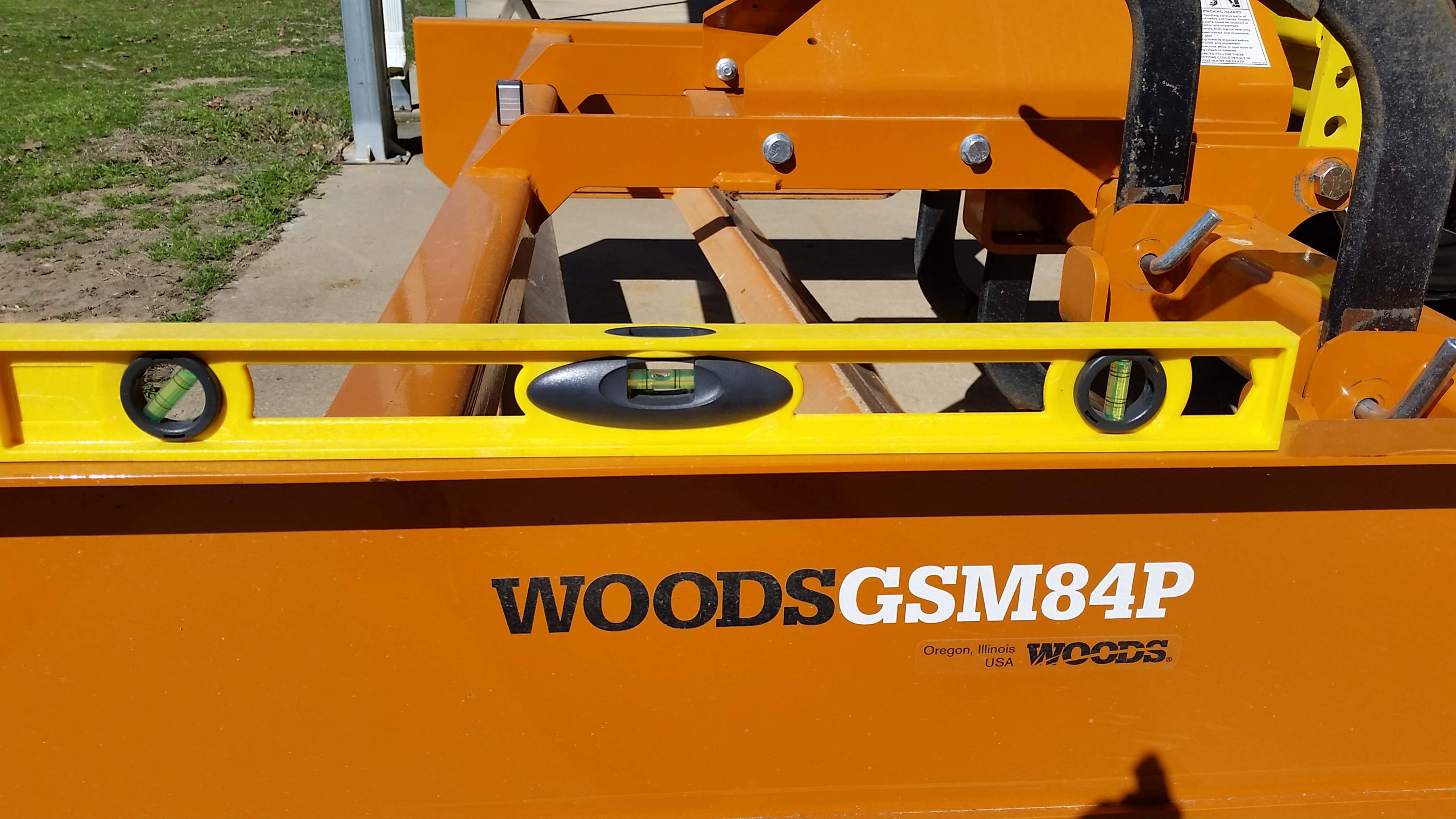

Installed Woods GSM84P rear grader on 3-point and parked on a level surface. Adjusted to side link to make grader level from right to left.

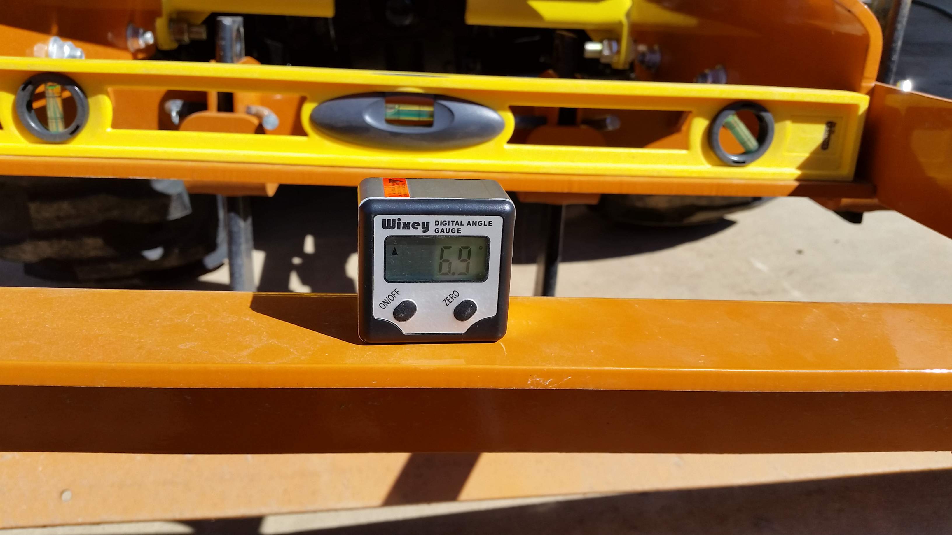

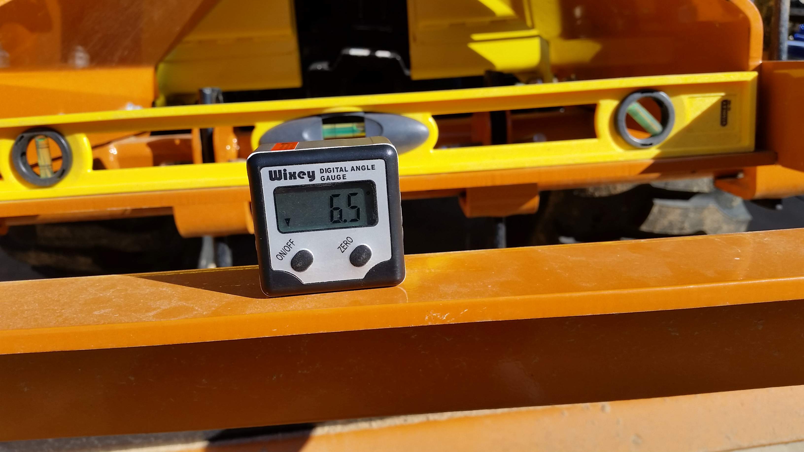

Installed a magnetic base digital angle gauge on horizontal cross member, zeroed it for level and then ran side link to both tilt extremes. 6.5 degrees left and 6.9 degrees right, for delta of 13.4 degrees. Will lower the left adjustable link a thread or two and tilt should be approximately equal in both directions.

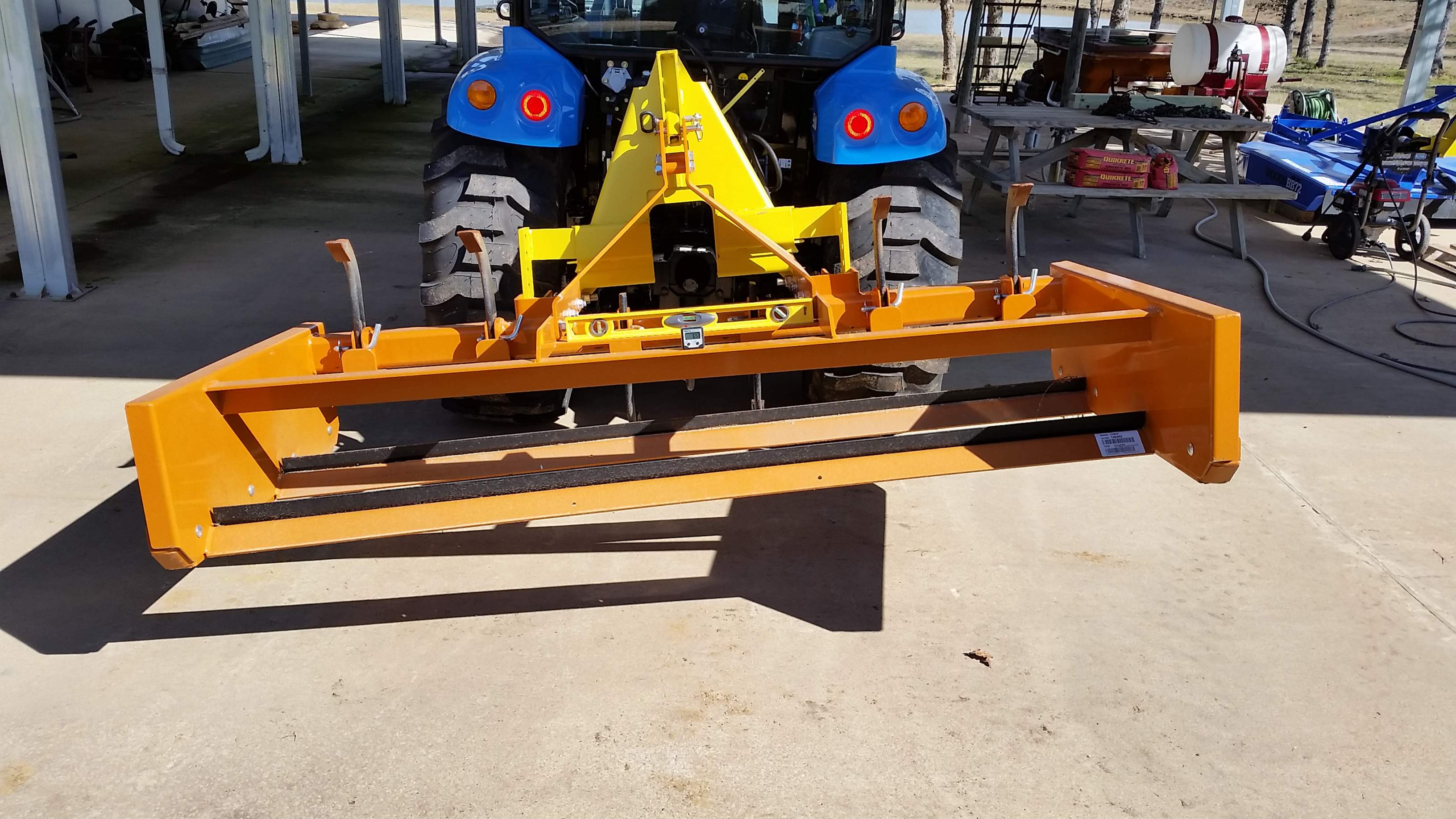

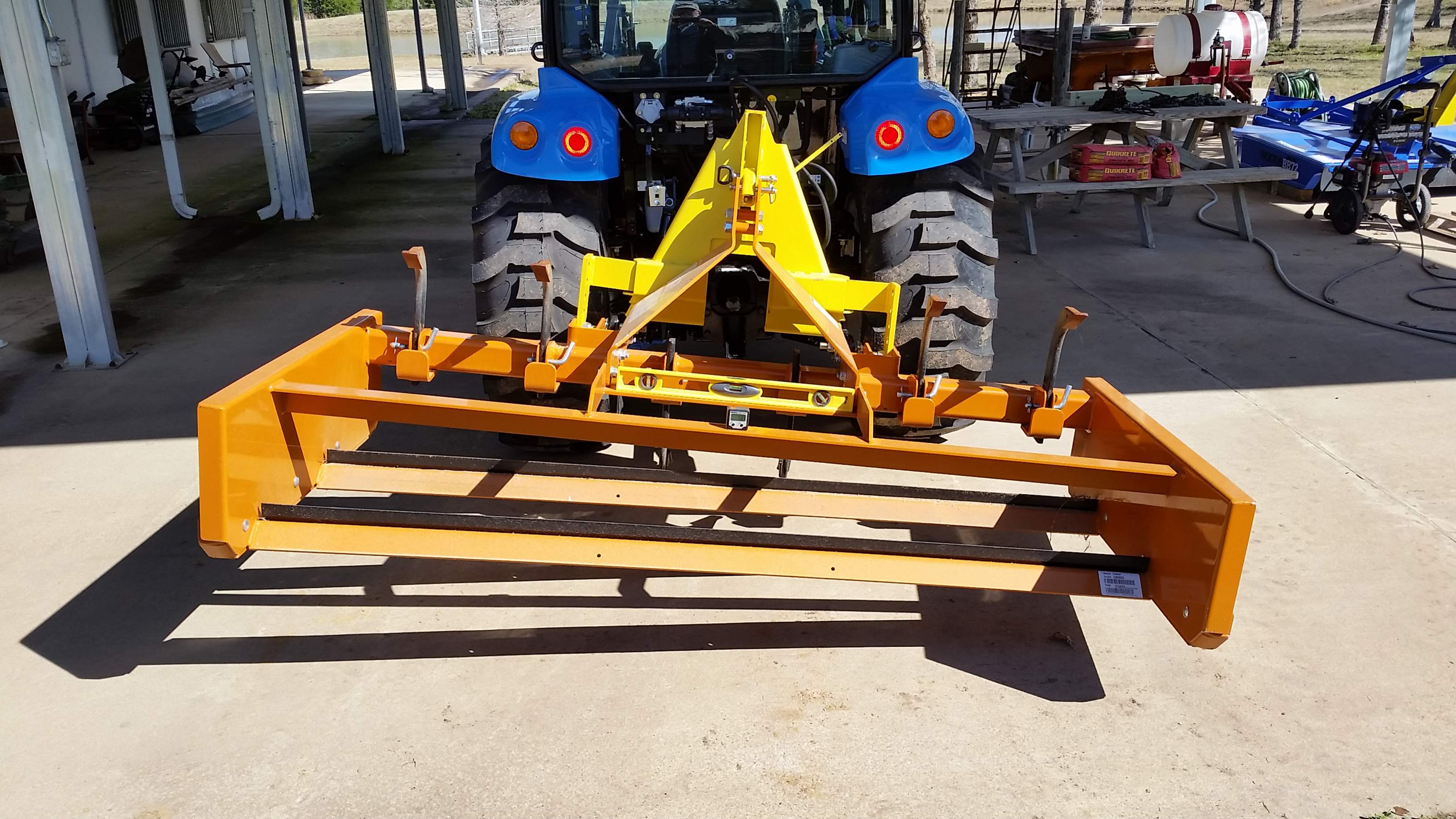

Next, I leveled the grader front to rear with the top link.

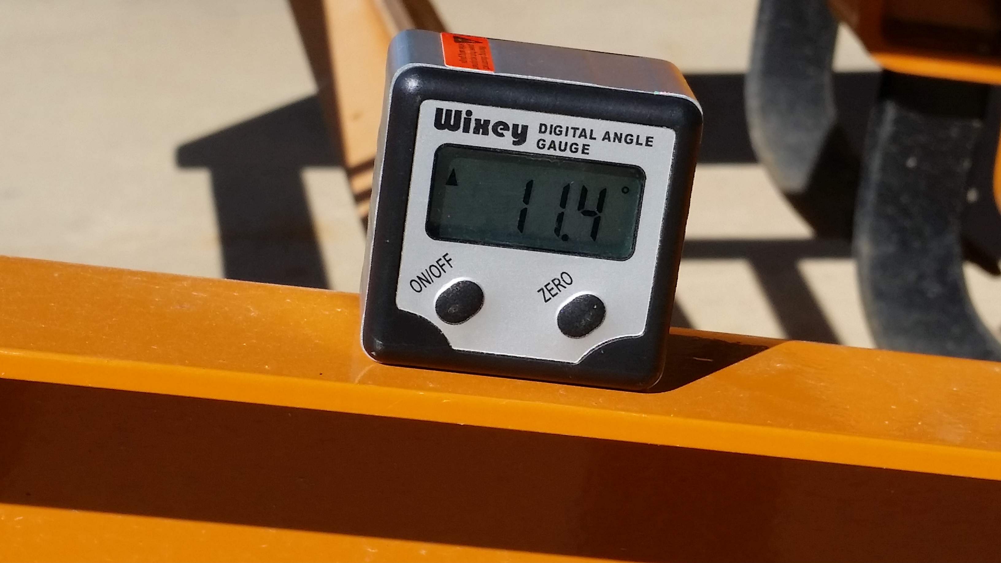

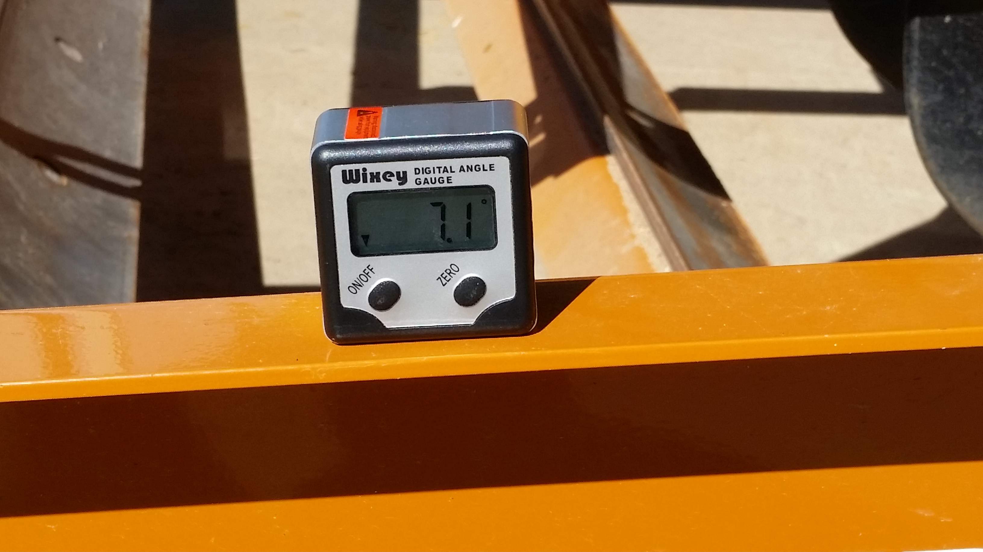

Completly extended and retracted the top link and measured 7.1 degrees to rear and 11.4 to front or delta of 18.5 degrees.
I am really pleased with this setup, the wide range of angle in both axis, and the excellent service from Fit-Rite Hydraulics.
The floor is open for questions. :)
