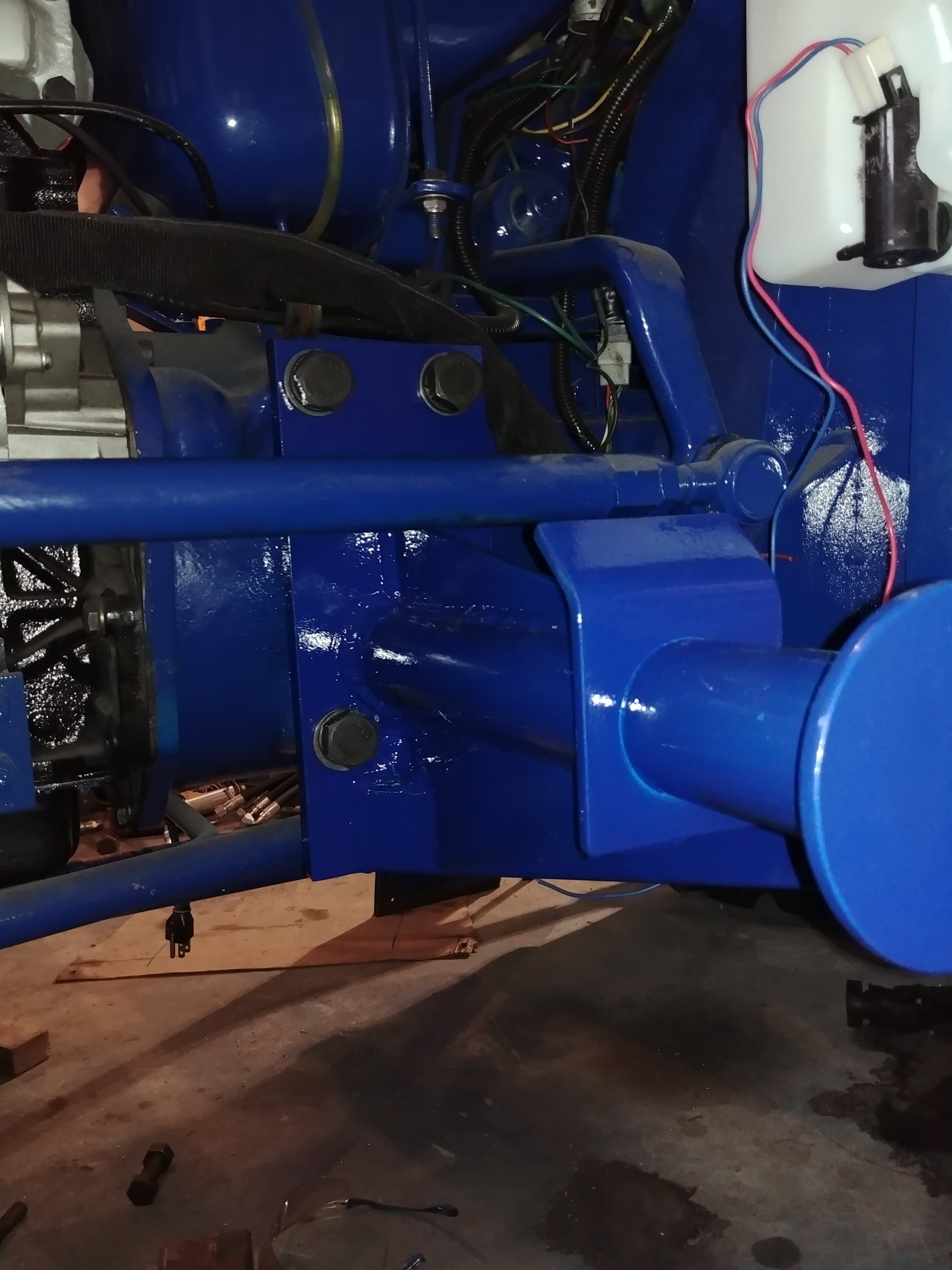

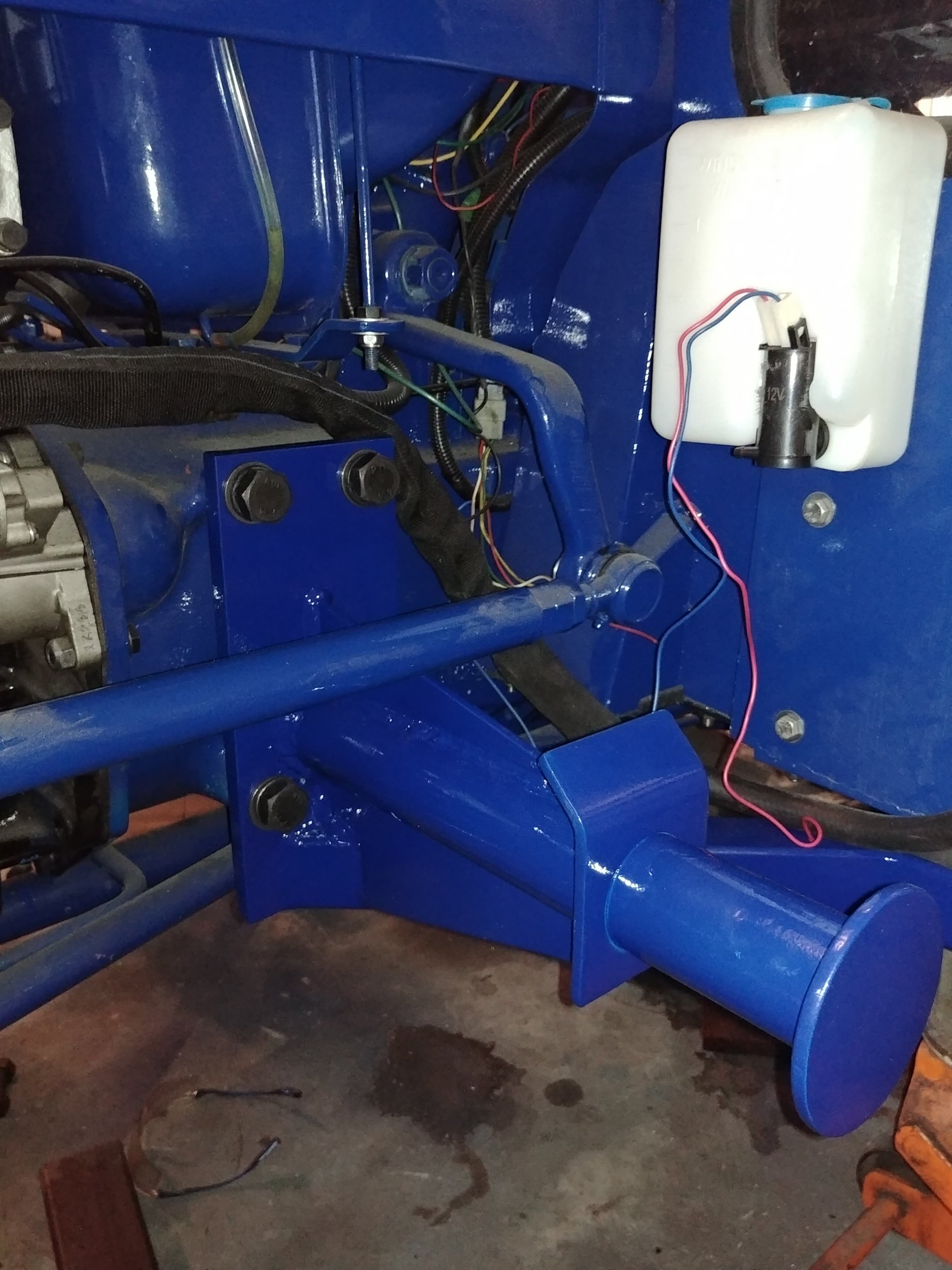

Well thanks.. it was a fun project.. but now its dragging on as I try to wrap everything up with painting etc lol.. I couldn't find one to buy so I just made my own. My right side looks identical to the right size. It clears the steering shaft with the gusset I made... I made my bar that support the uprights a bit lower though to clear the steering shaft yes. You can see mine sites a little lower in the bolt circle of the plate that connects to the transmission case.
The one in the picture you sent above looks like the front mount is on the back side. Look at the diagram I posted above which would be number 1 that goes on the front.
