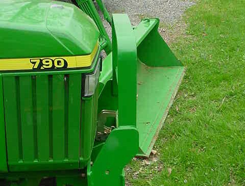

Roy:
I'm surprised you have to remove the grill guard to get at the battery. I have a grill guard on the 770 and can access the battery by tilting down the top of the grill, unhooking the springs and lifting the grill off.
They must have changed the design. Send a picture of the grill guard if you can.
Thanks.
And good luck again.
Joe
   / 670 is gone...790 is here
#13
Here's a close up of the guard. The 670 didn't have a guard, but I know what you mean (saw it in the manual).
It's welded solid to the front weight bracket. The tractor manual doesn't show it and the loader manual doesn't say anything about removing it to service the battery.
I'm sure there's a way to do it...just haven't figured it out yet.

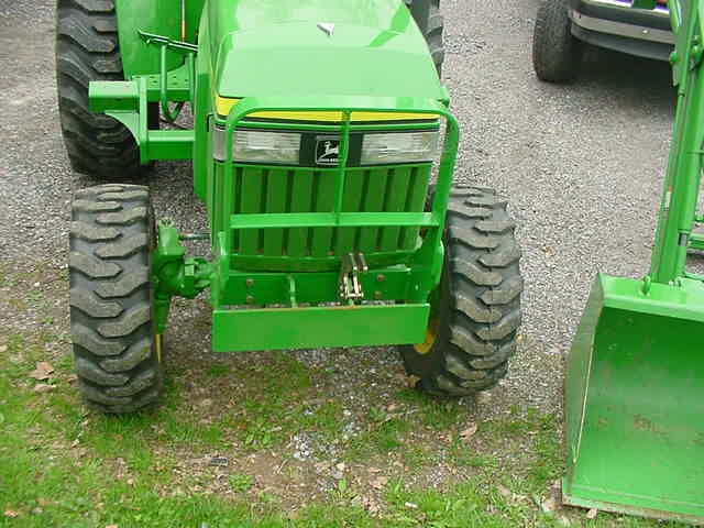

And a front view

Complete brain fade on my part Roy. I opened your pic thinking I'd see a nifty grille guard I could add to my tractor. I forgot you've got the 419 loader and I've got the 70. Completely different up front there.

I have a 790 with 419 FEL and getting to the battery is no problem with the guard in place. In fact, I have removed my battery (because of corrosion issues - a different forum) several times and replaced it with a different one. You can lift the battery straight out of its cubby hole. It's a little tight, but really no problem. You do have to remove the air cleaner, but that's a matter of just two bolts and a hose clamp. You don't even have to do that just to add water or check the battery.
You'll love the 790/419 combination. It is great.
