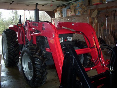

Purchased 6500 4WD, Farmi, and forks w/grapple. It is quite a beast, as shown in the pic. It kinda fills the garage.
Have 11.2x24 R1-Ags. on front. When turning right, the rear rubber of the right will rub on the side of the loader frame that bolts on the side. Same with left turn and tire.
Is there an adjustment to keep from this "oversteering"?

My 6500 4WD has the front tires all the way in and they have not ever rubbed. I'm guessing an adjustment problem. They are close enough so that I did not put chains on the front though.

read your front end loader owners manual. there is an adjustment on the front axle for that. just a jam nut and bolt on each steering knuckle

Since it involved the tire attached to the tractor, I actually did look in the tractor manual. Never thought to look at the loader one. thanks.
