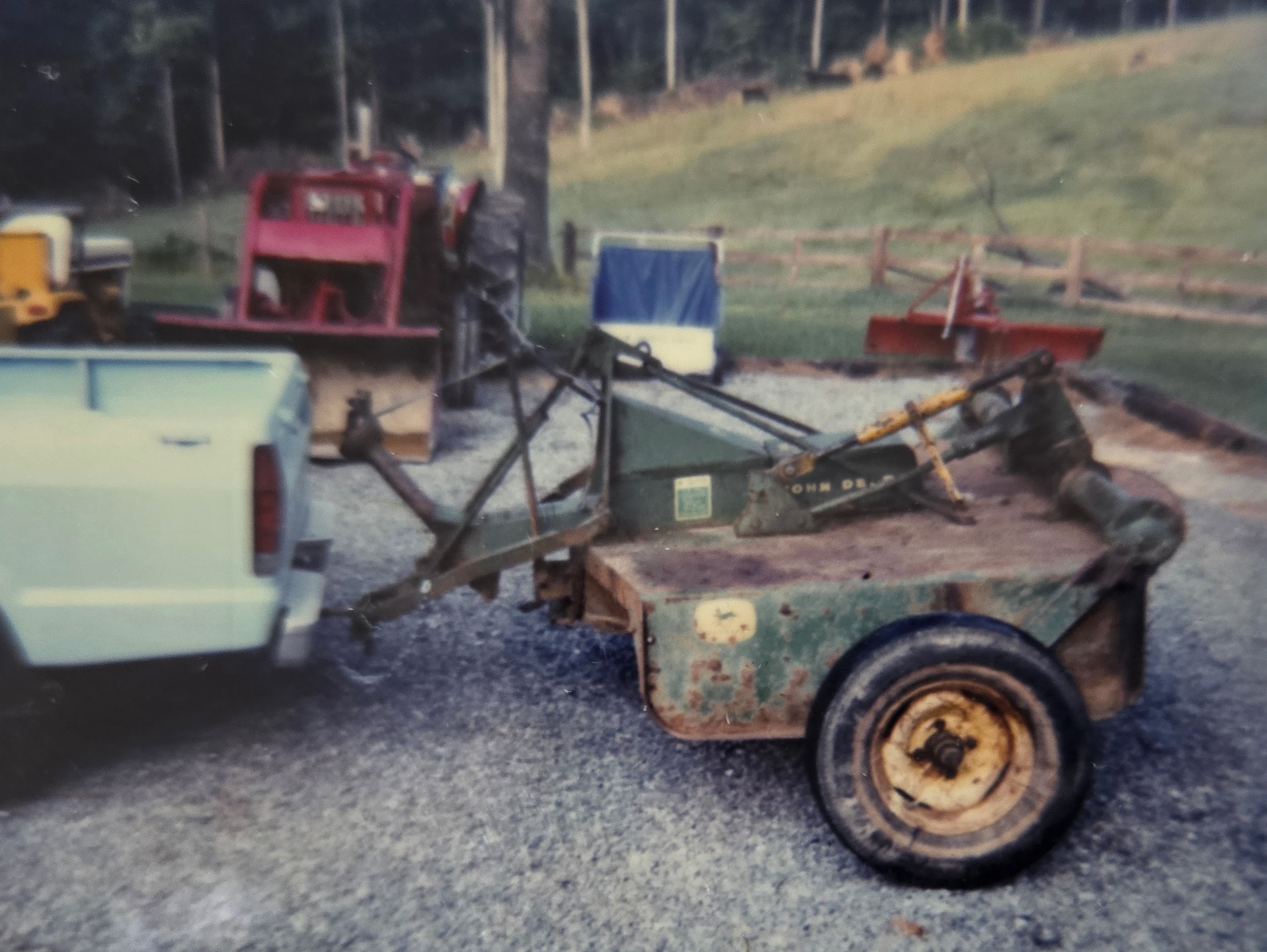

My first mower was a 6.5 foot bush hog,, ( John Deere )
I owned a 404 IH ( gas ) tractor then,,
If the grass was over a foot tall,, I had to pull the bush hog to the top of the field,, and only mow going down hill,,,,,,,,

   / 6' brush hog on a 30Hp tractor #9
It depends. You may have owned a heavy five footer, and you may be replacing it with a new light weight six footer. Making the handeling of you new bush hog the same as before. Now if you have enough horse power all depends on what to are going over, and only you know that. May be an opportunity to investigate a newer bigger tractor. What do you think. Blessings come in disguise
