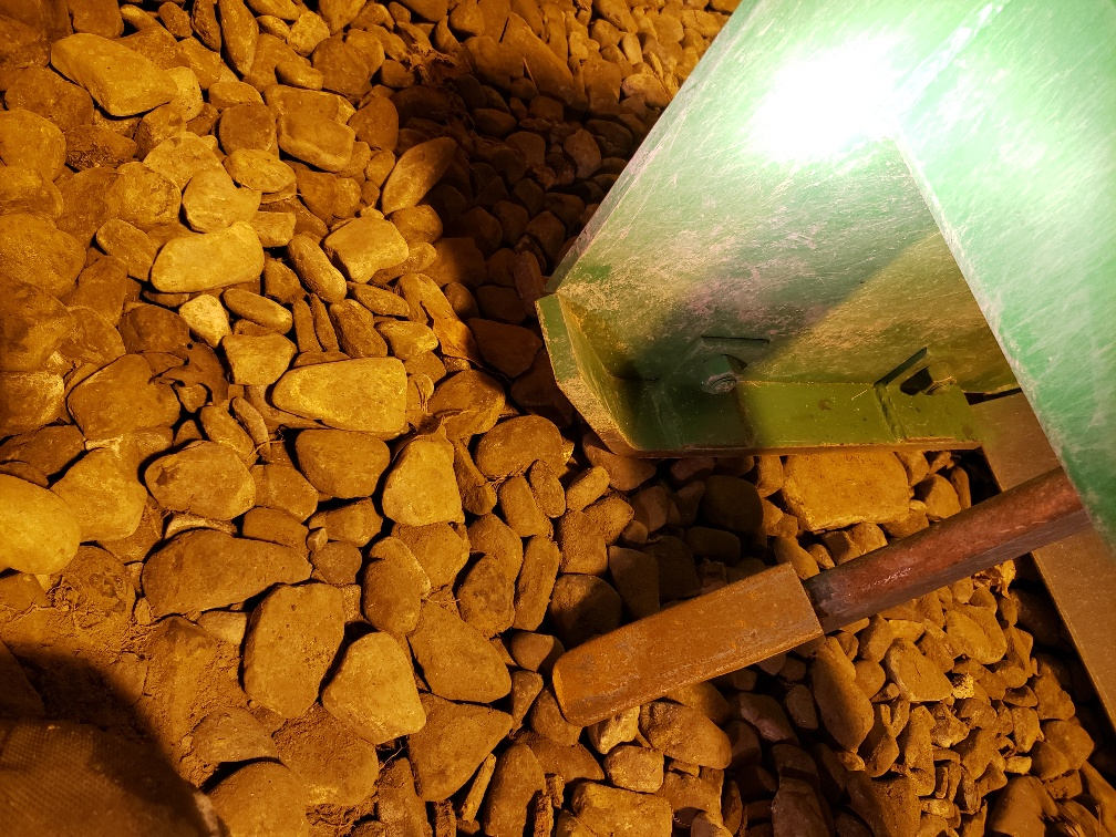

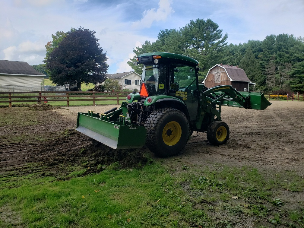

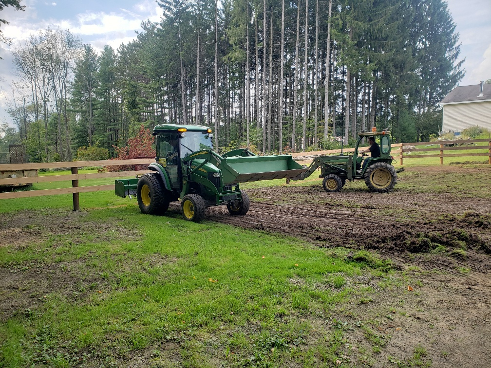

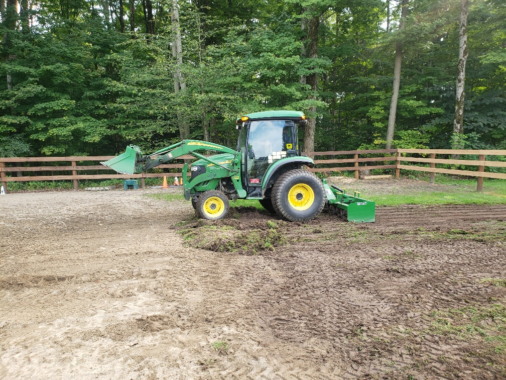

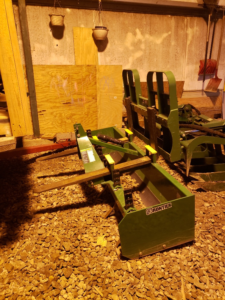

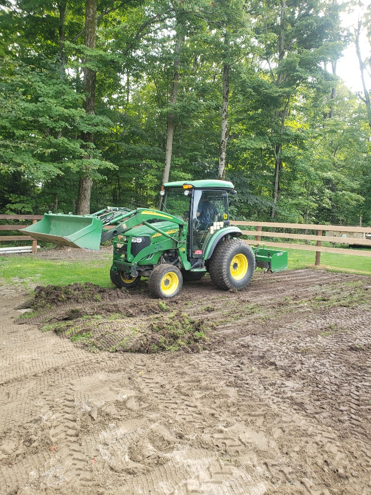

Somehow I lost the text on the above. I have a JD 4320 with 48 HP and 40 PTO HP hydro. I wanted a box blade that was wider than my wheel width of 72". I purchased a 84" Frontier Box blade in 2019. It cost approx. $1200 with tax. It is cat 1, it weighs 510 lbs. and is rated for 60 PTO HP or less. I use it to dress the road to my woods and to clean up the trails in the woods. When I purchase it I used it as bought. I viewed several you tube videos on how to use it. My ground is mainly clay with some rocks. With the chisels down one notch and can go approx. 20 feet and the box will be full. At that time I need to start adjusting the height to drop the excess soil. It makes it difficult to level my paths. To resolve that problem I added skid shoes to each side plate. They are level with the bottom of side plate and are .50 X 2.0" X approx. 18.0" long, see attached. This mod made it much easier to level my roads. The box blade no longer digs in and it only works up mostly the soil that the chisels break up. My neighbor has used it several times to level a building lot and his road to his sugar shack. He uses it on a 500 series JD utility tractor with no problems. My other neighbor asked me to help him make his hose coral larger. I scraped up the sod up on his new addition. Pictures shown. I also added fork pockets to the top of the box blade. That way there I don't need to make a 3 pt hook up just to move out of the way. I can just use my forks. Hopefully this verbiage explains the above pictures.
