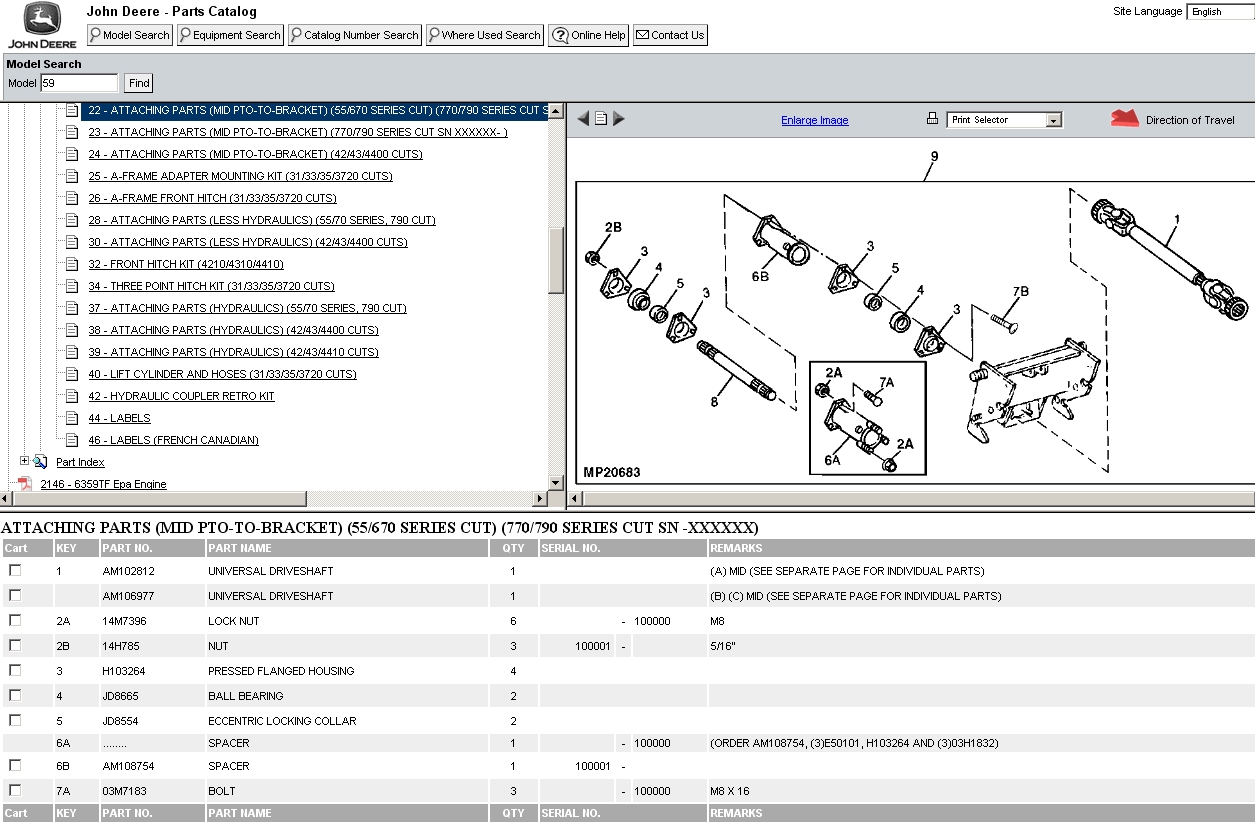

I've seen a couple of these pop up for sale around my area lately and it got me wondering. I know with the 380 blade, pretty much all the FEL mounts have to come off to mount the blade and vice versa. Is that the same with blower... do all of the FEL mounts have to come off before the 59" blower can be mounted?
