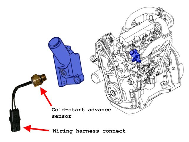

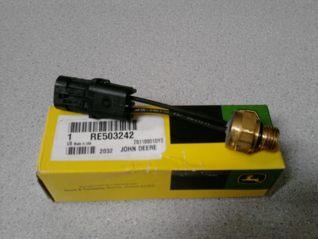

I believe the problem is the thermistor sensor (thermistors are temperature variable resistors used as sensors.). On the thermostat housing there is a sensor that is connected to a two wire harness that goes to the injection pump; this is the "cold start advance" portion of the system so it starts easier when cold by advancing the timing.
When the sensor on the thermostat housing fails it shorts out and blows the fuse. Try unplugging it, replace fuse and see if it starts and runs. The part # is RE503242, if you are quick changing it, you don't have to drain the coolant, just make sure it's not hot at the time. You will want a pan under the tractor to catch the coolant, so as not too have to clean it up.
Power never gets to the injection pump when the PTO switch is on before the tractor starts since it is a safety switch, that is why the fuse does not blow.
If you do a search of this site on the part # RE503242, you will find this is a problem on the 3029 engine.
URL to JD parts
jdpc.deere.com/jdpc/servlet/com.deere.u90490.partscatalog.view.servlets.HomePageServlet_Alt

Thanks a million guys! I'll try the bulb and the thermistor resistor. Could you explain the exact location for me, I don't have a manual. M not near the tractor now but finding a water neck is pretty self explanatory. Thanks again, ya'll are super helpful!!!
   / 5075E blowing start fuse when turning key #5
Please see attachment to help locate the sensor.
The 2 wire sensor is plugged into the top of the fuel injection pump. Just unplug it, replace the fuse and it should start.

The resistor went out on my 5303, it is a cold start advance, it will start & run unplugged. A word of caution, when you think it's tight, stop trying to make it tighter, it strips very easily as i found out & had to buy another one.

Thanks a million everyone, unplugging the harness worked perfectly and I have one on order. Deere quoted me $1700 for a new fuel pump, 3 different wiring harnesses, and the thermistor resistor harness and labor. All of you saved my butt! Don't have to worry too much about cold start, it's 90-100 everyday, coldest get to be about 50 but I'll have it fixed before season change. Again, thank you all for helping me and everyone else, you are true gentlemen.
