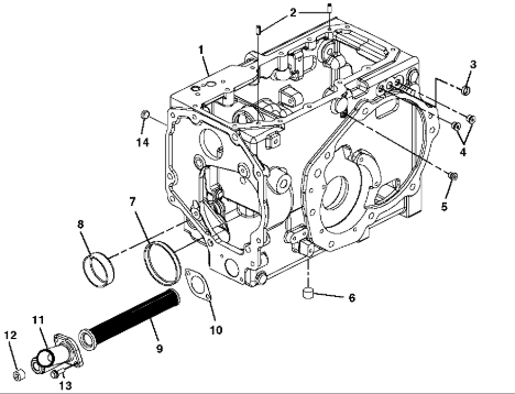

How long since sump screen was checked/cleaned?
   / 4410 hydrostatic/power steering wuestion
All fluids and filters changed, screen cleaned this spring. Tractor has 534 hours on it.
