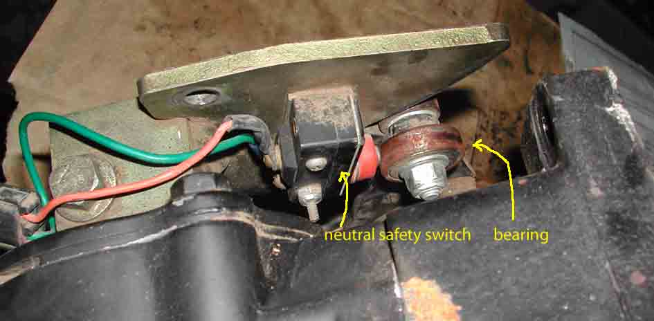

Eventually, it will fail and leave you stranded. There is no clutch, so no
clutch safety switch. It is hard to get in there, as mentioned. In this
photo, you can see the switch has been replaced once. It is gone now.
I have also jumpered the seat occupancy safety switch. HST tractors
are inherently very safe, as long at the go pedals return to neutral.
   / 4300 HST Nuetral Switch #12
dfkrug
Where is the location of that pic, in general? Shot from below or above? Or with what removed?
Thanks for posting, as I want to locate it asap. :)
And get it de-commisioned.

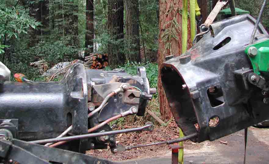

It is a pistol to get at with all assembled. That last photo is with everything
apart. This next photo shows more. To service the switch you have to
reach up inside the square hole in the bottom of the tractor. You can
disconnect the wire connector there, or trace it back to the left side and
jumper it there.
   / 4300 HST Nuetral Switch #15
Wow! Thanks for the pic.
I really like the backdrop shown in that pic. Looks pretty peaceful and all. :D
