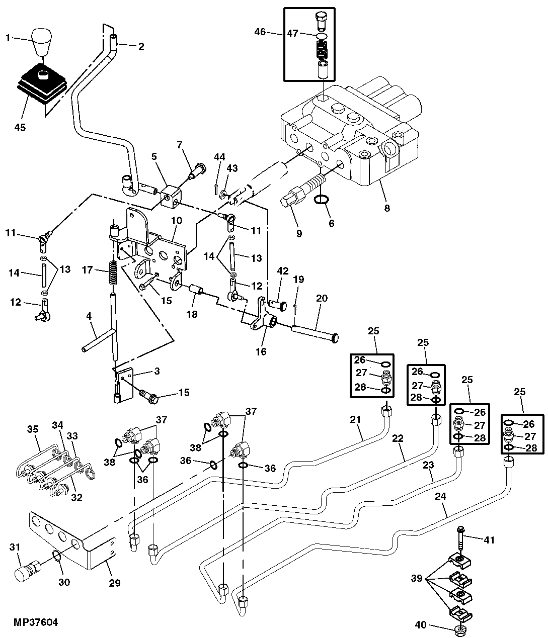

is it normal for there to be a dead spot when curling the bucket on a 420 loader (4300 tractor)?
sort of hard to explain, but here goes:
when i have the forks on, and a load, the forks will drop when i move the joystick to curl up. from 'neutral' to 'active', there is a dead spot that allows to forks to drop, but moving further left, it hits 'active' and lifts. the problem is, that with a load on the forks, it is difficult to go from 'neutral' to 'lift' and miss this dead spot. if i move the lever too slowly, there is a point where the load is dropping, and if i move too fast, the load could be suddenly jerked up as i go from not moving to moving rapidly. the loader operation is sensitive, so this makes it even more difficult.

I don't have that tractor/loader combination, but that behavior doesn't sound normal to me. It appears that hydraulic pressure is allowed to "release" from the curl hydraulic circuit as you are moving the scv lever from the neutral position to the curl up position. If it gets any worse, that is also a potentially dangerous condition, as it could cause you to unexpectedly drop a load while driving forward.
I guess you reseated all your hose connections, and inspected for any leaks around the SCV and the lines to the curl cylinders? That would be the first things to look at. If all that looks ok, I would put a pressure gauge on the line for the curl up function, and monitor the pressure as you move the lever in the curl up direction just to see what it is doing. Although, if it really needs a heavy load to show that problem, that might not give you a true indication of what is going on??

Not really...there are "load checks" in the valve that are supposed to keep this from happening-they keep the pressure on the port as the valve moves from neutral. It's part number 43 in the diagram. Do you have the service manual?

of course i read it...just didn't understand why under some weight, it works fine but over a certain weight, it does not. also wasn't sure how part #43 had anything to do w/ 'load check'...i didn't want to bother you with stupid questions until i tried some other simple things 1st.

Part number 46...:eek: Sorry about that.

ok, that's what i thought you must have meant, but wasn't sure. is it possible for this check valve to work fine w/ 200lbs on the frame but get 'forced through' w/ 300+ lbs?

Yes-it make perfect sense, and yes-it's very possible, more weight=more pressure it need to hold.
