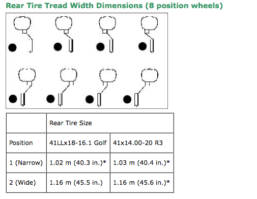

Does anyone have photos of Turf tires on a 3x20.
I'm looking for a photo of the width of 41LL but 41 reg
would be ok too. Thanks

What would a photo of the width show you.. ? What is the difference between "41LL and 41 reg" ?
Are these sizes shown in the operators manual for the 3120? Hope someone can help with what you want to find out.
   / 3x20 #6
41LLx18.00-20 = 41" Outside Diameter, 18" Section Width, 20" Rim Diameter - Often referred to as Golf Turfs
41x14.00-20 = 41" Outside Diameter, 14" Section Width, 20" Rim Diameter - These are the regular Turfs
