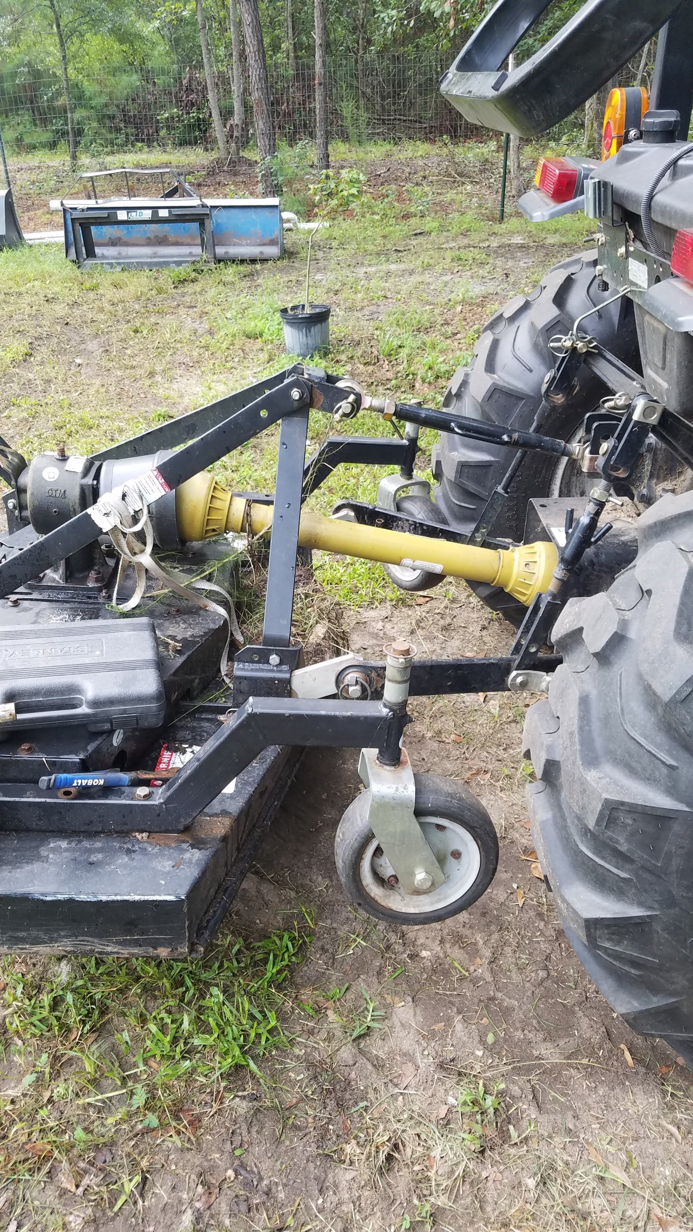

For the record, a quick hitch could help since it moves the mower back about 4" but you need to make sure that your PTO shaft is long enough and still have at least 6" of overlap. If it doesn't, adding a pto extender or pto override clutch will do the trick.

Thanks everyone for the quick help!!
Thanks for the heads up with the quick hitch and the solution for it!
I'll make the changes tomorrow and take some new pictures.

Just a follow up. I got one side off. The bolts were on there good and I "had" to go buy a cordless impact wrench. The other side is still stuck on there but here's a picture of the difference it's made. Still need to grease and make the other adjustments, but we're getting there. Thanks again!

I have 3 different finish mowers and as soon as i saw your pictures i knew those front wheels were on wrong, even if you get it fixed right a pats quick hitch will be a welcome addition to your tractor , Makes changing implements a 5 minute job instead of 20.
