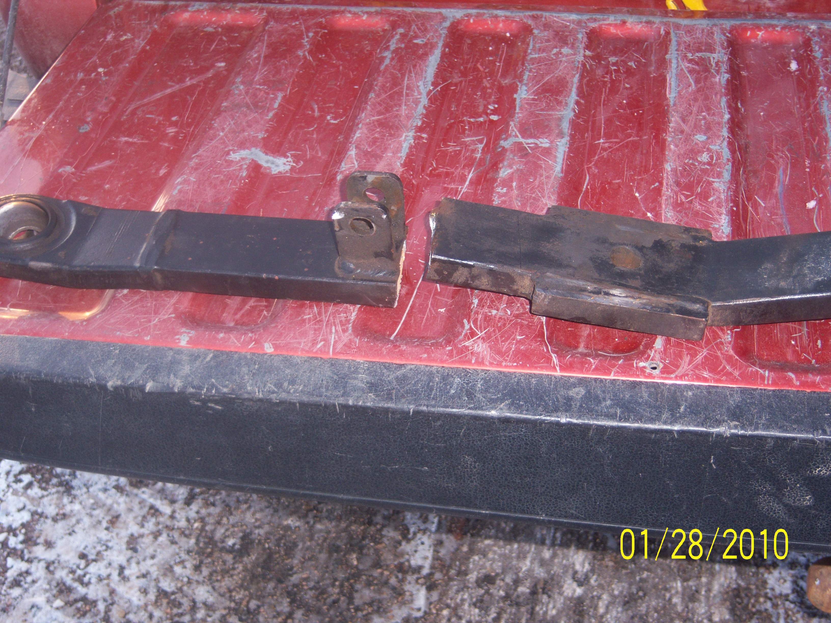

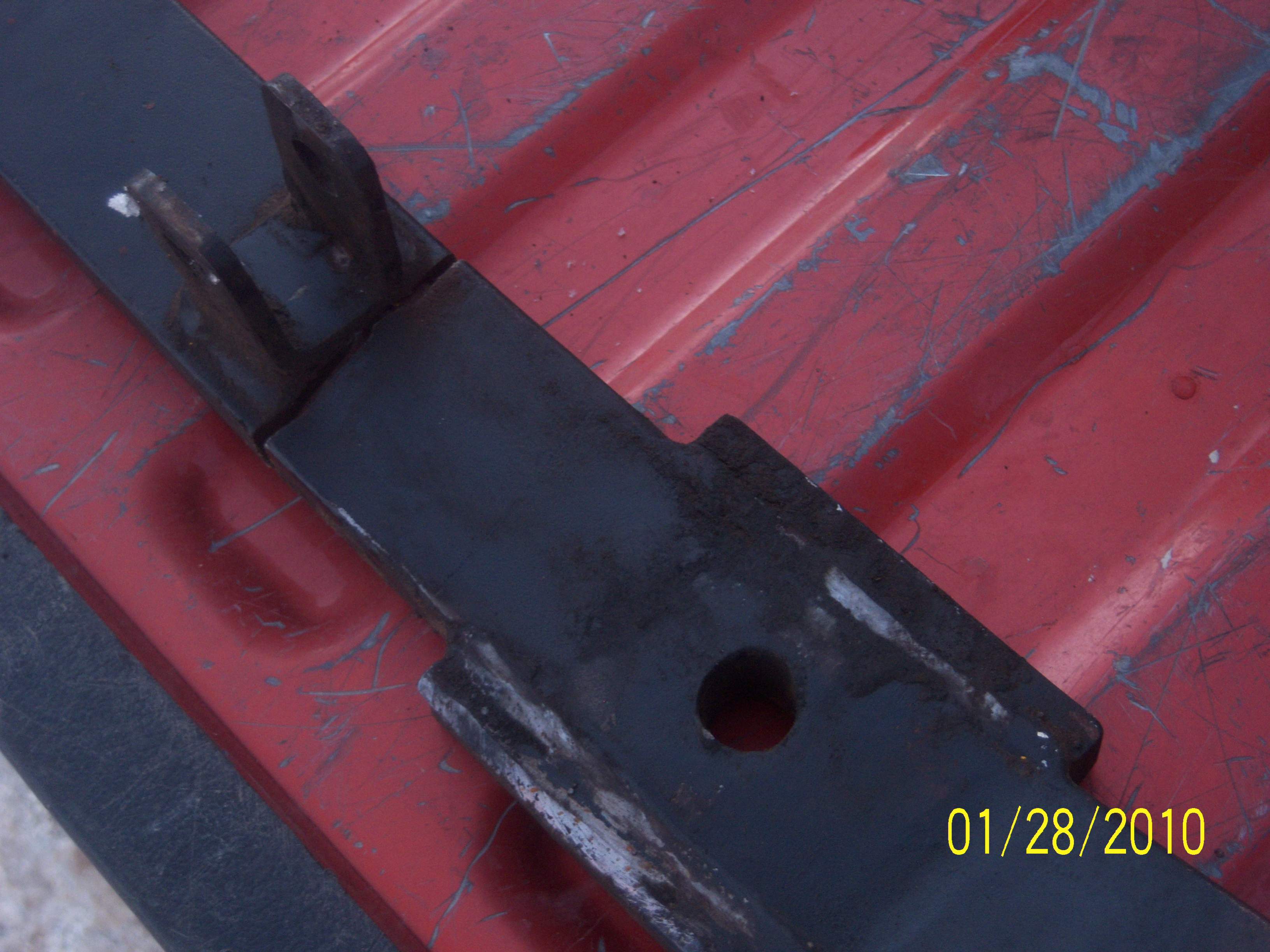

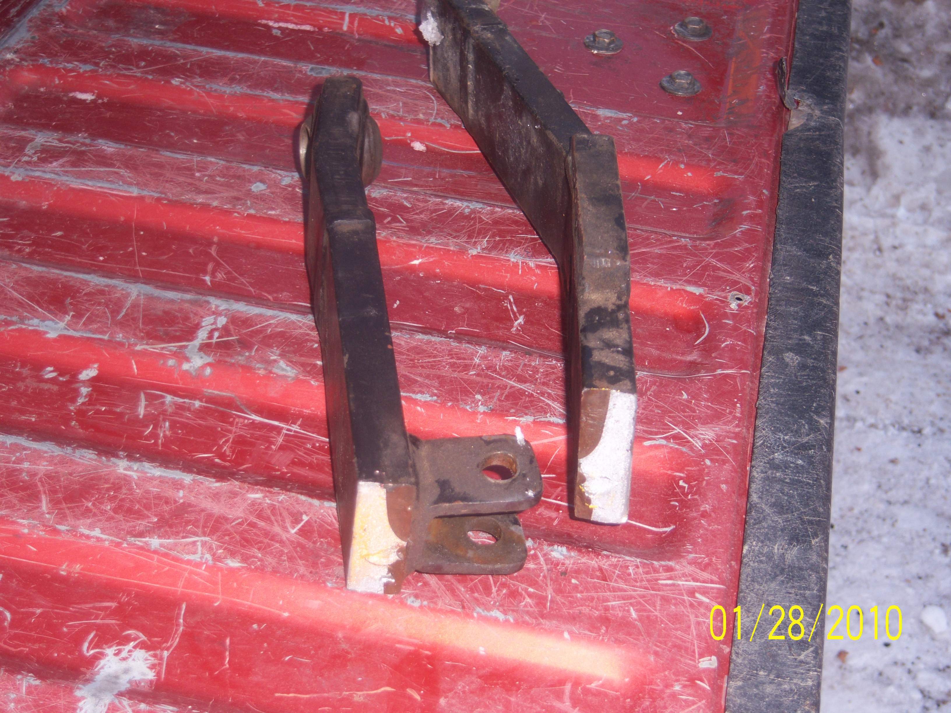

Here's a pic of the broken link.

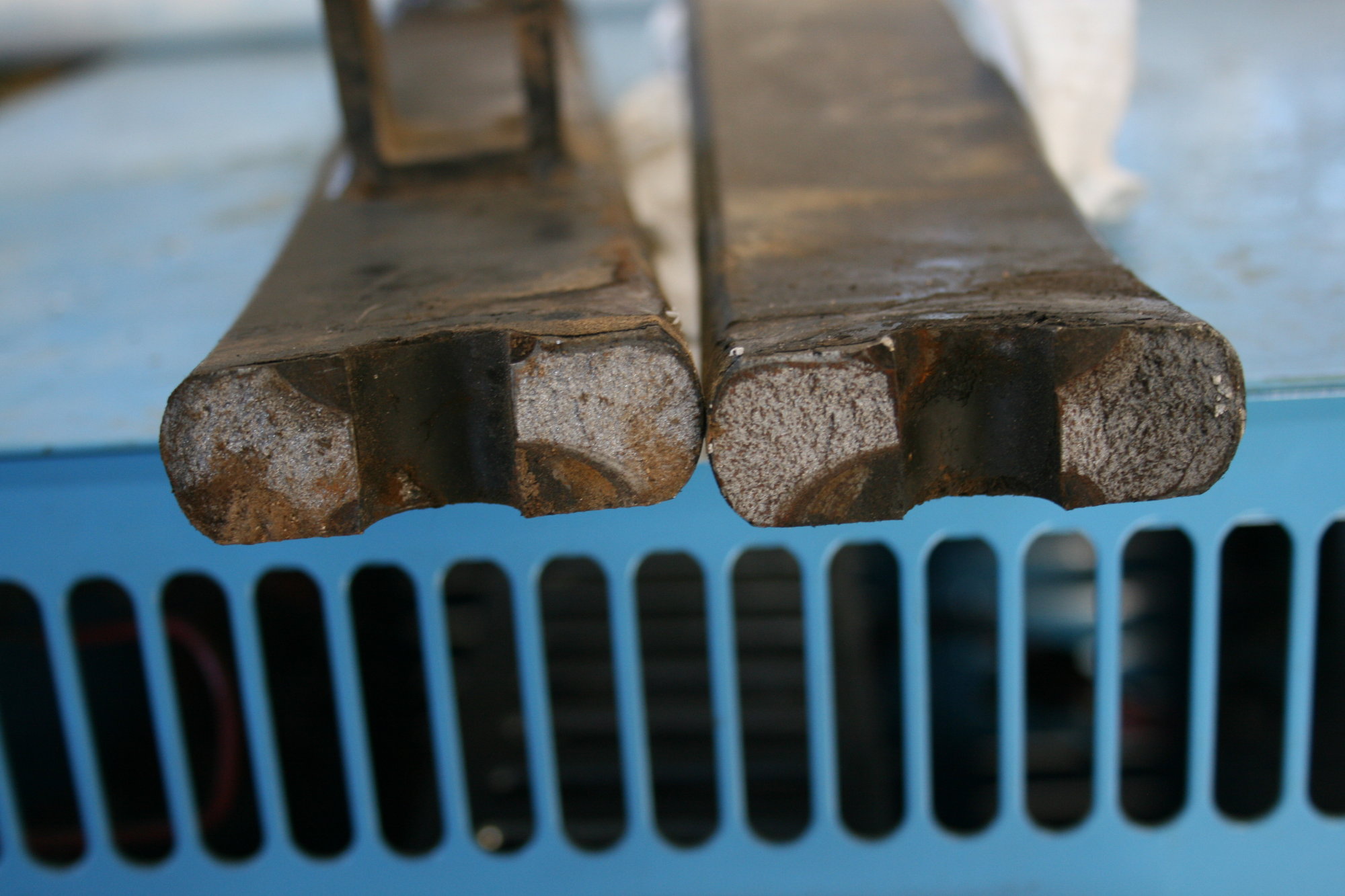

Here's a picture of my broken arm. This one had already broken and been welded at the pin hole. As you can see it it not a completely fresh break with the rust evident on the rest. I went by the local dealer but they didn't have any 3000 series on hand so couldn't compare to the newer style.

   / 3pt draft arm broken-3720 #33
Man both of those look like some pretty crappy China smelting pot metal castings.
They use to use that junk for the old window weights.
Definitely not something to build a critical strength application part on a high end tractor with. :(
I'd probably still just weld em back together, if replacements weren't any better or very expensive.

   / 3pt draft arm broken-3720 #36
From the dark, shaded area it appears to be a defective casting. The rust appears to have spread outward from that -- and then you just plain broke the rest of it!!! :rolleyes:
I don't recall or not if your dealer offered to cover everything under warranty (or just good customer relations) or if you had to cover the expense.
Glad to hear the new design is heavier duty.

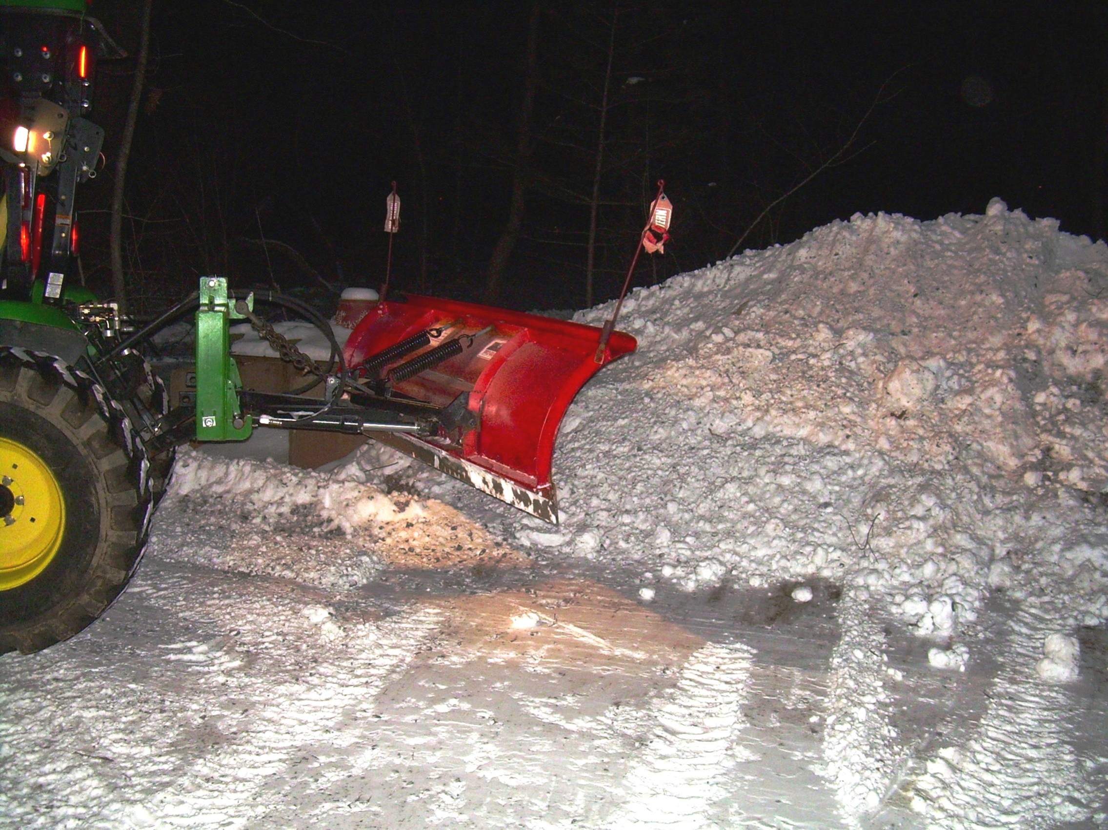

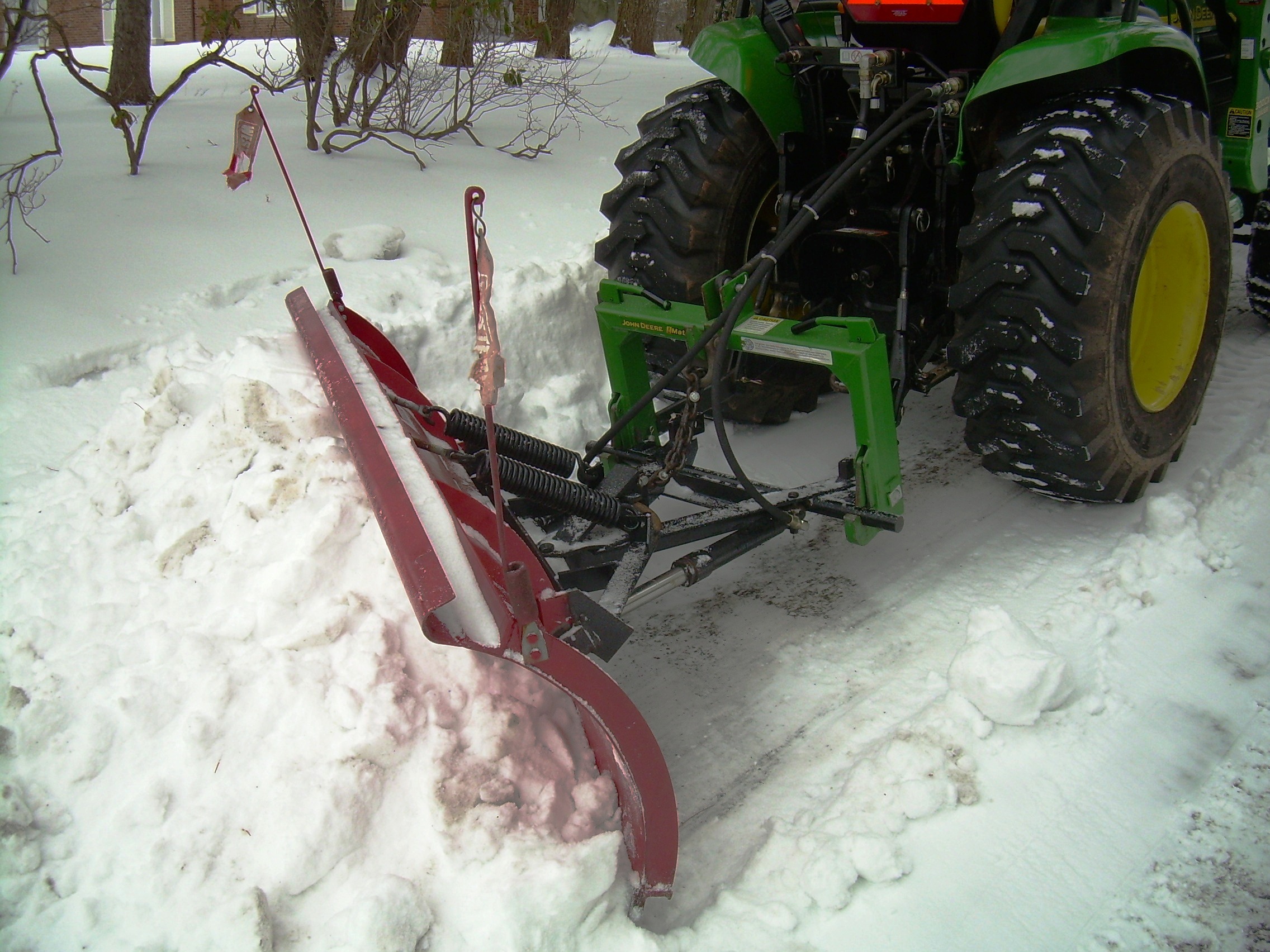

By their design and intended use they should be able to take a beating with out this much drama.
I did bend mine, but that was from ramming snow banks in reverse with a modded truck plow mounted to imatch.
Most would say not an intended use for 3 pt :eek:
JB
