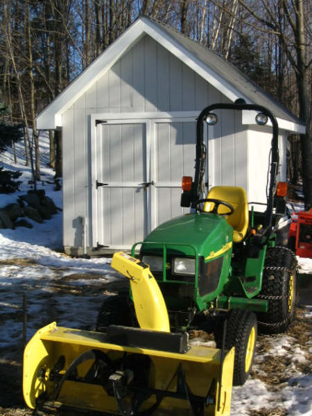

With perspective to the lift and RB..

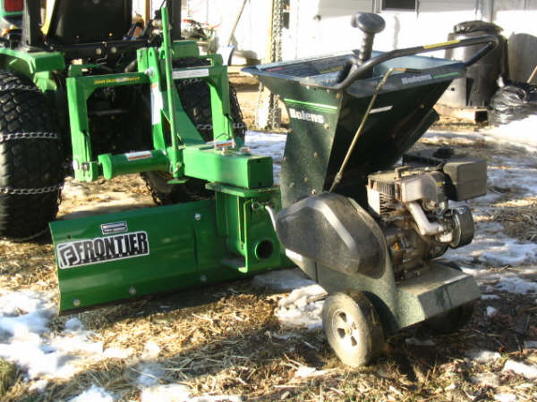

Re: 3PH \"Cradle\" for Chipper/Shredder
Another angle...

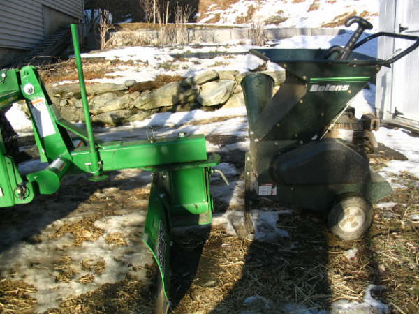

Just a shot of the 4115 w/Blower and the last project (shed) I built BEFORE I had the help of the loader, backhoe, and blade (shovel, iron bar, etc. much less fun). That stone wall on the left (not a good view) was built from stones from the area of the shed...I said this land is a bit "rocky". /forums/images/graemlins/tongue.gif

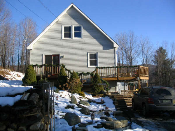

One last pic...This is the deck I built about 12 years ago. All the holes for the posts were dug by hand, the excavation for the 6X6 PT steps, the 20' long PT 6X6's carried by hand (dragged is more like it) ...... would account for the shoulder surgery /forums/images/graemlins/frown.gif What idiot would build a 40' long, by 12' to 10' wide open deck in snow country??? /forums/images/graemlins/confused.gif

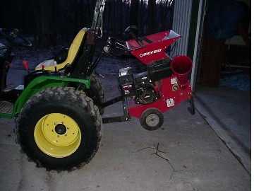

Hey, what are you doing with my chipper? Seriously, if it was red, it would be identical to mine.The angled face on the base of the unit is where I bolted the drawbar(parallel to axle). I used hooks off old broken motorcycle tie downs(2nd generation pack-rat and proud of it)to hook onto handle on shredder hopper with top link. Will post pics hopefully tomorrow.
   / 3PH "Cradle" for Chipper/Shredder #37
I also have the same chipper and you can forget about attaching a tongue. I put one on my chipper but the wheel tread is too narrow to and it keeps tipping. The tongue might work OK if your property is perfectly flat. Another problem is that the oil drain is right where you need to attach the tongue.
The carryall works well but Bluemule's setup may be better because of the bottom discharge.
