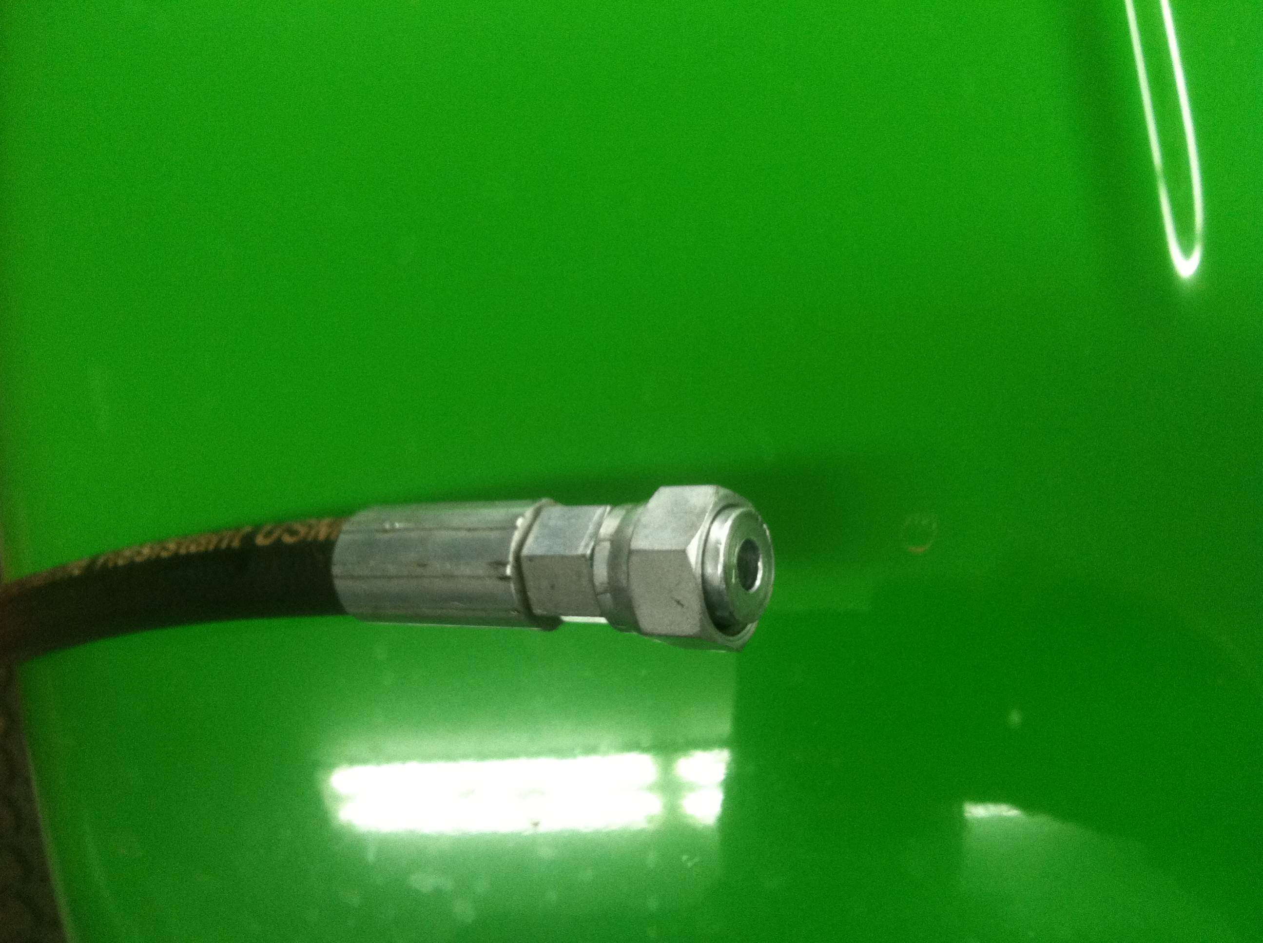

I just broke a hose on my loader and before I pop for a 70.00 hose I am wondering if there is anyway to reuse an existing fitting? I have been everywhere except Deere looking and cannot find a hose sold with the type of fittings that is on the loader end of the hose.

I have a 2011 JD3720 with a 2011 300CX Loader I was able to get a new 3/8" hose and the correct connector to the tractor itself. I am having the problem with the fitting at the loader. The following is a photo of the fitting I have an issue with. IMG_0192[1].jpg

Forrest am I correct in saying that you bought a new hose, and you are
having a problem w/ the end you have pictured? If I am correct, just
exactly what is the problem?

The fitting you pictured is a ORSF female swivel. ORSF= O Ring Face Seal, the fitting it attaches to will have an o ring. Measure the diameter of the threads of the male fitting and I can tell you what size it is. I'll bet it's a size 6
If you bought a hose with the wrong fitting, an adapter might be available. Post what size and type is on the hose and what size is on your loader.

If your hose has JIC 6 female swivel. Discount Hydraulic Hose has an adapter,
FS6504-06-06 $2.64

The fitting is a crimped-on fitting and is not re-useable. You'll have to have a new one crimped onto the new hose.
By the way, is the problem with the pictured fitting (female) leaking or is the problem with the male O-ring end? Or just a damaged hose?

I actually damaged the hose. I was able to get a new hose at Farm and Fleet. With the answers everyone has provided I think I can get the issue solved now. Thank you.
