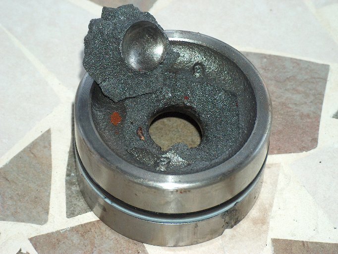

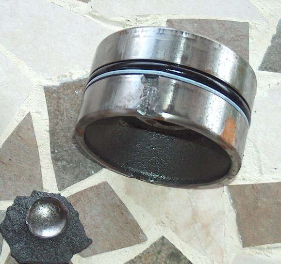

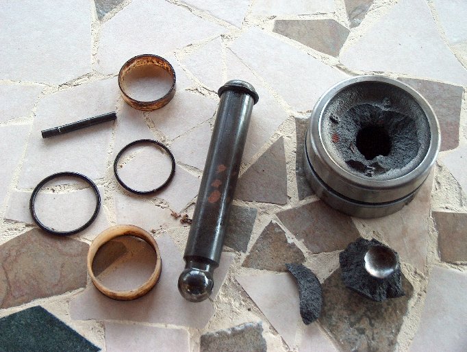

Well, the tractor is repaired. I haven't got the bill yet, but it won't be pretty. Here's a pic of the part that failed. They say it was out of adjustment. I have no idea how it could have been. It must have been right on the verge of overtraveling all the time since I got it because nothing had moved and the rod was never touched. I haven't talked to the service manager yet. I will after I get the bill.
Kevin

   / 3 point problem
The cost of repair wasn't as much as I thought it might be. Labor was $520, parts were $103, and pickup/delivery was $85 plus some odd and ends for a total repair cost of $757.36. The piston cost $50 and rod was $22. They honed the cylinder and saved it.
Kevin
   / 3 point problem #8
I'm really curious about what appears to be rust on the cylinder and the rod. Did they have any comment on that? Maybe the rust occurred after removal.
   / 3 point problem
#9
I believe you are correct. I wiped it with a paper towel and most of it came right off. It's been a week since they were removed.
