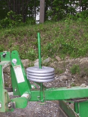

Ray,
I run a rear blade all winter with the 47" blower and often during the summer with the 410 FEL. If your rear blade is like mine (has a 1" rod with foot as storage foot), try sliding 25# weights on the rod. I add 100# but could easily add 200#. At that distance from the 3PH, it is sufficient ballast to offset the 410's bucket full of pretty much whatever you can put in it. Just my cheap solution. Also gives pretty good down pressure on the RB, when needed.
