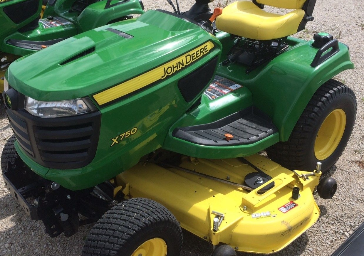

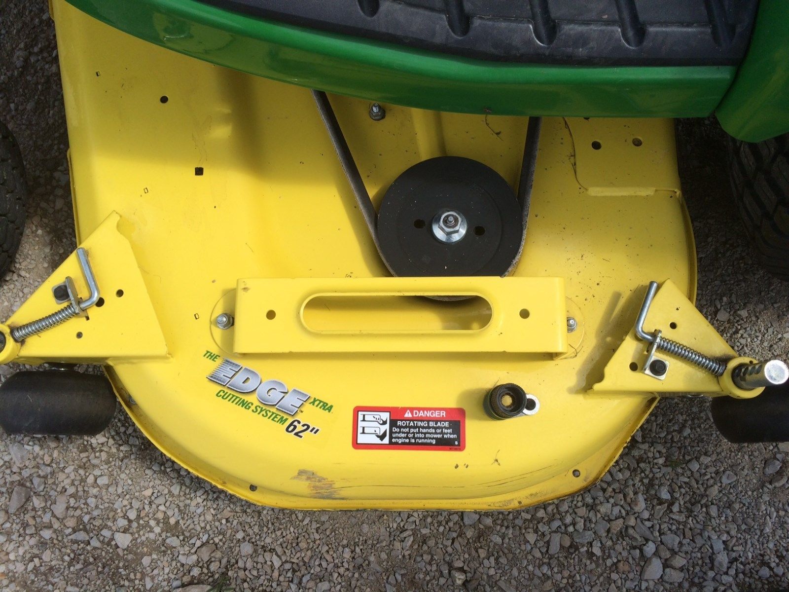

Here are some pics of the deck attached to the 2016 x750. The deck is called an "Edge Extra Cutting System 62 inch." Are these a poor choice for a deck? I hear good things about an 7 gauge deck but I don't think this is it.

that is the same deck that fit the X475/x595 up thru the X728/48 series tractors,
as well as the 2305 scut... seemed ok for most, but there are always some unhappy
people with mower decks no matter which deck.
that deck in the picture is either used, or has been used on demo (quite a bit, and missing
a guard)
i own one, use it occasionally alongside my zero turn mower, both cut the grass and spit
it out the side so i can't say one is better than the other!
and no, it's not as heavy as the 7iron.

You have a 62C Deck it came on my 720 Tractor and cut very nice . To remove the Deck the Gauge wheels turn and lock to the side and it rolls out from under the Tractor . It is not as easy as the drive over Deck but works well .

So is that "Edge Extra Cutting System" deck a HC or C? Does the HC stand for high capacity?
Can a the ramps for a drive over deck be added to this deck? It looks like there are bolt holes for something in that area.

I think the 62C is a high capacity Deck I know it is a Very good Deck and I would be happy with one in place of the 60HC . As for the Drive Over not sure the X 750 is a heavy Tractor I would talk to your dealer first . If it was me I would not even think about it as the 62C it as good and almost as fast to remove . I have a good size shop and a lot of room to remove the Deck but I will also never have the Auto Connect again .
