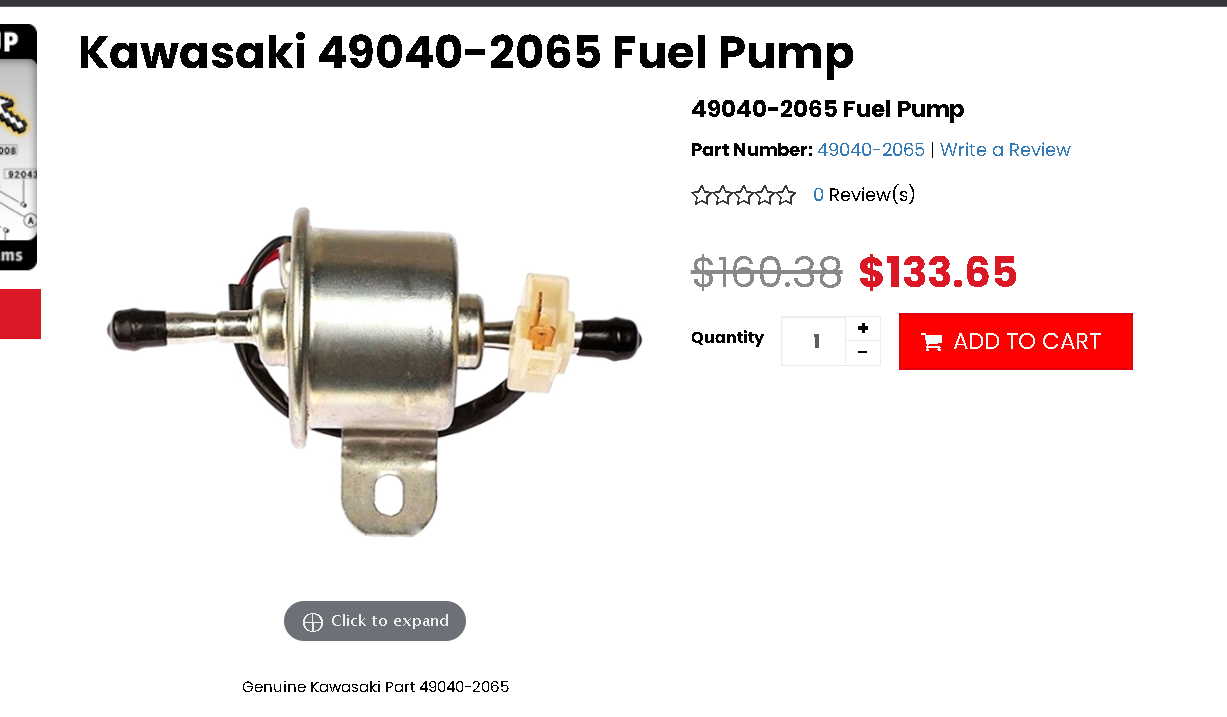

The OE looks to have the correct connector, but for $116 more lol.
