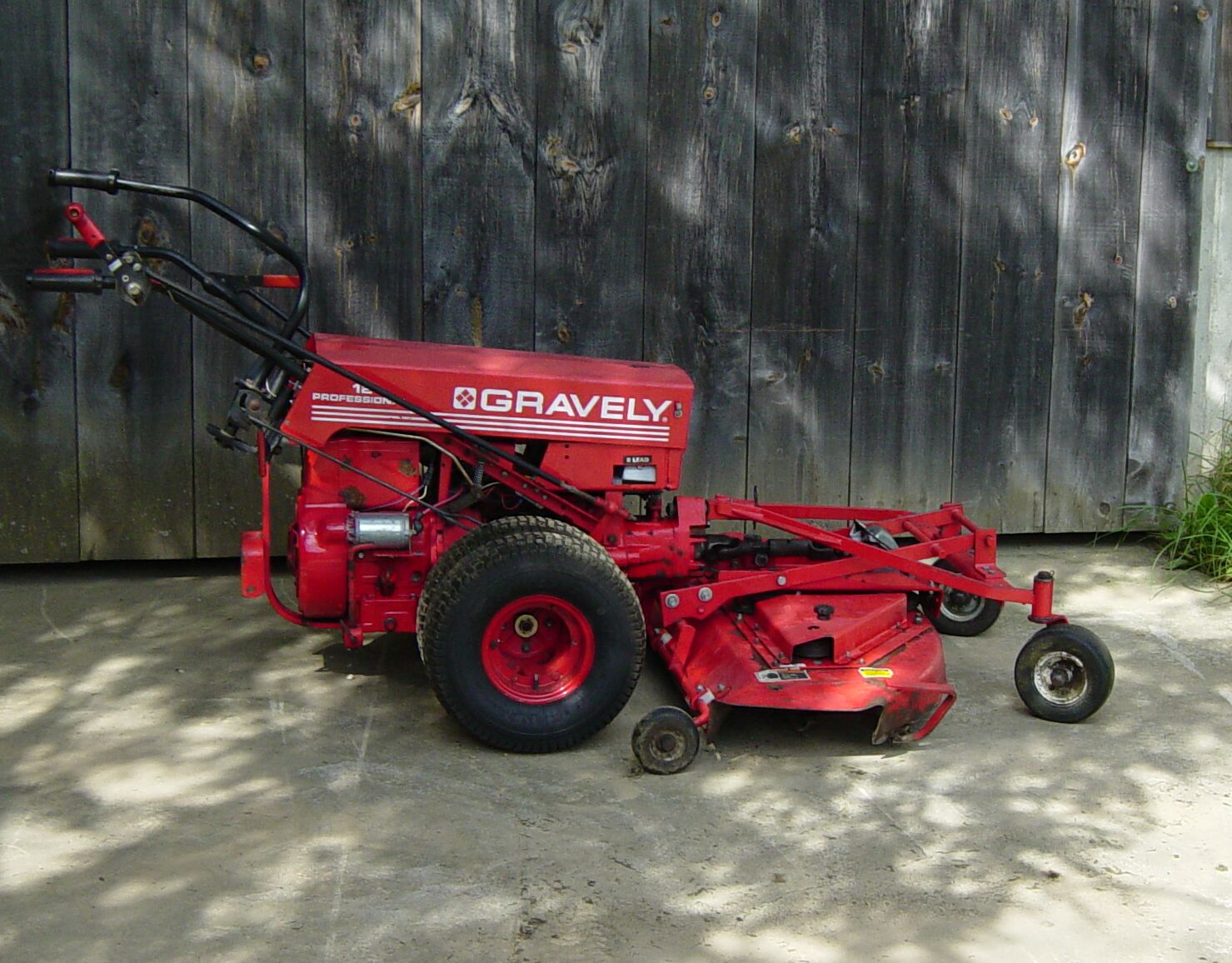

I kind of, sort of miss my Gravely Professional 12 Kohler, but also don't. It may have done a lot of work, but it was a LOT of work on your part to do that. And if the thing hit something, you risked broken ribs from those steering handles. I cut the front out of my brush cutter with a plasma, so i didn't have to go over brush to cut it. That was fine until I hit a stone and shattered the drive shaft in the mower. Nothing to do with my modificaion.
Also, cutting uphill, can be extremely dangerous, when doing back and forth type cutting. If that thing comes back at you, in neutral, you better be able to move fast.
Selling photo, with finishing mower. Go Transit (Ontario Commuter Rail) used these extensively, which is where I got it. I bought an adapter that allowed me to use all kinds of old attachments.
