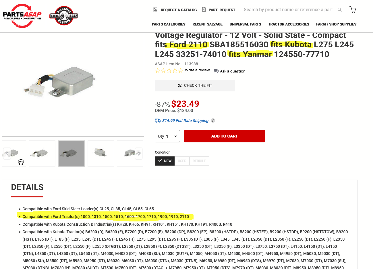

This is the old type, 4 or 6 spade terminals
This is the solid state
Most of them are made by Hitachi, Denso, or Mitsubishi Electronics.
Your p/n = SBA185516030

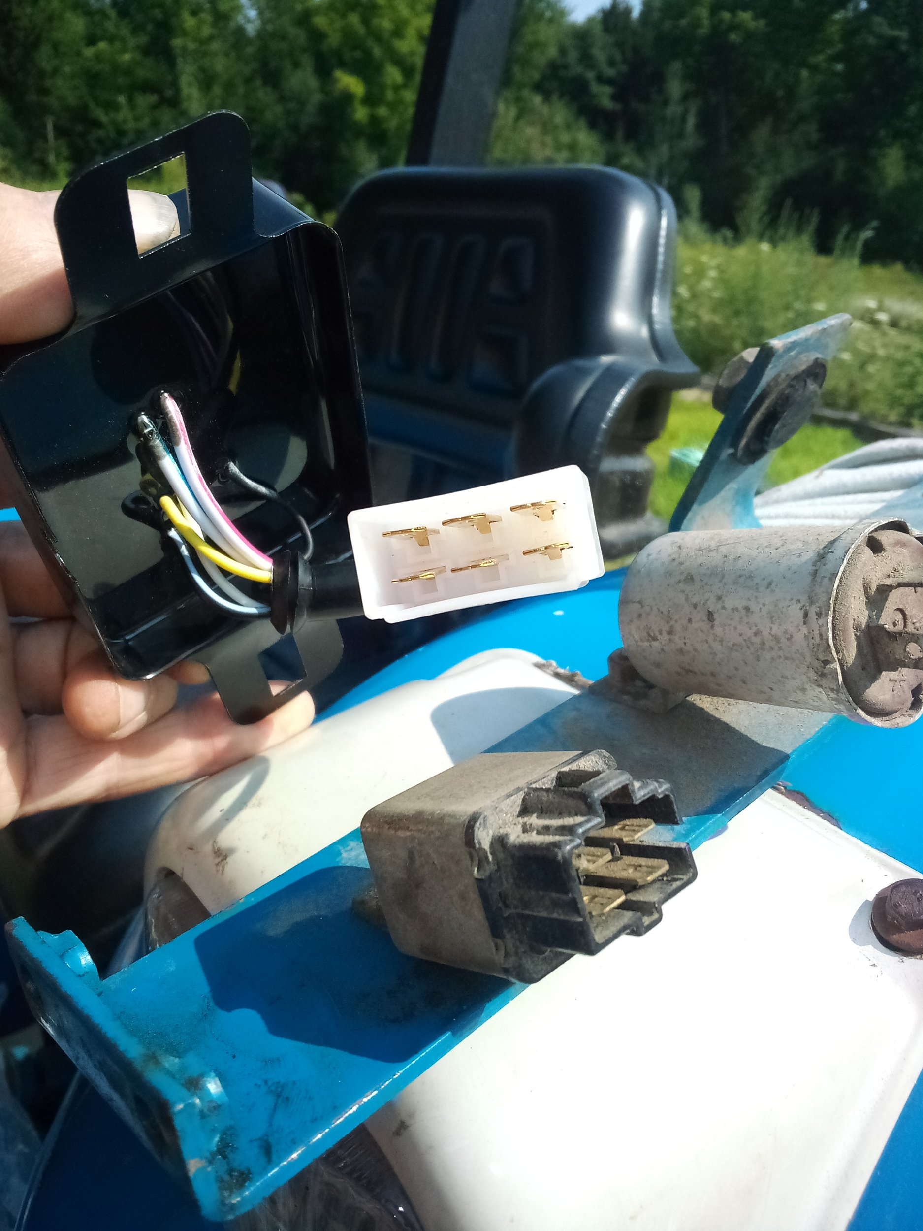

Mine has FOUR blades, and opposing plug. I really don't want to cut the original wiring and guess which wire goes to what.
If anyone has a parts list/manual, would you share the original part number, please?

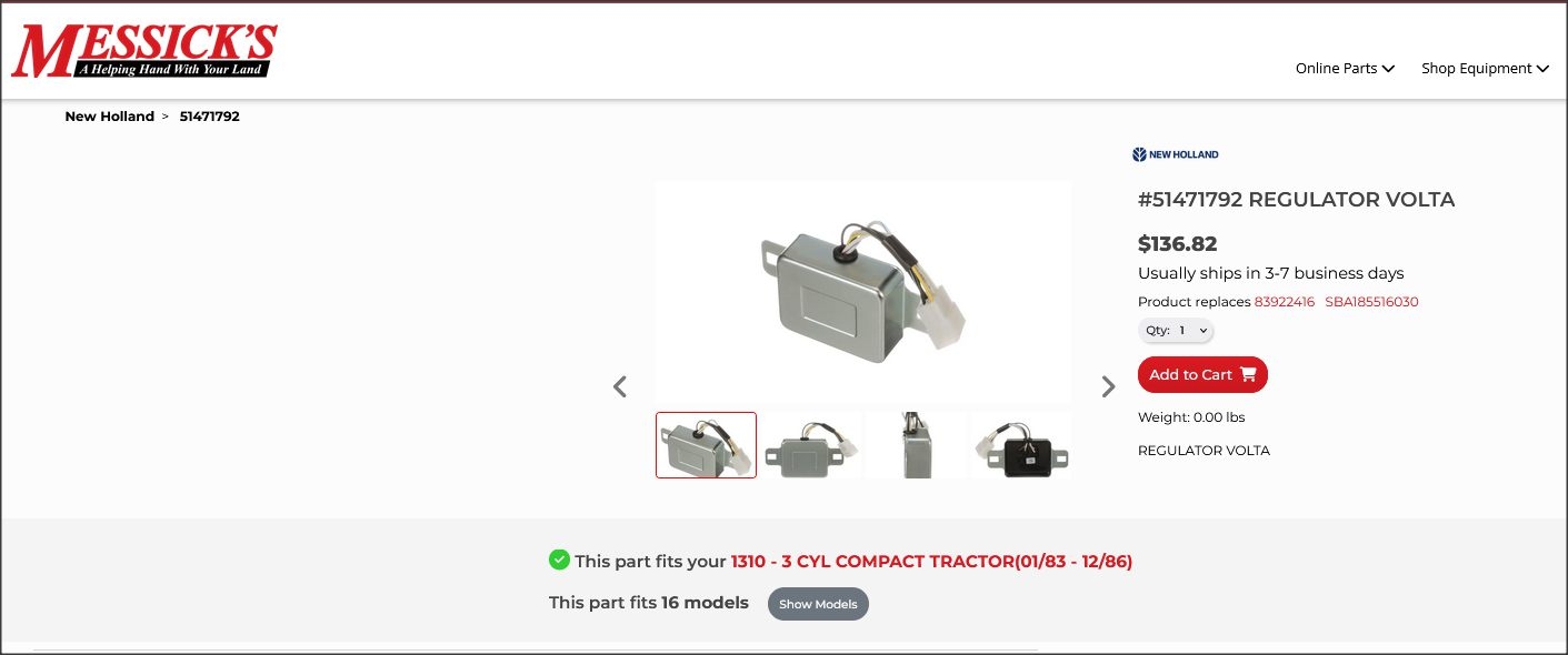

According to Messick's this fits 86 Ford 2110 and 15 other models, including my 86 Ford 1310
Are you sure it's 86 model - they were produced from 83 to 87 according to tractordata.com
Maybe check the serial No. and give their parts dept. a phone call.
PS. You called it Shibaura (Ford) - was it originally sold as Ford or?

/ 1986 Shibaura (FORD) 2110 Voltage Regulator ?
Ford made three separate era's of the 2110. (dates of manufacture determine parts)
Mine IS a 1986, verified by the serial number.
The problem is A.I. has copied all the WRONG part numbers and advertise them as the "correct part" for my tractor. THEY ARE INCORRECT.
Everything on the web has been corrupted, so I guess I am searching for someone who has the actual manual in their possession to find the OEM part number.
Thanks for trying.

In the photo above, the white 6-blade connector is what they send out. Just below (same photo) is the voltage regulator which came on the tractor, and is a 4-blade.
/ 1986 Shibaura (FORD) 2110 Voltage Regulator ? #11
Fredricks has the jumper harness to go from 6-balde to 4-blade. I wonder if Len can get that too.
There are two types with the 4-blade connector, with or without internal didoes.
All of these typically fit all of the know Japan made machines from that era. And many Mazda, Nissan, Datsun, Toyoda, etc too.

/ 1986 Shibaura (FORD) 2110 Voltage Regulator ? #13
The 6 prong replaces the 4 prong. I can supply the 4 prong
/ 1986 Shibaura (FORD) 2110 Voltage Regulator ? #14
Can also supply the jumper wire.
