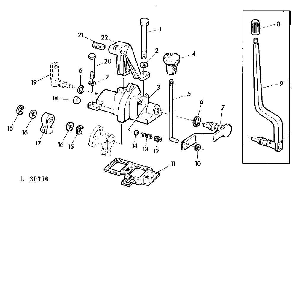

YES your tractor has hyd ind pto which is designed to be controlled by lever with yellow knob between gear shift levers. The 2 bolts that red arrows point to are not test ports. Those bolts hold pto control valve assembly on top of trans shift cover. Evidently the way the yellow knob lever moves easily back & forth in your video the detent springs in valve are broken or AWOL. I agree with jd110 that 2030 such as yours that were built for European sales didn't have PTO DISCONNECT lever on LH side of trans case.

You need to remove the steel cover that has the shift pattern sticker on it to access the test port plugs. To the LSFT of the RIGHT shift lever (speeds 1-8) is a hex plug. This plug is for the PTO Clutch test port. FORWARD a couple of inches is the PTO Brake test port. Adapt two gauges, one to each port. You are looking for approx. 140-160psi for early models, 125-135psi for later models, at 2100rpm. When you move the lever, one port should go to zero, then the other port show pressure.
Another test you can do is apply compressed air to each test port. Tractor NOT RUNNING!! If either does not hold pressure, most likely cause is broken internal line or leaking clutch pack or brake apply piston.

Key 12, 13, & 14 are the dentent for the PTO lever. You should check that the ball has not been lost or the spring broken.
