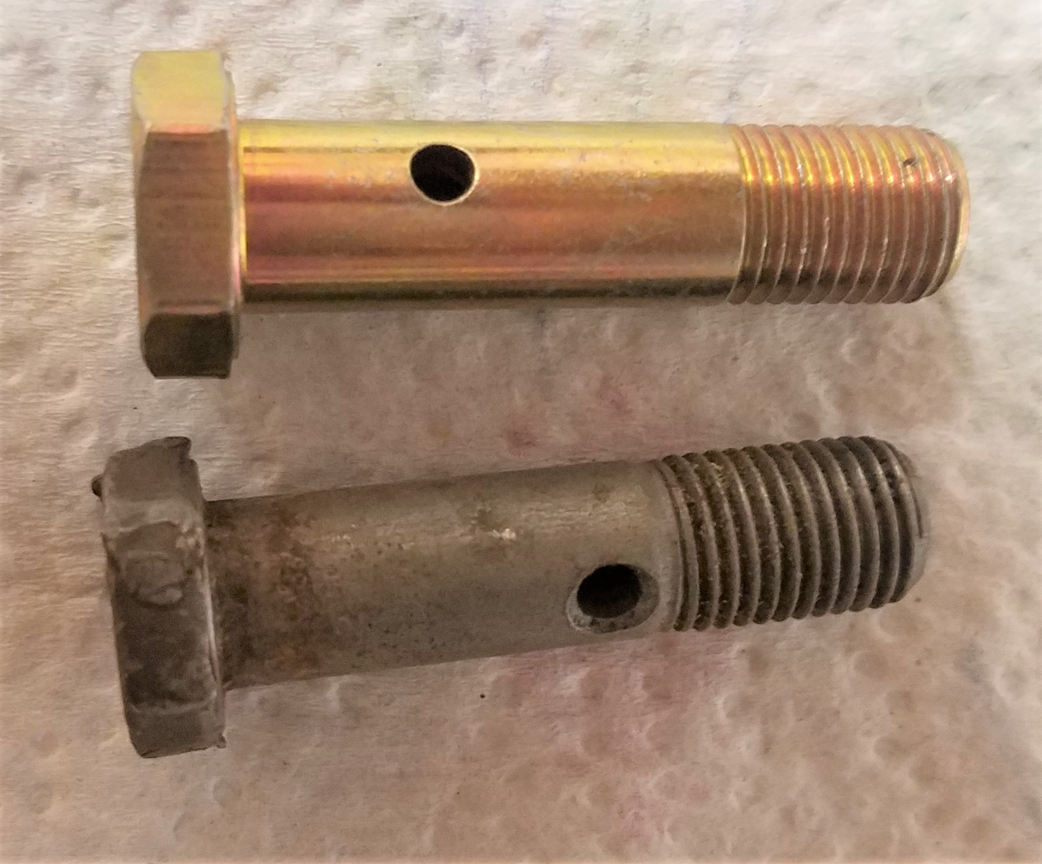

Were you able to get your fuel issue resolved? About 20yrs ago, I had a similar situation occur after replacing the fuel strainer and mounting bolt at the carb.
The replacement strainer and bolt were the generic replacements sold in the chain tractor stores for Ford.
After installing the new strainer, the tractor would only run for a short time and then starve for fuel.
It turned out that the inner recess fuel "groove"of the new strainer did not align with the fuel hole in the mounting bolt. It would only let a little fuel trickle thru slowly and the motor would quickly run out of fuel and die.
If you recently replaced the strainer and/or bolt, or if the strainer orientation is different from original, you might want to check that the strainer inner groove and bolt hole are in alignment
Heres some pics that show the difference I found on my the two strainers and the fuel mounting bolt holes. The two mounting bolts have hole locations that are visibly quite different.
Hope this helps

Thanks for your input, I did check that and found it OK. Seems like most of the problem was recurring contamination from a gas tank sitting for a long time, it's running well now.
