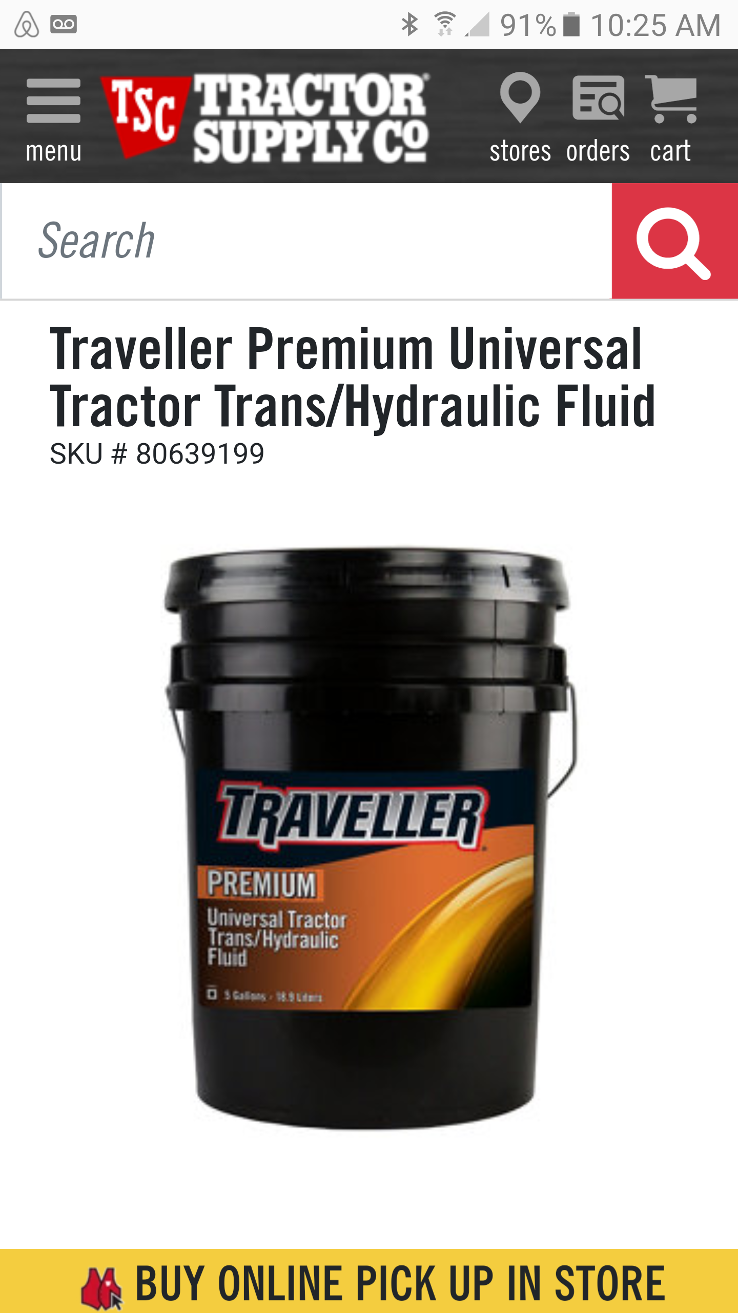

Does anyone know if this hydraulic fluid is ok for my 1710?

I use the same. Traveler has several formulation. Make sure Ford 134a is on the compatibility list in the back of the bucket.

Thank you

Hi Nolo263,
Got the manual from my shared google drive? It will give volumes required.
I use this oil, works great. I recommend the two gallon jugs, rather than the 5 gallon pail. Was a bit unwieldy to slowly pour it in the funnel while holding the 5 gallon weight. Get an extra jug or two if you are going to fix that leaky priority valve. This is the same oil for the hydraulics, transmission, AND front axles.

I second the two gallon jugs as I have done the same.
