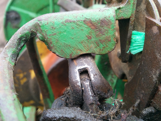

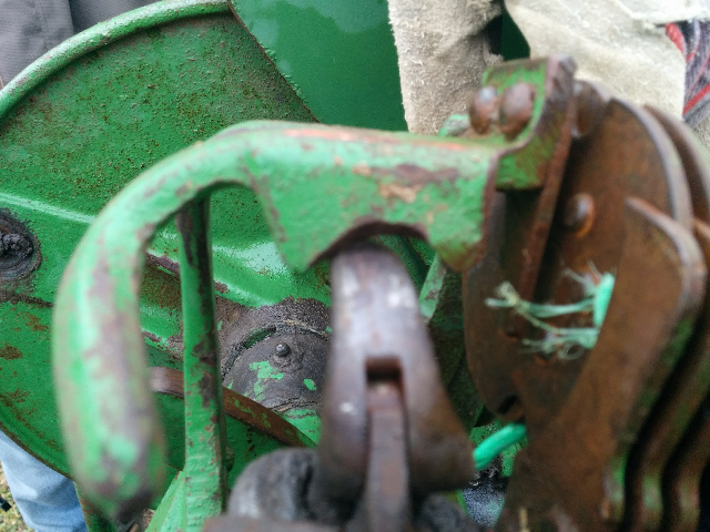

Good wiper are that does work:
Worn wiper arm that dies not work:
As an update to this post, we finally got around to working on this Baler. Comparing the wiper arms, it is very clear that the one that does not work is very worn. We took it off and brought it to a welder who is working on it right now. When he gets finished, we will put it back on and see how it works. It is expected that we will have to do a little bit of grinding to make it fit properly. In addition, washers will be put on in place of the bailing wire that was used to keep this wiper arm space properly.
I appreciate everybody's feedback and wanted to give an update so you all knew it was still being worked on.
I will update this post when the wiper arm is put back on. I will hand cycle a few times in trip the knotters manually to confirm it is fixed.

I took the wiper arm off and brought it into a welder that was local. He knew the minute I walked in with it in my hands that I had knotter issues.
After about 10 days I swing back in there and he had it all done up. I must say that I think he did about as perfect a job as possible by the looks of it. I installed it back on the baler (with new washers/shims instead of baling wire!!). I put it through a hand cycle and the know stayed like before. I am not discouraged as I feel the pressure from the bale and also the speed of the action will probably let it push off of there. As you can see from the pictures, it looks about perfect.
