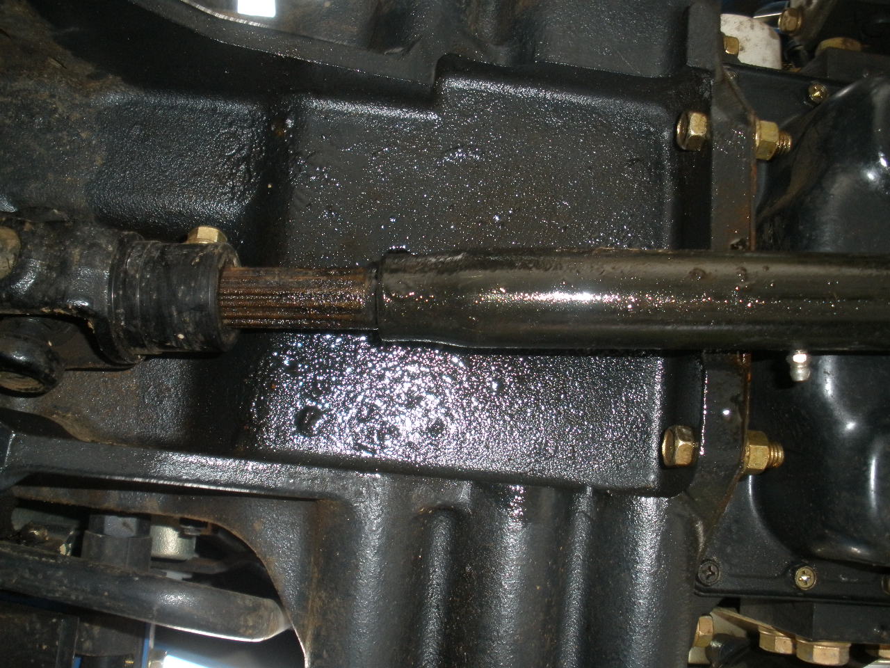

Really think I'll get all my ducks in a row before starting though. Running out of time and soon I'll just have to live with it for a few months. Looks like my issue though looking at the fluid trail, bummer. May check the torque to start off with and confirm that. Liked the Lucas additive idea also if it won't cause any issues down the road.

Ok; I had the same signs of a leaking engine/bellhousing. Do yourself a favor; remove the shrouds below steering wheel ( black two piece housing with two bolts holding halves together and a total of 4 bolts on firewall- two on each side) and check your power steering (hydaulic) valve. Mine was leaking there and made it look like a leaking internal seal.

Well, has a chance today to pull the firewall and to my dissapointment, no visible leak. :(
Did pick up some lucas hydraulic seal/conditioner that I'm going to try out first since the leak is so small (for now) I'll be putting that in after my new lines arive. I'll post what happens.

I have the same tractor, but mine is a 2005 model year. I added hyd fluid and now I have a leak same spot. I think I may have overfilled the hyd reservoir. The local dealer said about $3000.00 to replace the seal. I thought I would live with a small leak before I paid that amount.

i've put 30 hours on the thing since changing all the fluids and fixing lines etc. I added the Lucas at the time of the change. Don't know if I've run it long enough or not but the pump sounds better and the leak is more miss that hit anymore. If I relieve the pressure when it's parked there seems to be none at all. When it does, very,very little. Pretty much shows on the case but not the ground.
One thing to note though, my HST filter had blown it's guts so that may have been part of the problem. I've pulled off the new one twice and it's been fine so far. Pain to keep checking that as I need to clean it up pretty good so no dirt can get in... and it's been in the muck every time out. :)

It has worked great so far. Not instant though and took about 20 hours of use
To realize it was no longer leaking. I've added another 100 plus hard hours to it
Since and it's been fine. My guess is that it was the front trans/hydro seal. I really
Didn't want to pull it apart so I'm very happy it worked. I got it stuck in a lack over the
Weekend and left zero oil sheen! Of all things, pulling a old tractor tire I found out.
