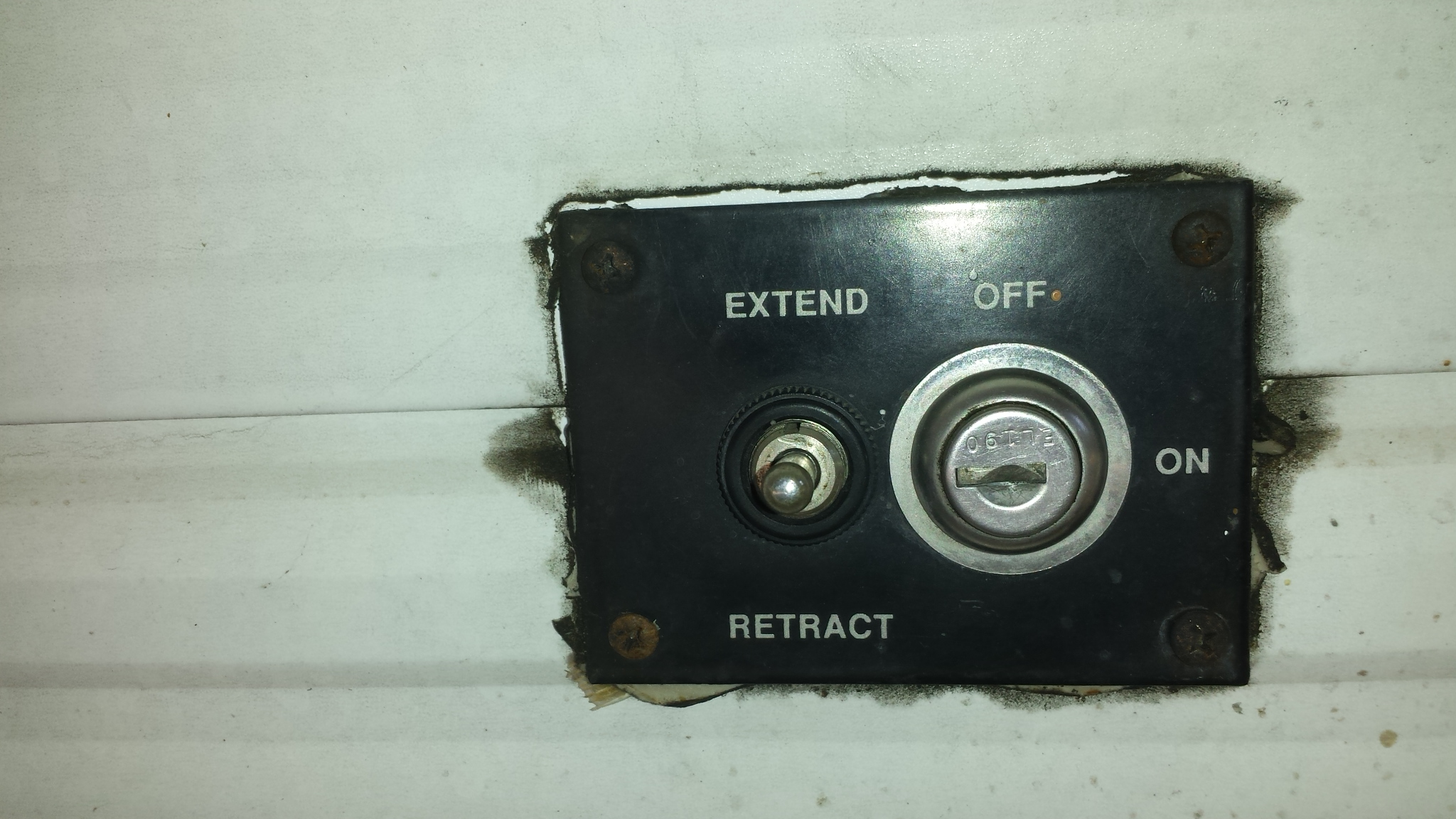

Where would you look for 5th wheel landing gear switch? My 5th wheel has the external switch on a panel, that has an extend/retract switch and a second keyed switch as a lockout.
Tried google, but only came up with single switch.
Last weekend, was all set to take the 5th wheel on a short trip. Backed up to it, went to lower it, and nothing... The switch had been intermittent before; usually jiggling it would get it to work.
Still went out; I know my manual handle that is usually stored, works...

   / Where would you look for 5th wheel landing gear switch?
#9
Here is the panel. I have power to the switch.
   / Where would you look for 5th wheel landing gear switch? #10
If you have power to the switch, all you need to do is replace switch with a radio shack double pole toggle switch. Those ore on off on switches. Any electrical supply house will also sell them.

Finally... got time to look closer at this.
Bad ground...!
Cleaned up a couple of the ground connections, and it works like a charm. Funny thing is, only thing affected was the front jacks...
I checked the switch voltages with a volt meter; got 12V. Checked with a test light, no light. Checked from chassis ground; 3.6k ohm...
   / Where would you look for 5th wheel landing gear switch? #12
I'd get a rubber boot on that switch, ASAP...
