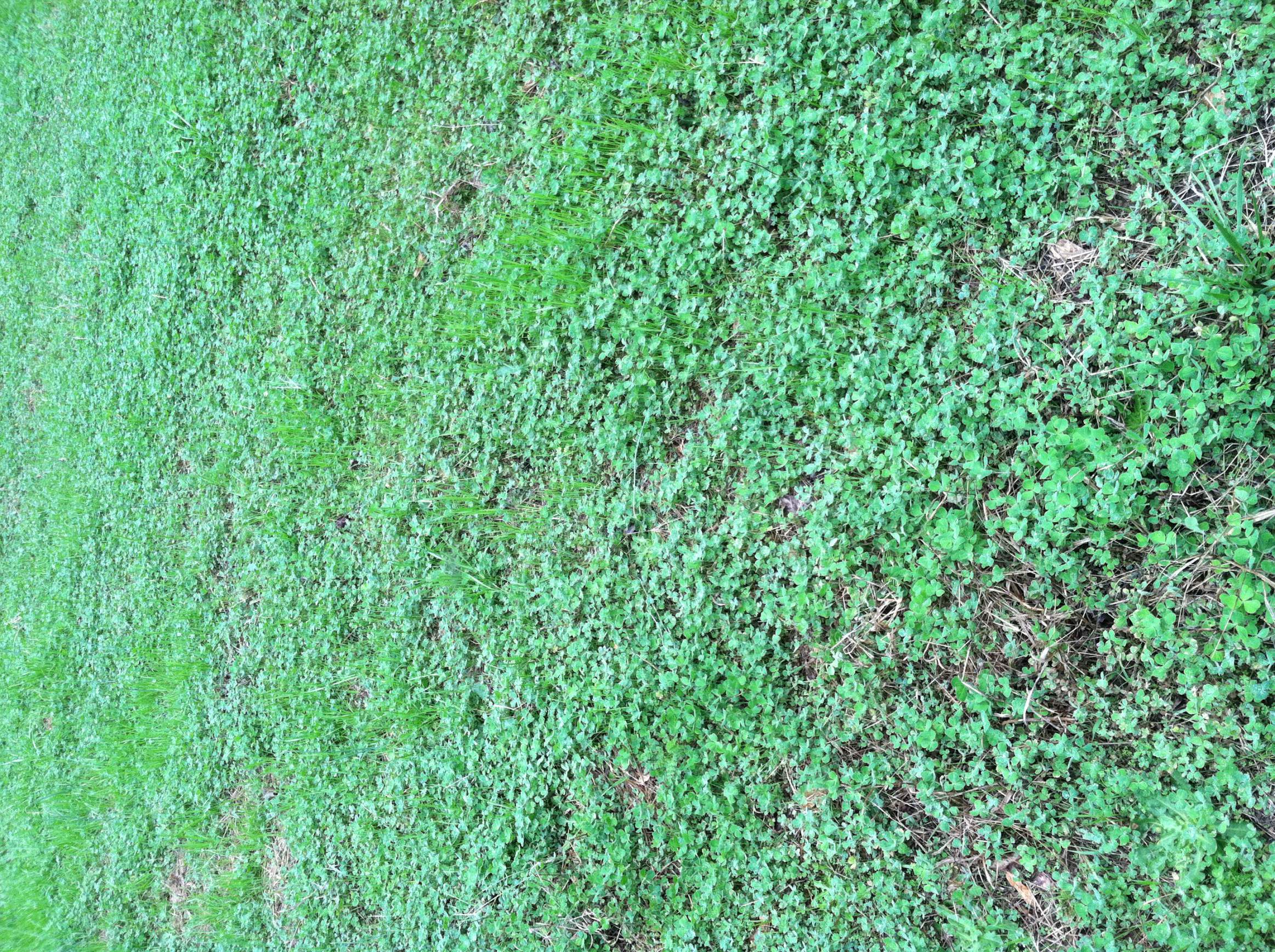

I am new to no tilling (recently restored a 3 row planter and got a Truax no til drill). I was planning to plant some soybeans and corn this spring, whereas in the past, we always planted fall blends. I checked out our plots and they are beautiful now. The spring rains have really brought out the clover. They are lush. But I assume the grasses and weeds are waiting to emerge.
My question is whether to apply Roundup before I plant. I could (and am tempted) to just plant as is, with no herbicide. There is no old residue and the clover in only 4 or 5 inches high. I hate to kill this clover. What would happen if I drilled corn and beans now without any chemicals?
I also wondered if maybe I should use something other than roundup. I read that Poast will kill grasses but not clover. I have never used any herbicide before.
I will post some pictures of the plots tomorrow.

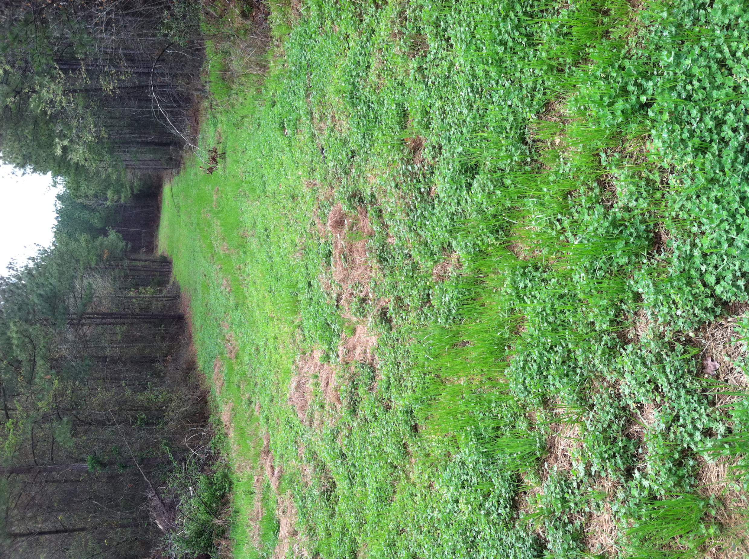

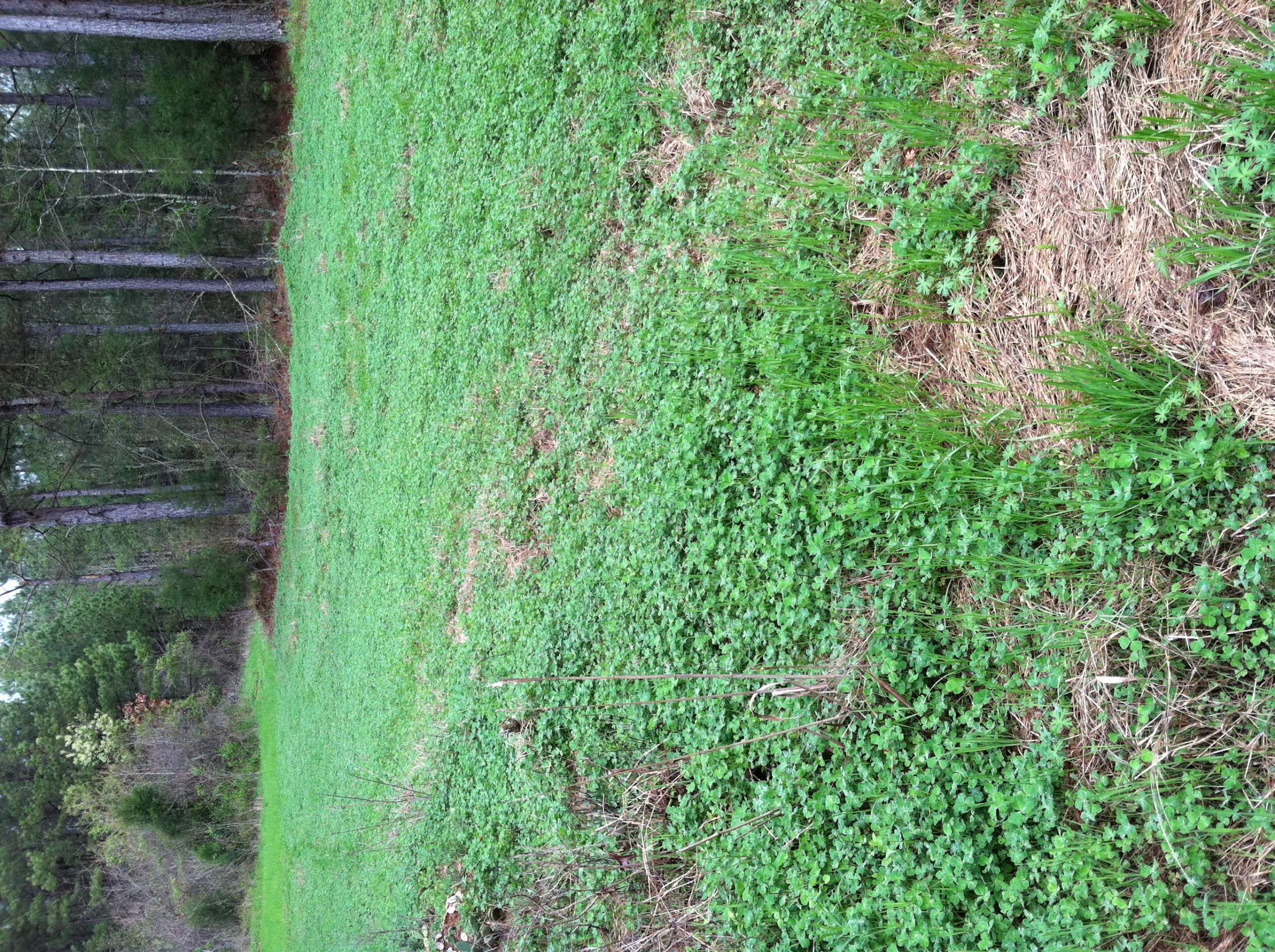

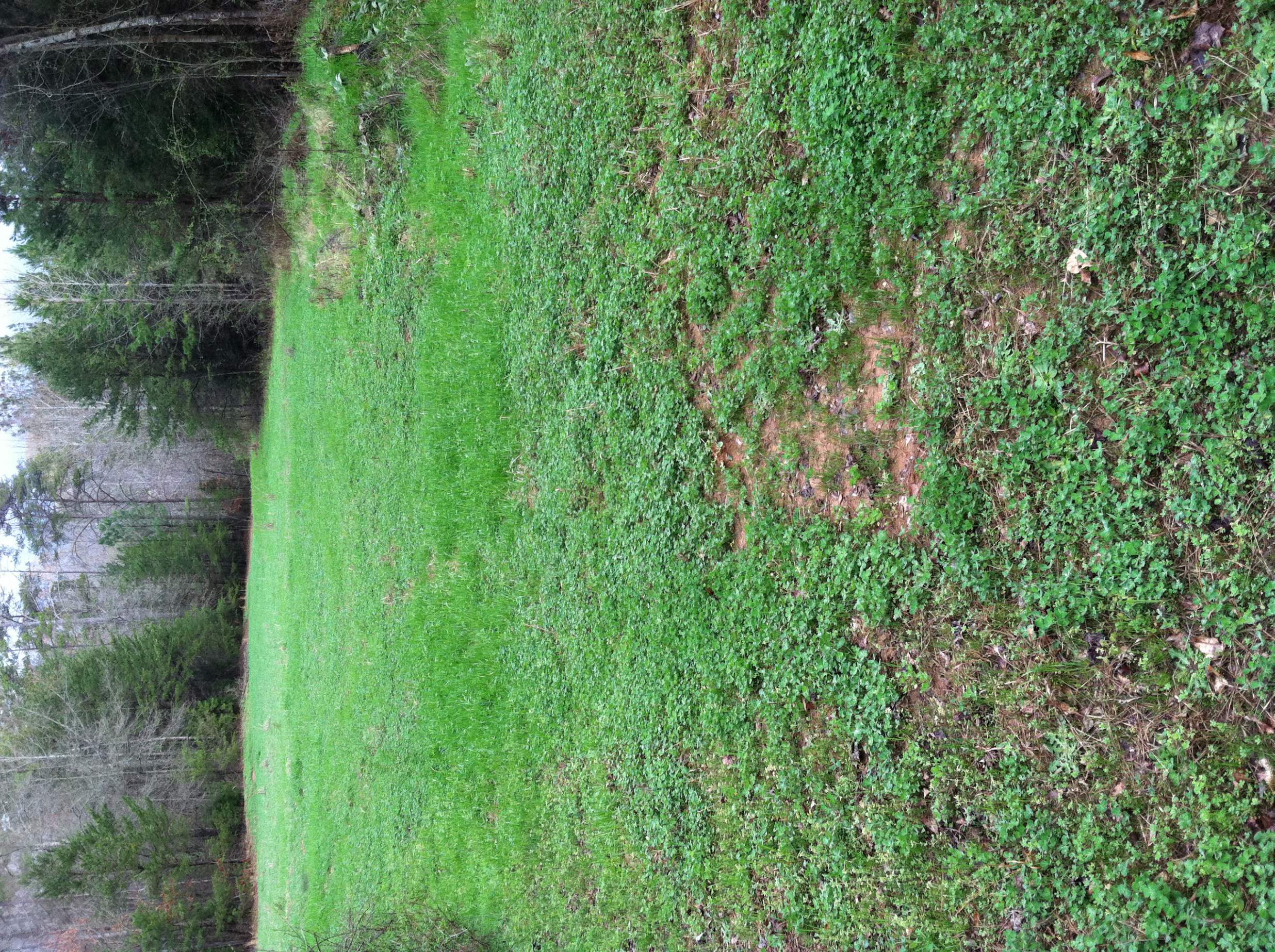

That's the heart of the question I am asking. Will the existing clover and whatever else present, even though not very high, prevent the growth of corn or beans if not killed first? So do most agree that it needs to be killed first before drilling? Here are some pictures of the plots. So drilling through this stand of clover and grasses is a waste of time unless all is burned down?
Sorry the pix are rotated. They were correct on my computer. Can't figure out how to rotate them after I downloaded them to TBN.

Looks like this is some form of white clover. Clovers can be hard to kill with just Gly. If you use Gly 41% at 2 qt per acre (or Round Up) it will kill most of the weeds and some of the clover but the clover may start regrowing after a period of time. There is lots of info out there about using a reduced rate of Gly on clovers to control weeds following an author's advise by the name of Ed Spinoza, or something like that. I would caution against following this type of information because it goes against the recommended dose by the Mfg which can lead to very serious problems such as resistant weeds.
Beans and Corn do not like competition. anything growing is competition to corn or beans.
There is a method that involves applying non-selective herbicide in 10-12 inch wide strips and planting into the strips. The strips will slowly fill back in but the crop will be big enough by that time that competition would be a moot point. This is one possibility.
As far as drilling beans you will have to burndown the total area due to the row spacing of most drills (7.5 inches).
Yes, you should kill (spray) the existing vegetation first to give the corn
or beans a chance. Just remember, this is a food plot. You are not trying
to grow 300 bushel corn or 70 bushel beans. So if it doesn't look so good
in the middle of summer, being your first spring planting, just learn from it
and try again. If there are weeds or clover still growning, a mix of vegetation
works well for a food plot.

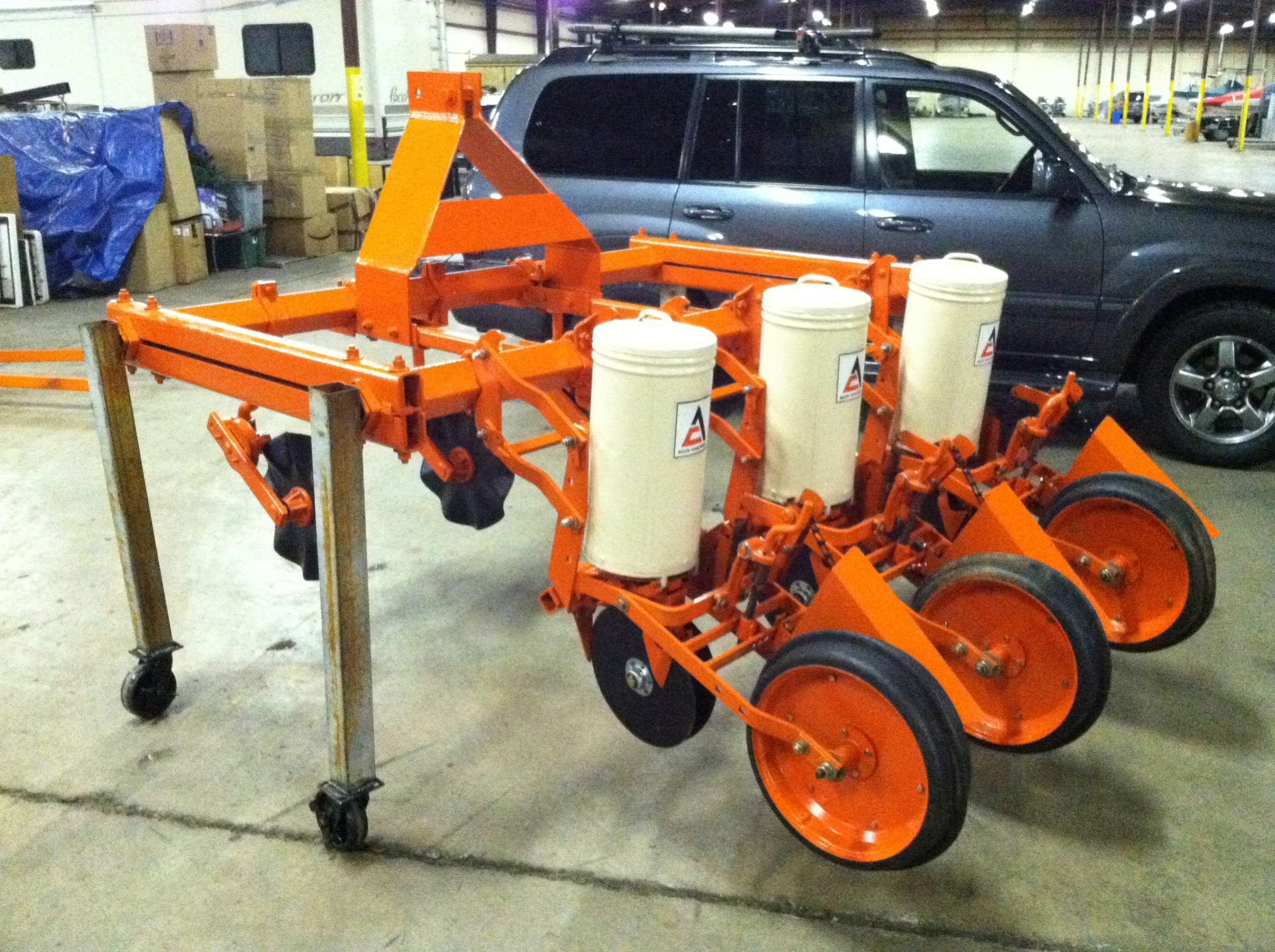

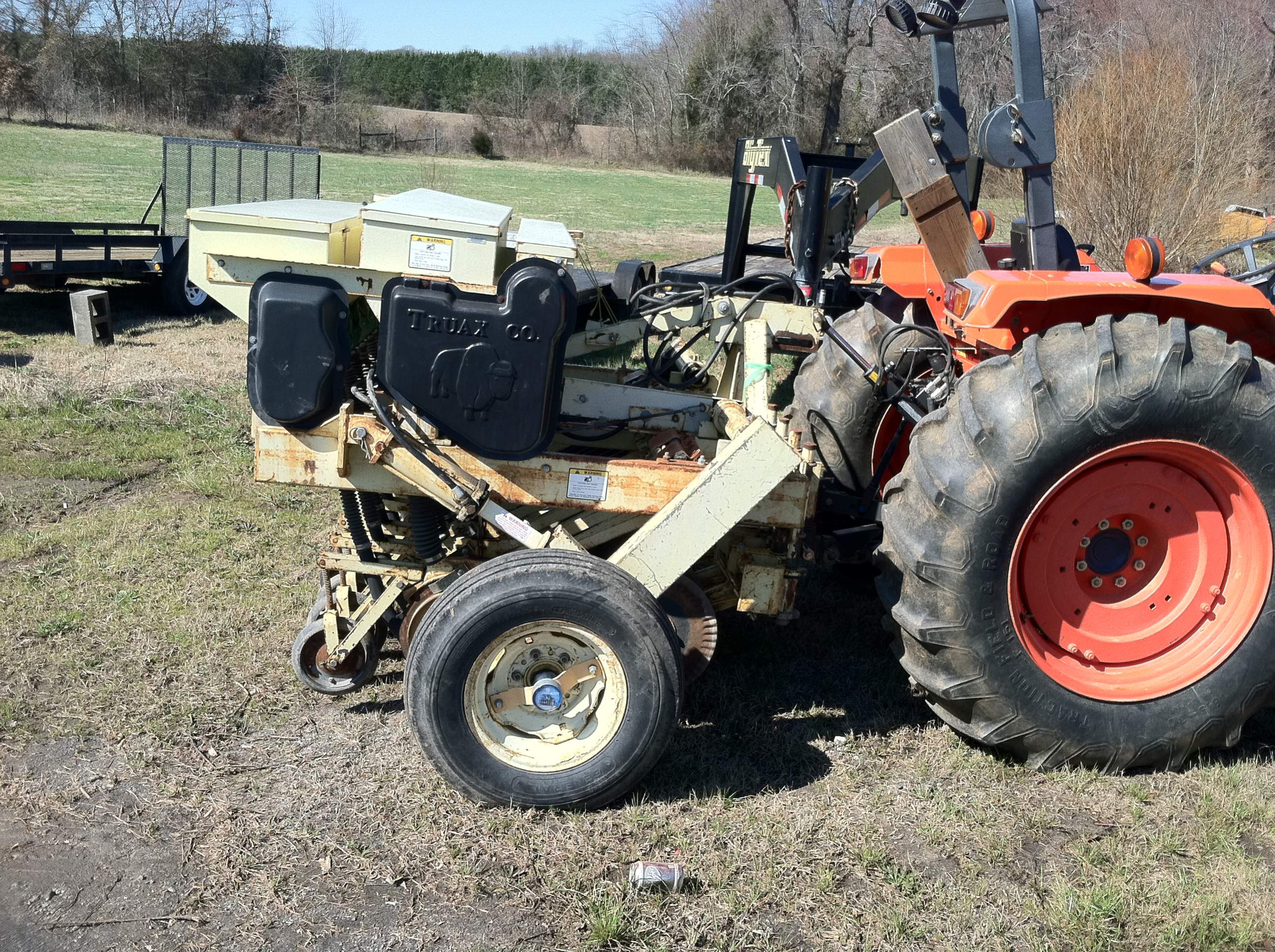

Should I plant the beans and corn about 1" deep? I can't wait to try out my new Truax and the Allis Chalmers planter I restored this winter. We always planted in the Fall, but with the recent droughts, it was always hard to get enough moisture to have success in Oct and Nov. Hopefully by not plowing we can conserve moisture and also supplement Fall planting with some Spring crops.
With these two pieces of equipment and 20 or so plots to experiment with, what would you guys do?

I'd spray it one weekend and drill it the next. You could do it the same day if you wanted.
I'd go a little deeper on the corn if you are planting them separate, 1.5-2". The beans will work just fine at 1".
If you need to split the difference to plant them together, no more than 1.25" deep because the beans do not like to go deeper.
