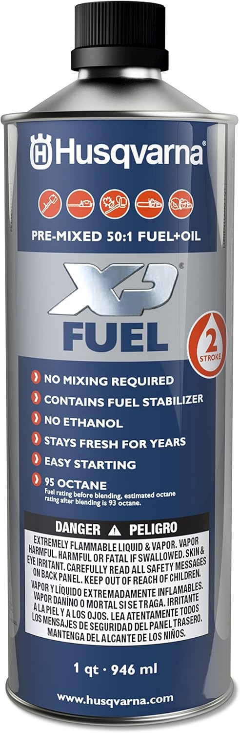

I had a couple of old saws that became hard starters. I had good results switching from ethanol gas to Tru Fuel. I start the old saws with the synthetic fuel and once warmed up, switch to ethanol free 93 octane gas. Before storing, I switch back to synthetic fuel.
It's worked well in my old Craftsman, and Husky saws.
   / Older Stihl getting hard to start #9
I stopped with mix almost completely. I only run Trufuel in the newer saws. I still run mix in weed wackers.
   / Older Stihl getting hard to start #10
When I bought my Husqvarna 460 Rancher saw last year, there was an offer from the manufacturer to extend the warranty by one year if I purchased 4 quarts of their brand of synthetic fuel mix.
I guess it was like an extended warranty in a way, but I use synthetic fuel anyway so I took the offer.
