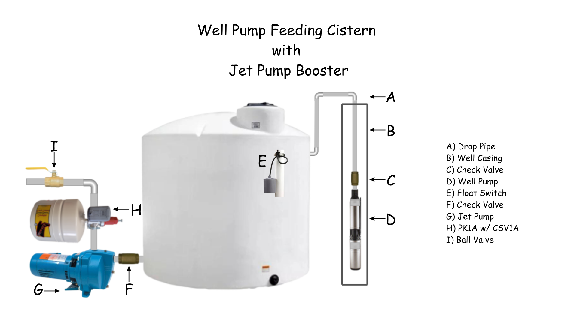

Very interesting idea, and it will work. The reason the pool water is better is because it has time to off-gas as you say, and lets the sediment settle to the bottom. You could do the same thing with say a 1000 gallon cistern, and then the water wouldn't get peed in. Check the acidity of the water as that seems to be the problem with copper pipes. I would first try to develop the well by pumping it hard for hours or days if needed to get the sediment out. Just cycling on and off into a pressure tank is not enough volume to clean out the well, and many wells have never, ever been developed.
