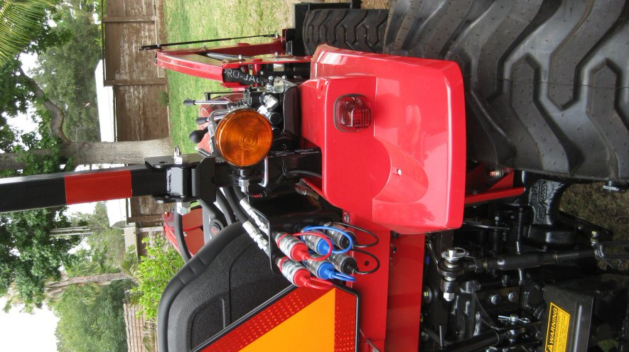

Hi Everyone, I'm going to look a 2015 1533HST and was wondering about the three point lift arms. Are they adjusted link arms are fixed? Also how about adding rear remotes. Are there kits with two sets available?

There is a single rear remote with the float feature available, it is stupid expensive though. :shocked: You will need to go after market to get multiple sets. Something like what is pictured.
As far as the 3pt hitch, the anti-sway links are the sliding pinned in place type, but the draft links do not have extendable ends on them.
The new 1600 series (equivalent machine) has extendable draft links, but I would hate to think of the cost. :eek: Probably fit right along with the costs of the single rear remote. :confused3:
You might want to consider some sort of quick hitch be it a full 3pt quick hitch, Pat's quick hitch or the Euro type quick hitch.
Good luck. ;)
